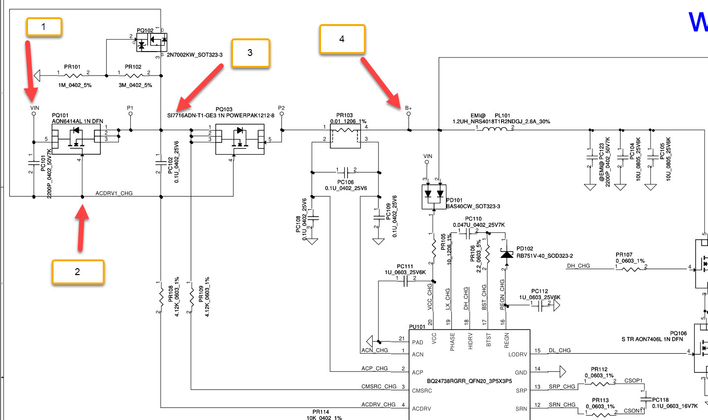

    HP LAPTOP NO POWER, BUT WHILE PLUG CHARGER I GET WHITE LED AND WHEN I PLUG BATTERY I CAN GET AMBER LIGHT ALSO
    AFTER MEASURMENTS VOLTAGE & DIODE MODE ON PU301 AND PUM1 I GET THE FOLLOWING VALUES:

    • mon2
      • Dec 2019
      • 14662
      Re: Hp zs050 la-a994p rev:2.0
      Hi. Remove all power / remove battery.
      Meter in DC volts mode (20V is ok).
      Then attach external adapter and check the voltages for the attached locations.
      Post the readings.
