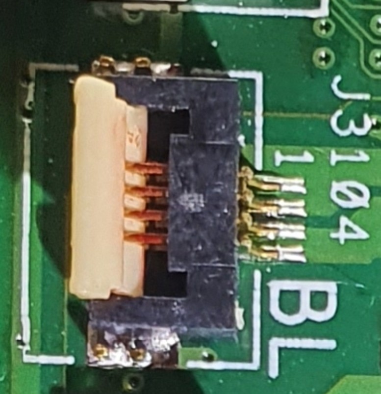

    Helo, I can't find this connector (lever is broken), it's a very thin connector, I saw on Ali (all are 1mm too wide), Ebay and the wab, I can't find the same and I can't find an equivalent (same dimensions and another system). Do you knwo where I can find it pls ?

    looks like 0.5mm 4pin
    https://www.aliexpress.com/item/1005...rch-mainSearch
    u dont need use same type. just same pitch and pins

      Those pads are plenty large enough to loose 0.5mm each side, the external dimensions (which you haven't included) aren't important. It's the pitch of the contacts and whether they are top or bottom that I pay attention too.

        I have one, I just tryed and the pins space is the same and contacts inside are below too, that should works. It is very biggest, it fit exactly in white frame drawed on the board. Double size compared to original. Thanks.
        If you know if it’s possible to find the original, I keep interested because that should be usual for tablets I guess.
