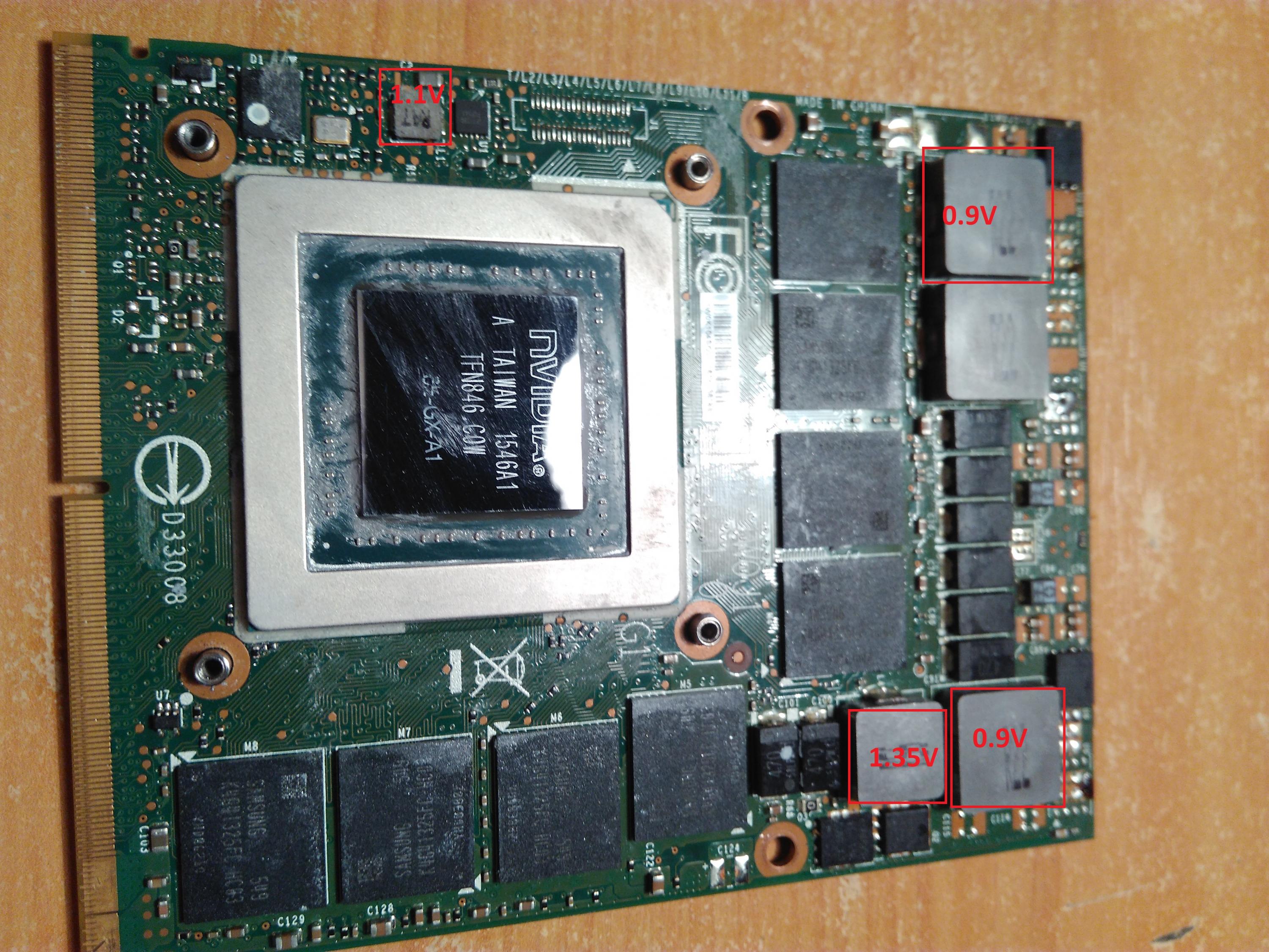

    have this MXM GPU 970M that not work after GPU phase short. i removed mosfet to remove short and let it work on two of three phases. card is detected and windows want to instal drivers, but when chceck in GPU-z or HWinfo it shows weird readings.
    What else can be bad when have woltages on all coils.
    any hint what to check?

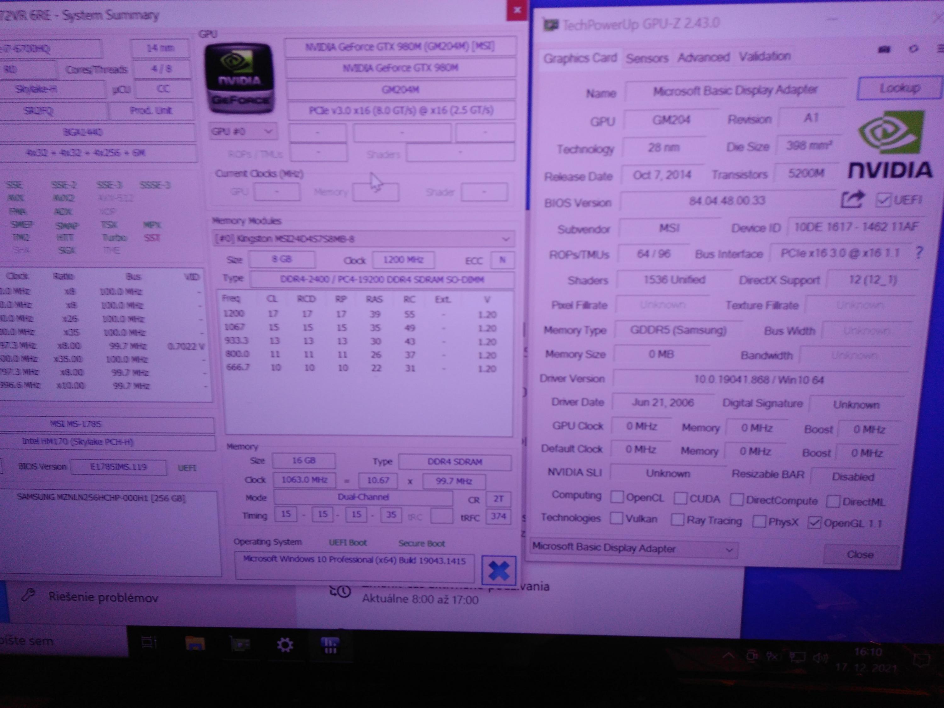

      i try to flash bios from "https://www.techpowerup.com/vgabios/?did=10DE-13D8-10DE-110C" but it not help

        but you have no drivers installed, problems with driver install?
        sure it's 970M? part number is a bit scratched, but gx-a1 shows as 980

          can be as it is scracched i did not know
