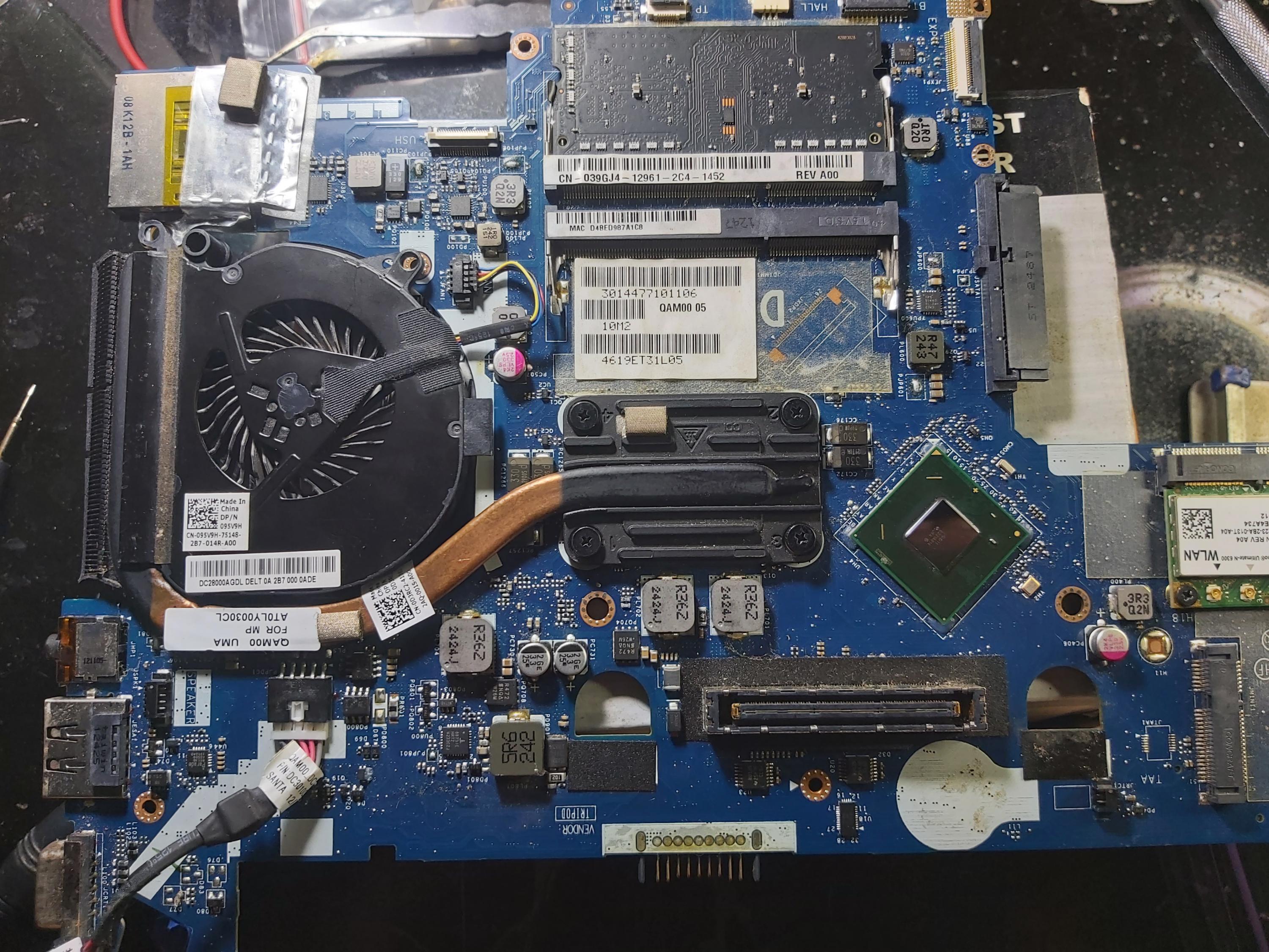

    Hi my friends, I hope someone can spare a minute to help me troubleshoot a dell latitude e6230 (la-7731p rev 1.0) motherboard where the engine starts 5 seconds then turns off again and doesn't show anything on the screen.
    thank you very much if anyone can help me with this problem.

      Thank you for taking your time to reply to this post, unfortunately this motherboard came with the condition already detached from the casing and there are no other components besides ram and HSF, I have tried it with new ram but the result is still the same. and i can't find the skematik for this board revision

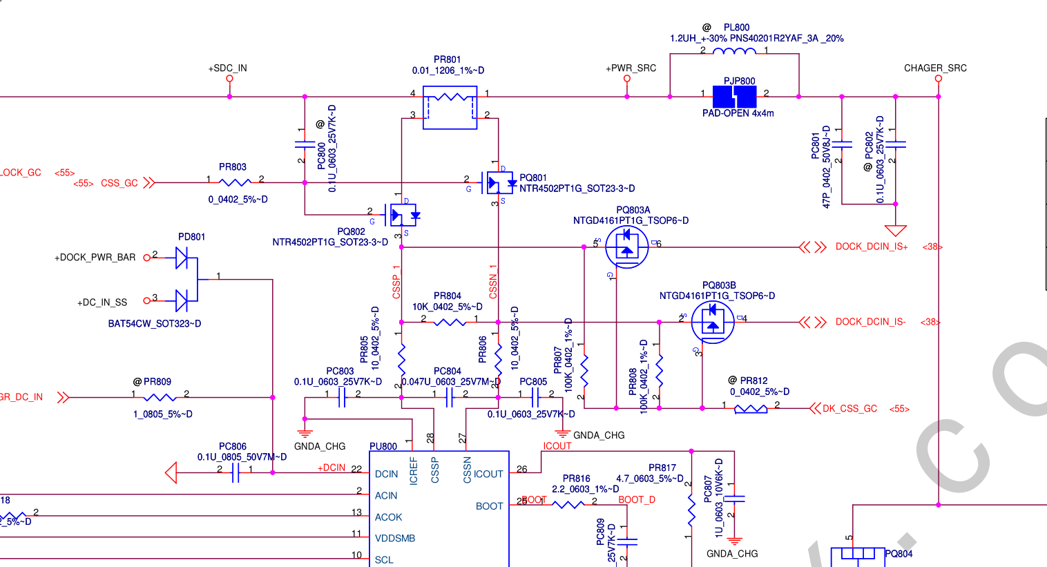

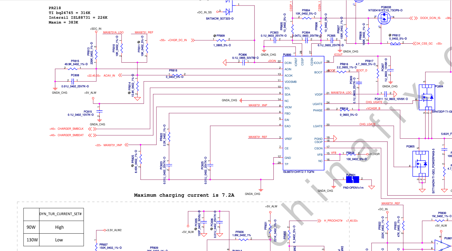

        1) Remove all power. Meter in resistance mode (2k). Check the resistance to ground for each coil. Looking for any very low resistance values which may note a shorted capacitor which is causing the power supply rail to shut down, for safety reasons.
        Post any low resistance values. Some rails may be normal, even with the low resistance reading.

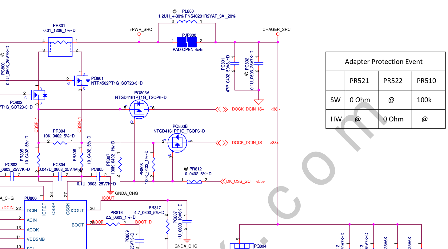

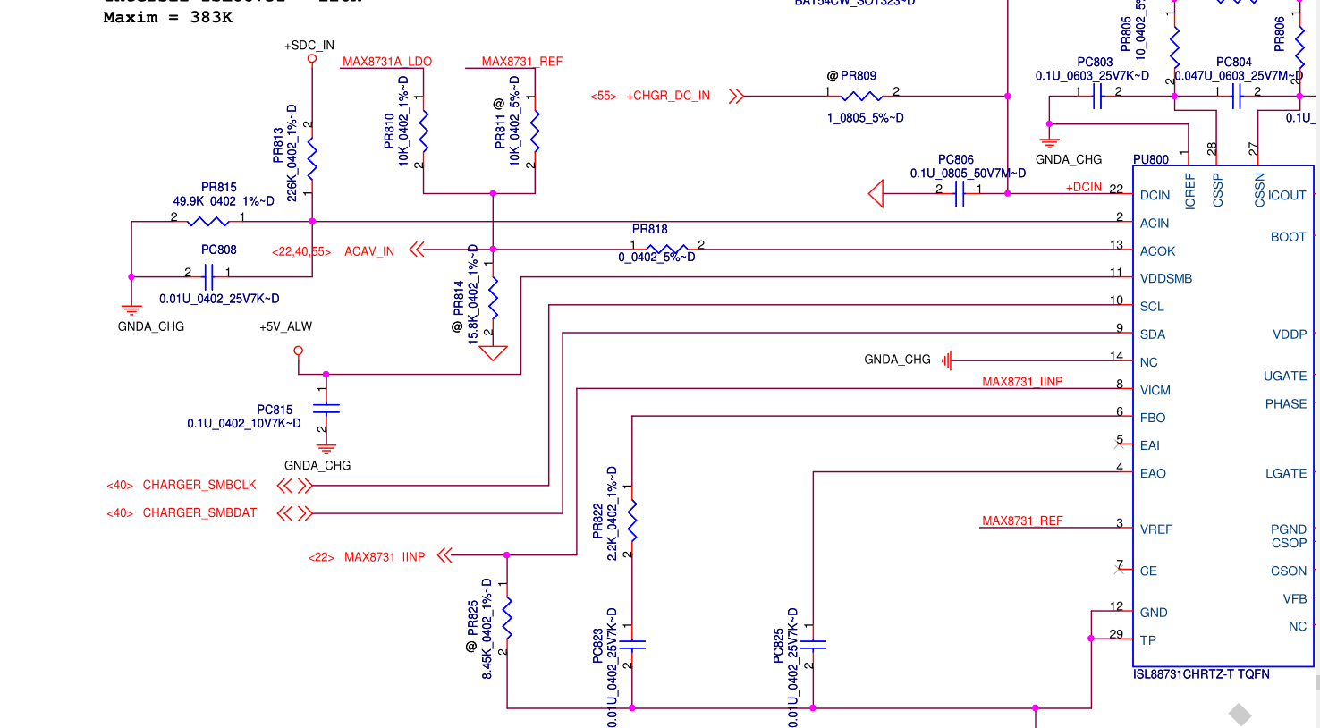

        2) Found the schematic in my paid service - encrypted of course but see the attached charger portion.
        Check and post the voltage readings for what you can read when the power rail is on. Start with the left side of the charger circuit.
        When the logic board turns off, do you see voltages at the first mosfet ? How far does the voltage travel ?
        Expecting to hear that the DCIN adapter voltage is still present, whether ON or OFF.

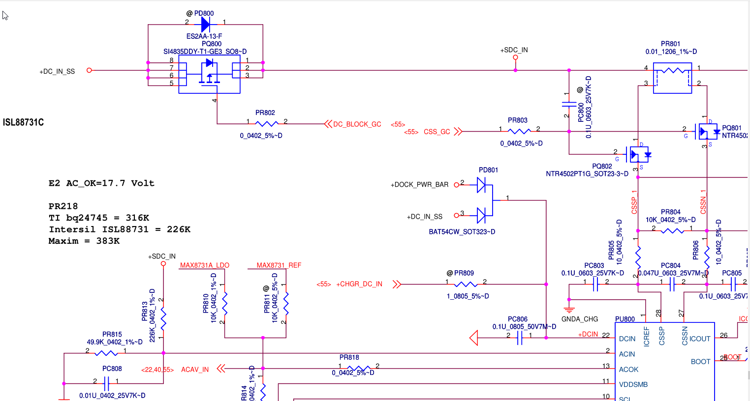

              Do not see the mosfet voltage readings. Please see and post the attached voltage readings for these points.
                Re: DELL LAITITUDE E6230 turn on only 5 seconds
                Thank you for taking a little of your time
                PQ800
                PIN 8,7,6,5=19V
                PIN 4=0V
                PIN 1,2,3=19V
                PD801 PIN 1=19V
                PU800
                AC IN=3.43V
                AC OK=3.09

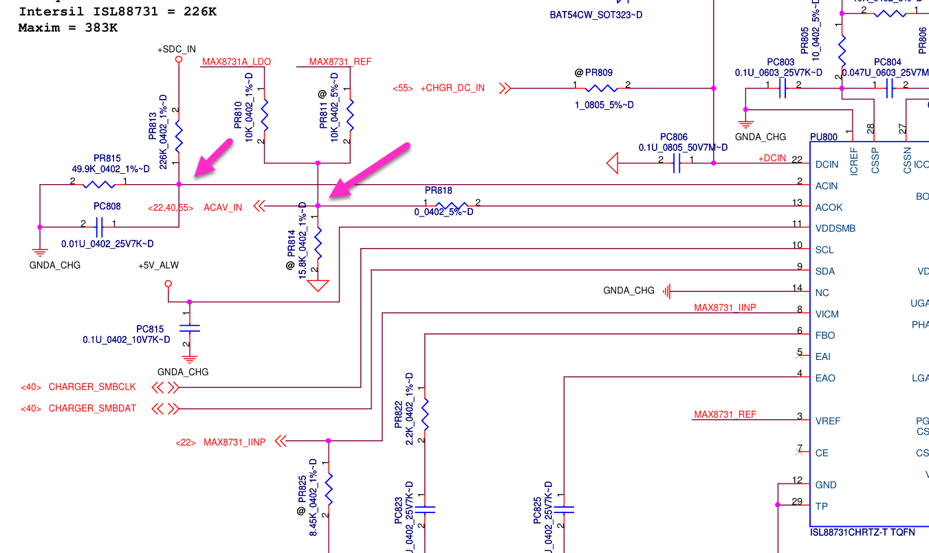

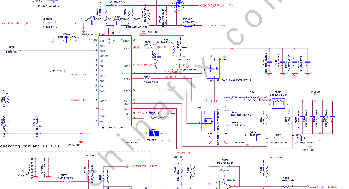

                  These look like good voltage readings.
                  See attached.

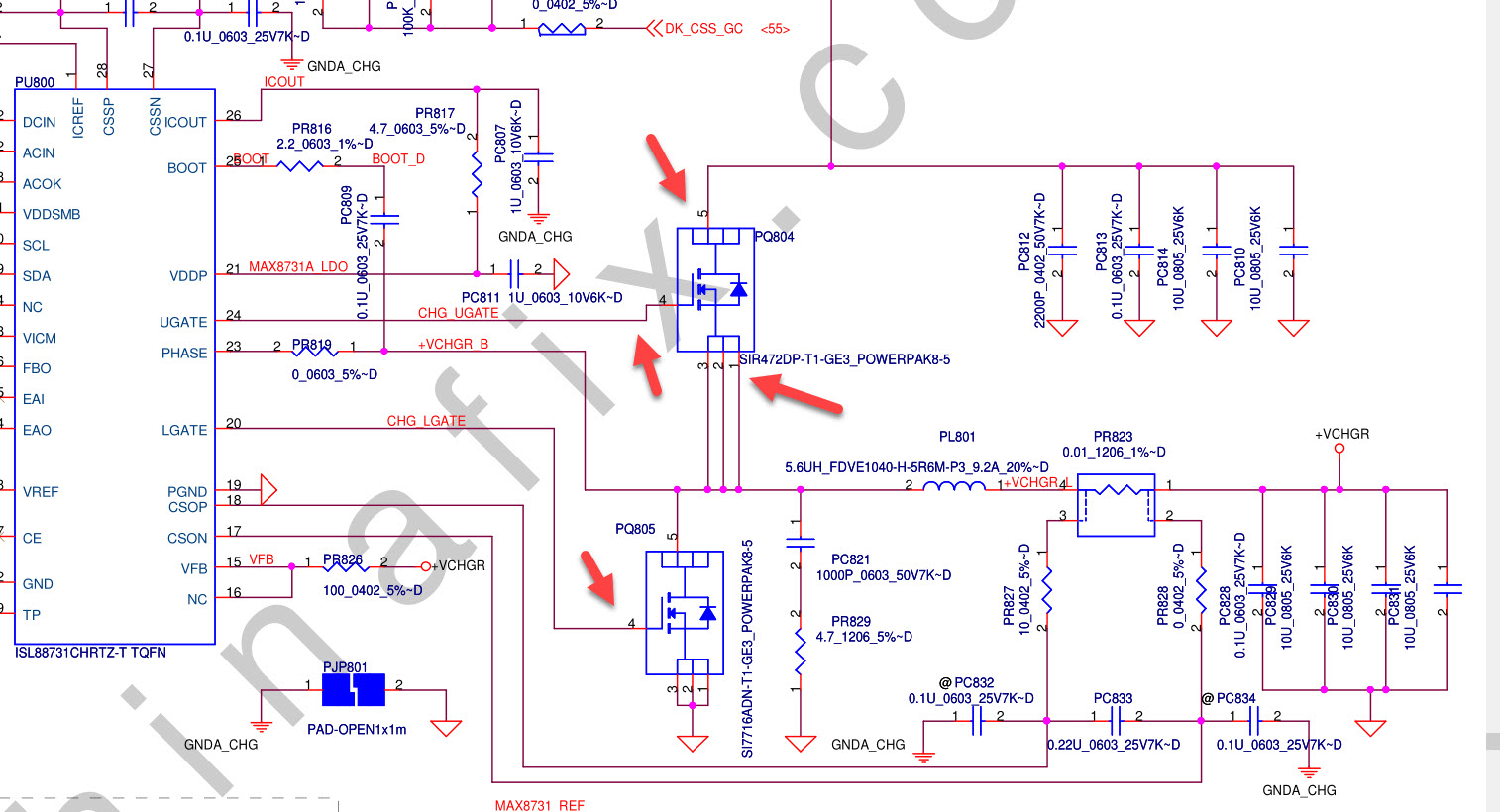

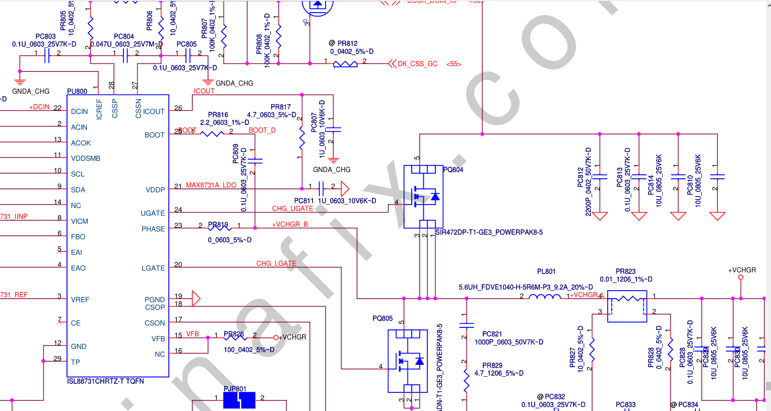

                  Measure & post the voltages for the high and low side mosfets for the switching power supply.
                  Measure first without battery, then with battery.
                    See attached.
                    This is for measurement without battery, because I received this mobo without battery too
                    PQ804
                    Pins 1.2.3=0.08v
                    Pins 4=0.10v
                    Pin 5.6.7.8=19.61v
                    PQ805
                    Pins 1.2.3=0v
                    Pins 4=0v
                    Pin 5.6.7.8=0.11v
                      Pin 5.6.7.8=19.61v
                      Do you see this ~19V remain on after the 5 seconds ? Or does this rail also turn OFF after 5 seconds ?

                        no bro, this 19v voltage is still there even though the engine is 5 seconds off
