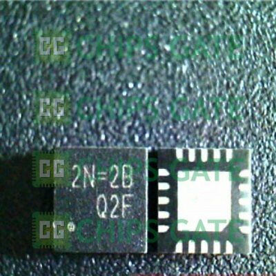

    Chip ID 2N 3D R2P Asus X556
    The board exhibits no power, but draws 200mA. The input MOSFETs are fine but the above device gets hot and I note that 3.3V is only 0.6V.
    There is a short on the R2P IC, as a cap is showing short in circuit and is fine out of it, whilst the short is still present.
    I assume it's some sort of regulator but I cannot work it out and without a SCH I'm a bit lost.
    TIA

    Post a picture of the IC. If its 2N= its a richtek part

      If the ic looks like this one it is a Richtek RT8249CGQW
      2N=YM
      DNN

        That's the one! Thanks a million
