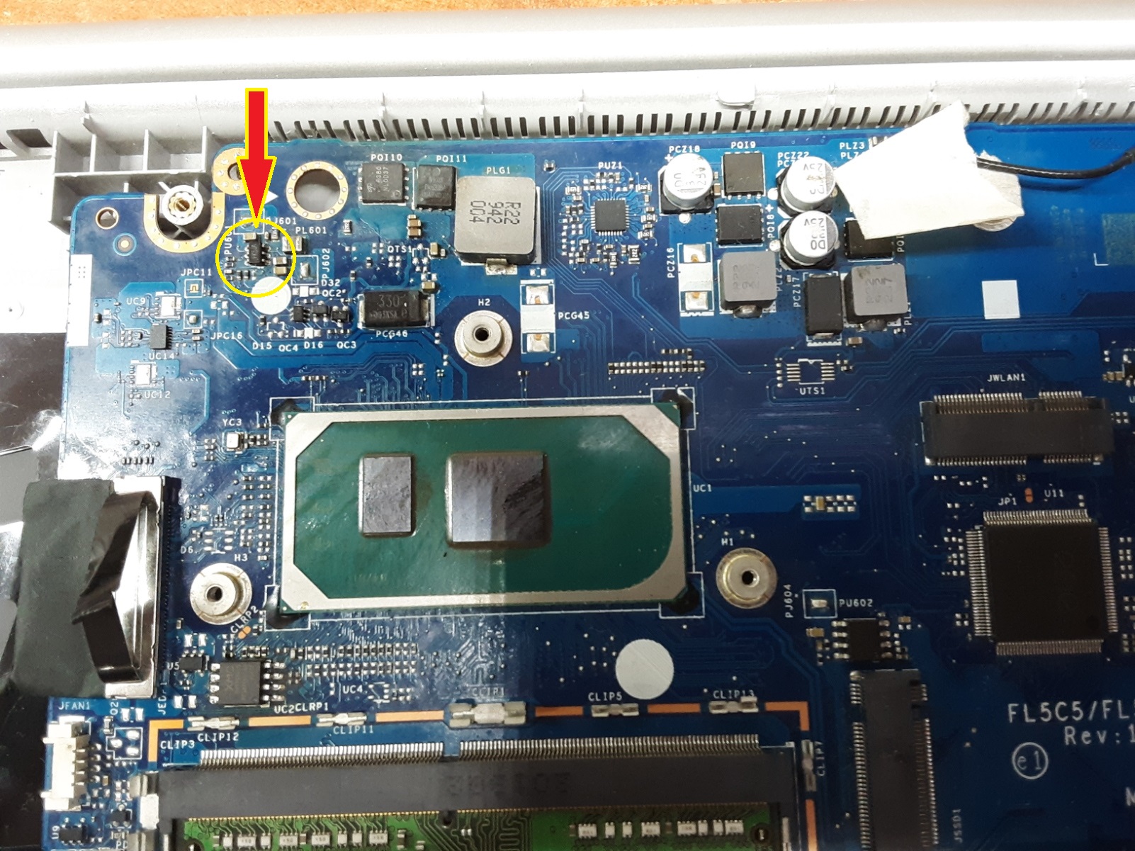

Lenovo s340 15IIL FL5C5/FL535/FL435 LA-H103P REV 1.0
  • skazide
    • Jul 2015
    • 142
    • morocco

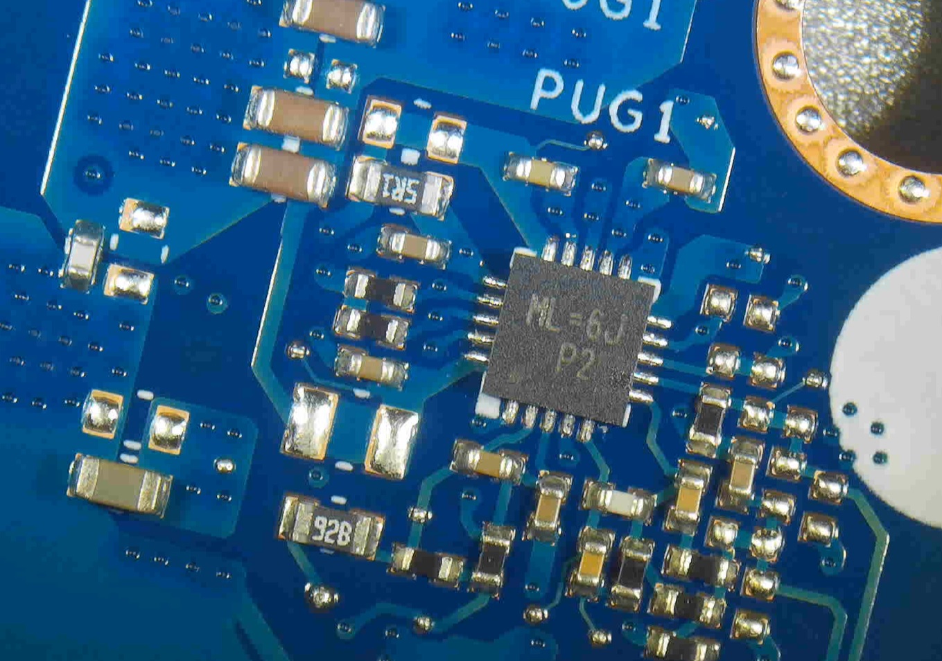

    plz i need to know this ic

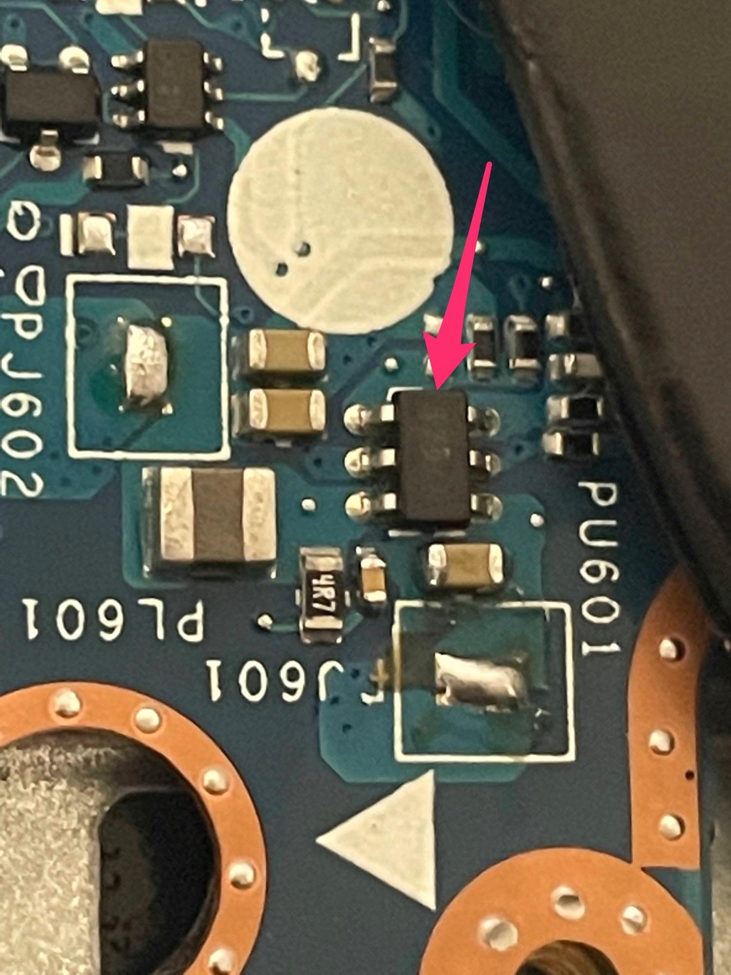

        • alejdq
          • Jul 2020
          • 5
          • colombia
          Re: Lenovo s340 15IIL FL5C5/FL535/FL435 LA-H103P REV 1.0

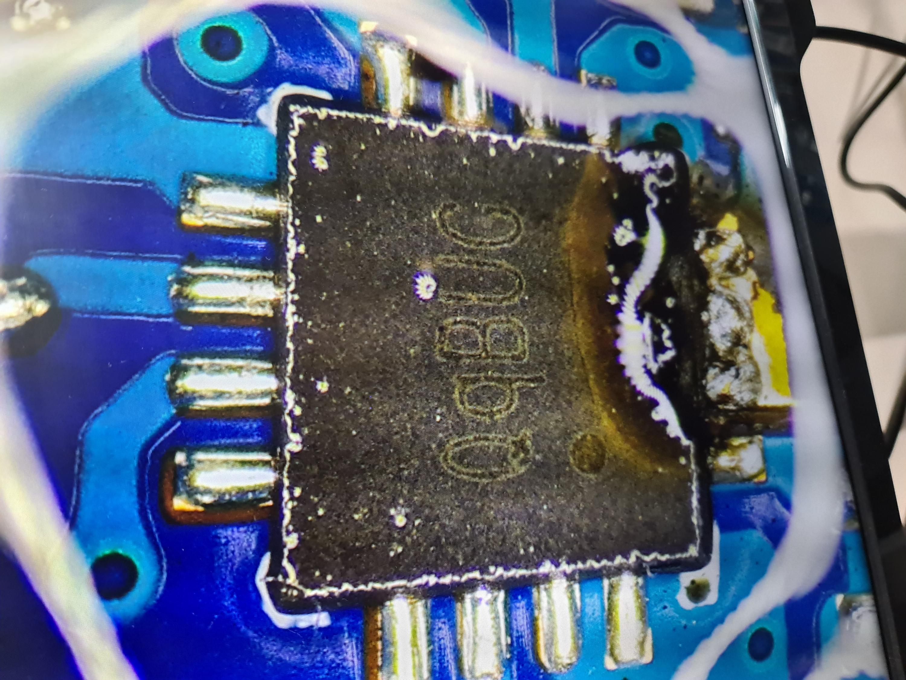

          please i need the reference of this ic
            • 20952
            The picture is too blurred,you need to read the marking code.
            If the first two letters are Qq it might be a silergy SY8386BRHC
            https://www.badcaps.net/forum/showpo...1&postcount=12
            Qq*** SY8386BRHC - N/D (EL432 EL532 LA-H131P)

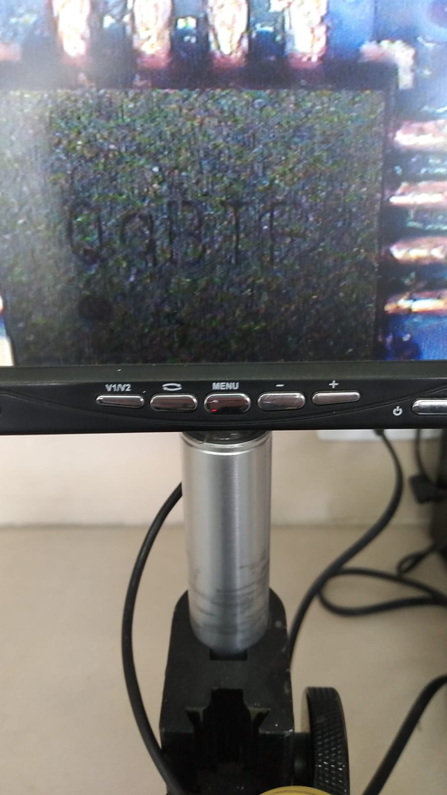

              this is the reference written in the ic "QqBTF". Does anyone know what the market reference is?
              • mon2
                • Dec 2019
                • 14220
                Courtesy of the thread above with the SMD markings.

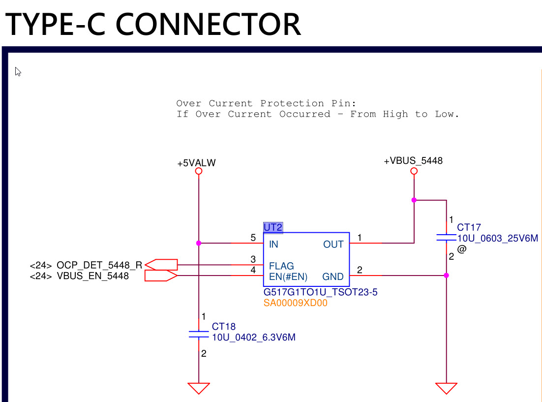

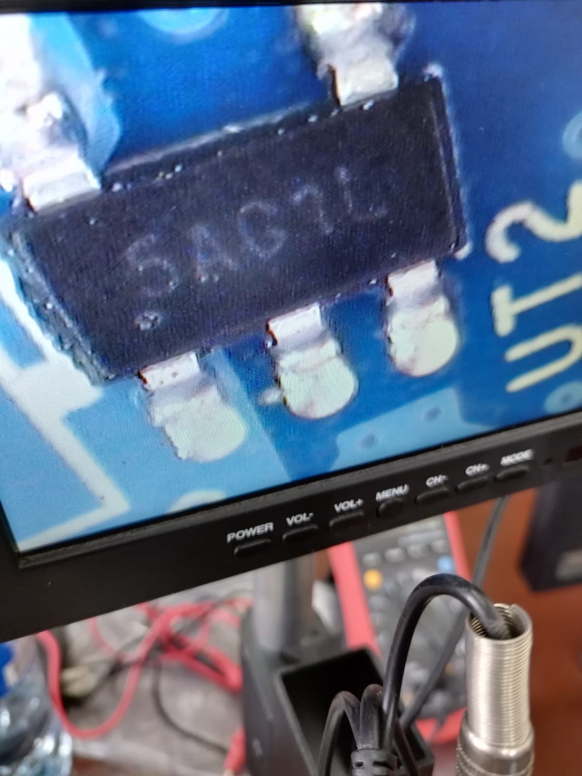

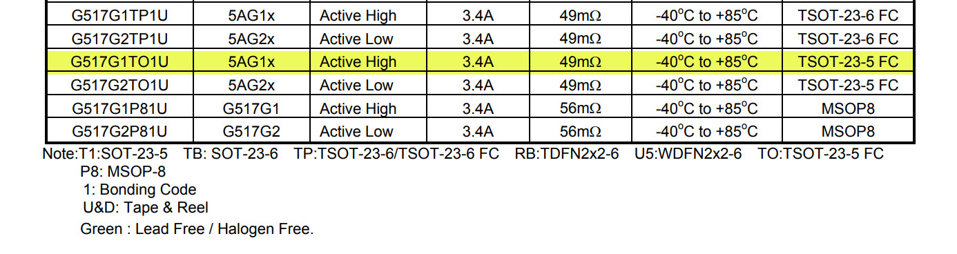

                  good morning, can you please help me with the reference of this IC of the same board 5AG1L
                  • mon2
                    • Dec 2019
                    • 14220
                    See attached = UT2 helped.
                    This is a common USB Load Switch.
                    p/n G517G1TO1U
                    Aliexpress will have these but you should be able to replace with many others available from Mouser / Digikey / Arrow, etc.
                    Be sure to check the polarity of the ENABLE pin = ACTIVE HIGH to match your device.
                    The following will work as a drop in replacement:
                    https://www.arrow.com/en/products/ap...s-incorporated
                    * this component can support upto 3.2A peak

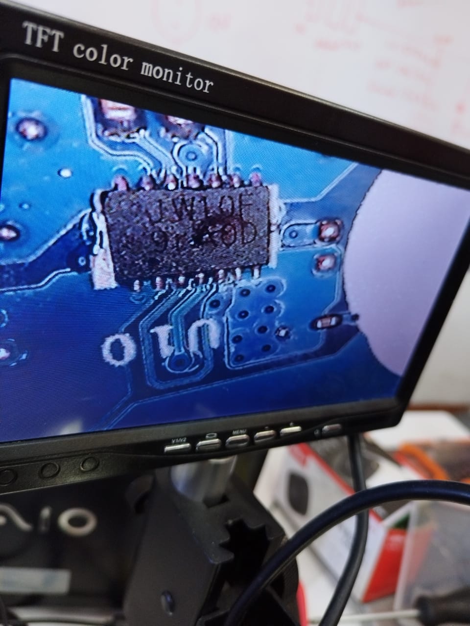

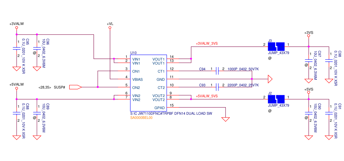

                      please i need the reference of this ic. JW10F
                      • mon2
                        • Dec 2019
                        • 14220
                        p/n JW7110DFNC
                        you can buy them from Aliexpress:
                        https://www.aliexpress.com/af/JW7110...psort=1&page=1
                        attached is an example schematic taken from another logic board that uses this IC.

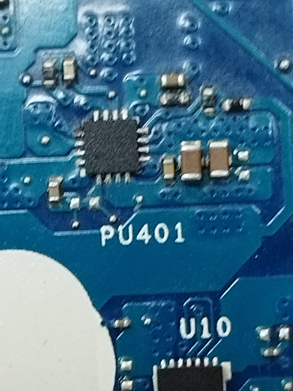

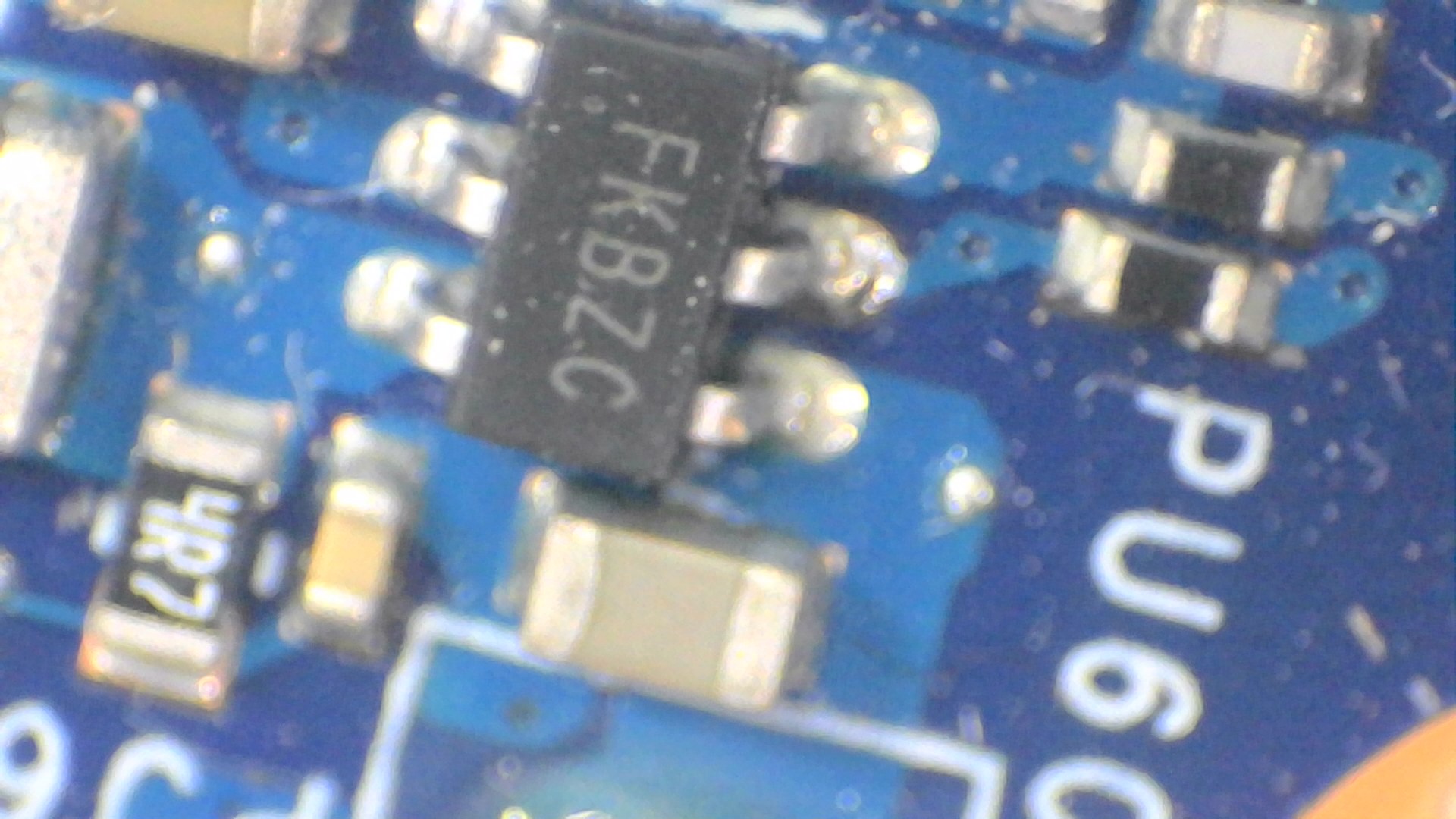

                          ID IC FKBZC <main board> LA-H103P lenovo
                          Hi, can you help me identify this integrated circuit? belonging to a mother board lenovo FL5C5/FL535/FL435 LA-H103P, attached images, thanks
                          • mon2
                            • Dec 2019
                            • 14220
                            Hi. Package is sot23-6.
                            Part is from Silergy SY8032ABC
                            Markings of 'FK' are used to identify this part.
                            US $2.50 | 5pcs/lot New SY8032ABC SY8032A SY8032 FK2EA FK4SC SOT23-6 Chipset
                            https://a.aliexpress.com/_mt6KnEa
                            Do confirm your markings with any vendor before purchasing but the above device looks suitable.

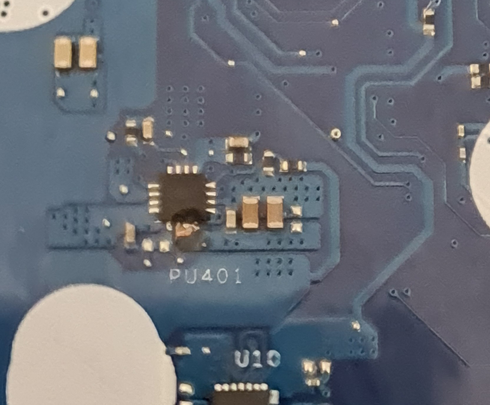

                                Hi, could someone help me with this? What is it
                                Thank you in advance
                                • lucian6464
                                  • Feb 2021
                                  • 9
                                  Just bought theese, please correct me if i done mistake
                                  • mon2
                                    • Dec 2019
                                    • 14220
                                    Hi. It is the correct part.
