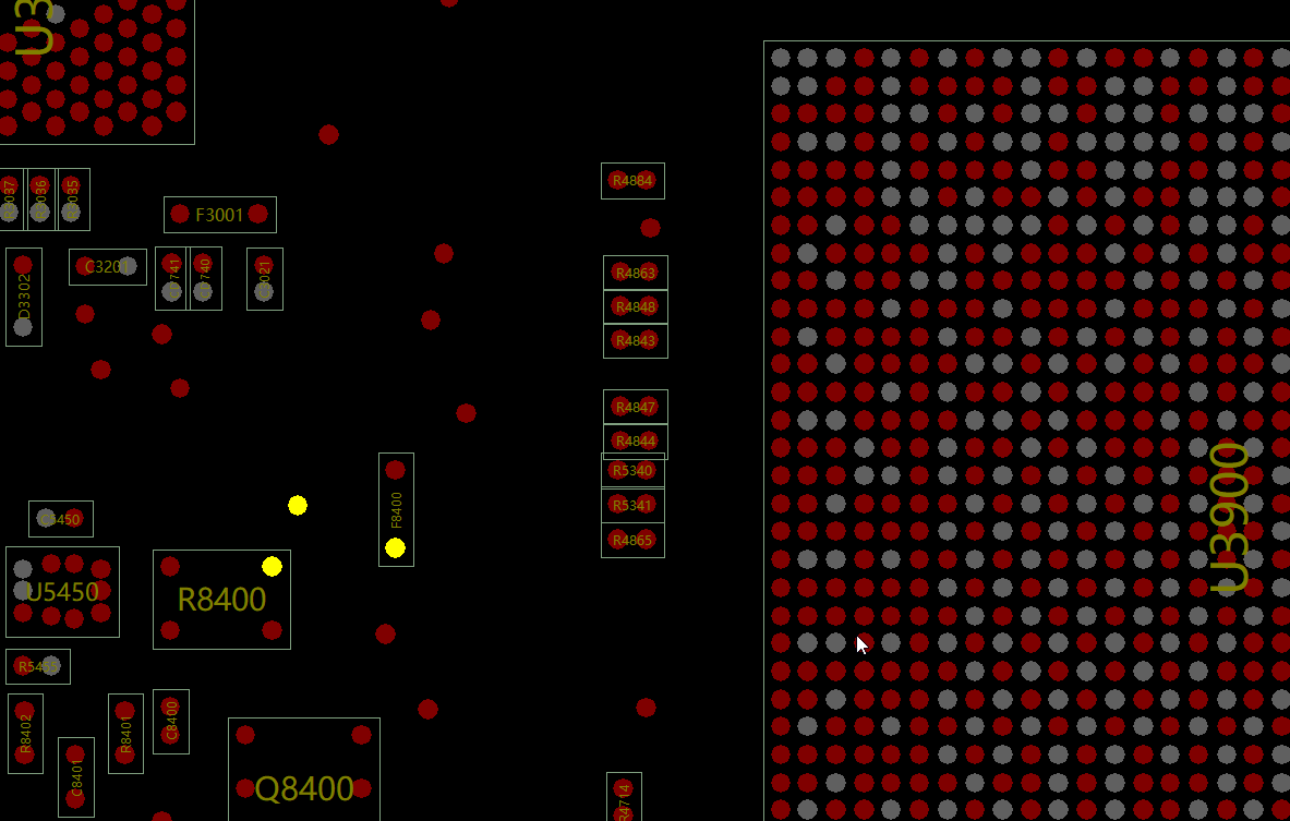

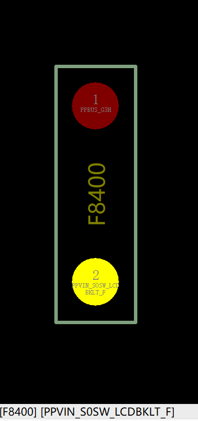

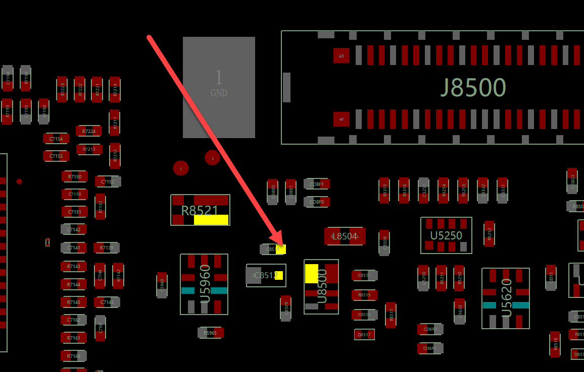

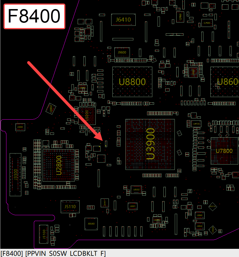

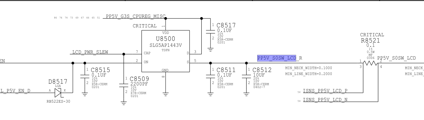

I have a MacBook Pro A2159 on the Mac everything was fine. But since I used the board in another Mac I think it was a A2289. I no longer have a picture. The display is dark! The MacBook works perfectly on the external monitor! Can a certain chip be broken because I connected the wrong display?
A2159 Display Dark after board test in wrong Model
