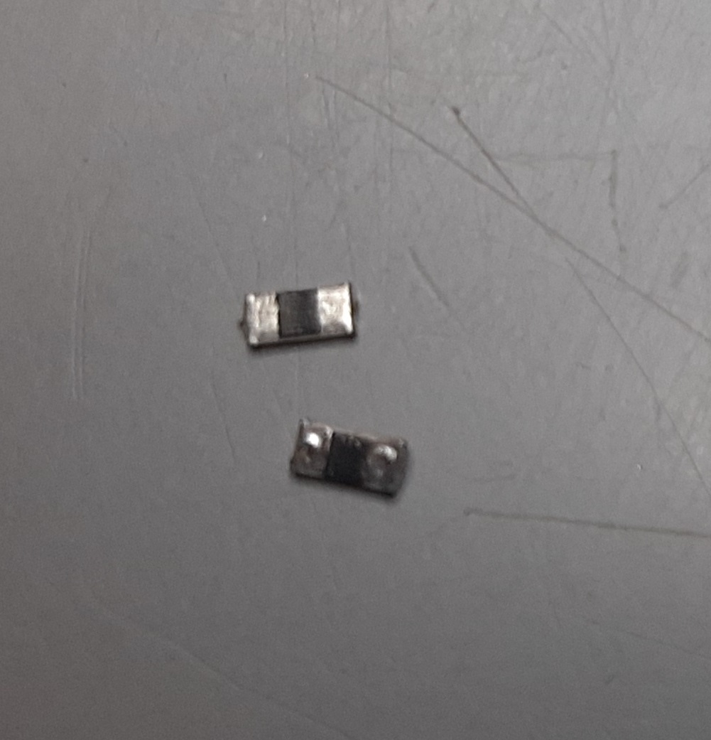

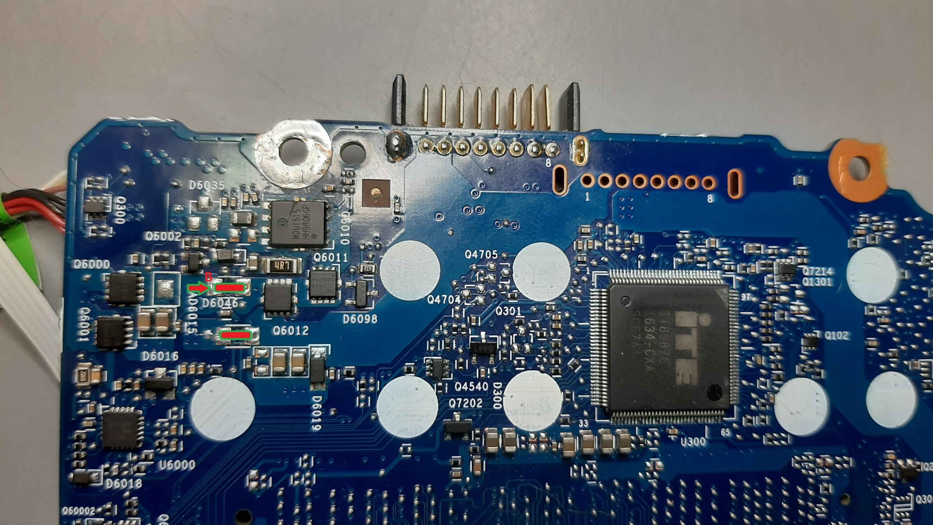

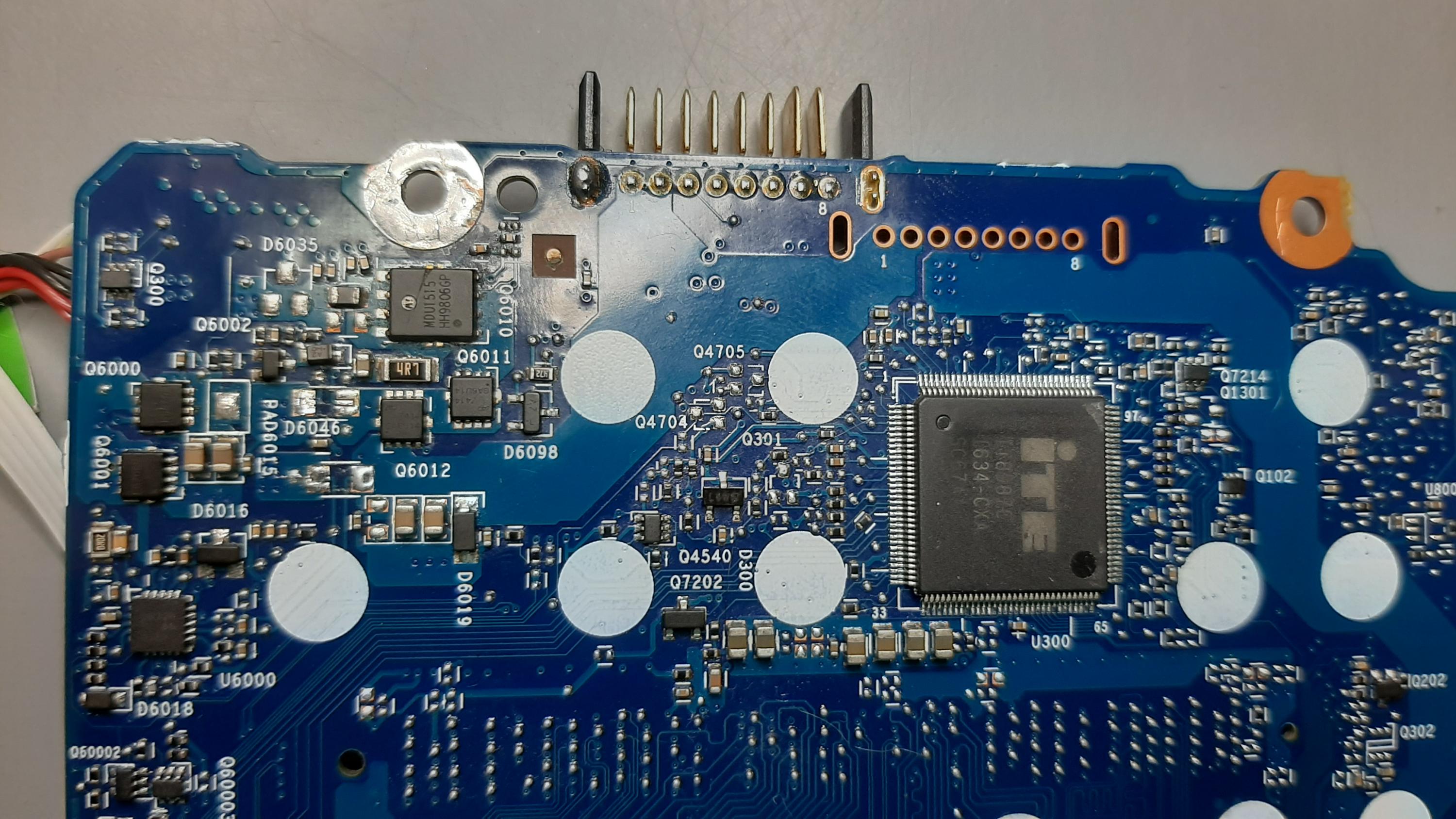

    Hello partners. Kind regards.
    I would like to know if anyone has knowledge of this motherboard.
    HP 14-006la
    I have been reviewing, and I found that these two pieces that appear in the circuit mark continuity, but I don't know what they are and if it is normal for them to mark like this. They do not have any numbering or identification on them or on the plate, only the one that appears higher in the image has the word "D6046" near it, but I do not know if it refers to that piece or the one that is higher than it, and If it is a diode, what type of diode is it, and what is its value?
    I wanted to know if someone can give me a guide regarding this part of the circuit, since it has been impossible for me to find that diagram so far, and all those that I have consulted about the HP brand with similar sources, do not show me those parts or their value. Already one of the colleagues sent me a schematic, but since it is not the same, those pieces do not know what they are and what they do in the circuit.
    I do not know if it is normal that at point b of the connection it marks continuity with respect to the plate's ground, or is it that there is a short circuit at that point. When removing these two pieces, the voltage in the U6000 that is more to the left below, starts to work and 25 volts reach the transistor Q6010 that is above, and there is voltage at its ends, but I need to know if the pieces that Take out are low value resistors or are zener diodes or normal shorted diodes, or other type of component. Before removing these two pieces, there was no voltage on the gate of the Q6010, and when removing it if there is the 25 volts that turns it on, but I imagine that when putting the pieces back, I suspect that more is going to be the one that says "D6046" The voltage is going to go, it seems that there is a short circuit, but the problem is that I do not know what those parts are and if their operation is to let the voltage pass through that area.
    Any help that someone can give me?
    Thanks...
