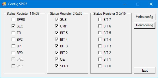

          I bought a Macbook Air off eBay as not working. It actually powered up ok. I noted that they had Big Sur loaded, but the EFI firmware was ancient (182.0.0.0). So I tried reloading MAC OS, and it had the same issue as you. On the first reboot, it would not power back on, and I'd have to remove battery etc to power on again. Then it would say that EFI update had failed.
          So I took a look at the board. All of the termination resistors for the SPI ROM measured ok, no corrosion. But I noted that Q8150 was missing on the board. Definitely removed or knocked off. It's part of the ALL_SYS_PWRGD logic, so it's interesting the board powered on at all. The seller said fan was intermittent, so I guess random fan spin fits.
          Anyway, installed that, and tried installing High Sierra. This was ok, no FW update. Then tried Mojave, this updated EFI from 182.0.0.0 to 188.0.0.0. Then tried Monterey, and it worked as well. So maybe your issue is elsewhere on your board, not specific to the SPI ROM.

            Re: MacBook A1502 EMC 2835 820-4924-A dies when installing firmware update
            Also posting the EFI config for the SPI ROM from my SVOD3 for reference. This is as read from an existing ROM off a 820-00165 MBA board. Quad Enable bit must be set. I'm assuming it's the same for other Quad SPI boards. The 820-4924 board is Quad SPI.
