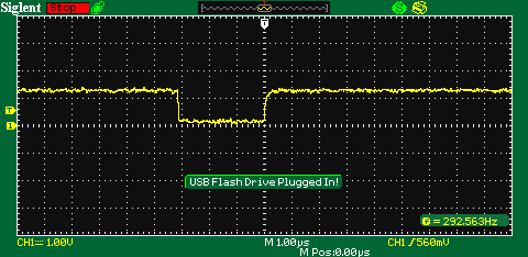

            I have tested the level of DDR4_DRAMRST#, and it is high level all the time, but it presents some 3 microseconds pulses until it dead. (here is where a digital counter is required)

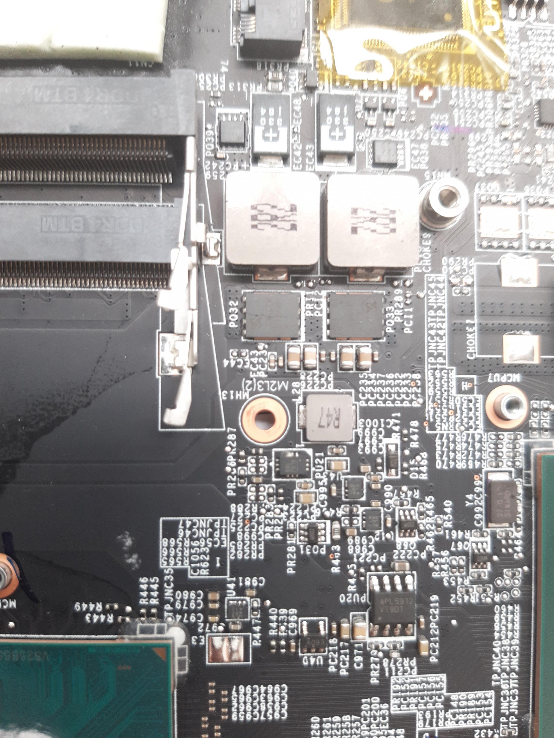

                    Also a visual check of PU21 - MP2147G i see what looks like corrosion between pins 2 and 3 . So going to order replacement for that chip too.

                      Re: MSI GP63 MS-16P5 no image
                      easily overlooked - appearance of corrosion between pins 2 and 3 of PU21
