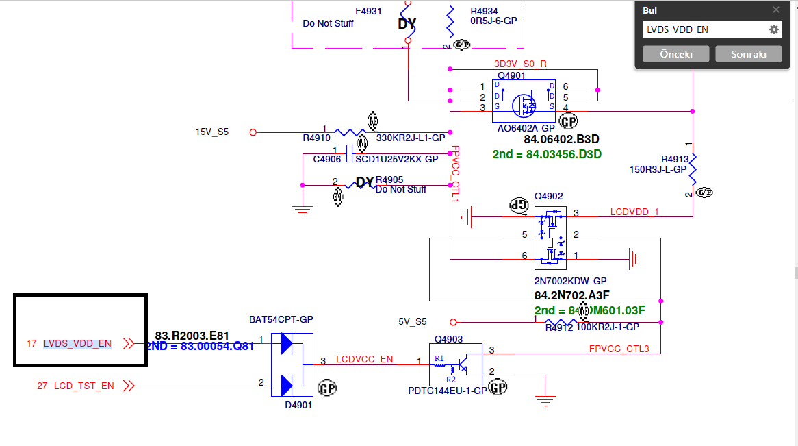

    Hi guys
    My problem is when I put the battery in the screen turns off and the laptop continues to work
    After checking, i found with the battery in that the voltage LVDS_VDD_EN goes
    any ideas

    Re: dell inspiron 5050 screen turned off
    Hi. Not sure why your post is in this part of the forum. It should be under laptops.
    1) with a power adapter, the LVDS_VDD_EN signal remains active? What is the voltage reading with the adapter?
    2) is the battery a known good battery?
    3) with the battery (only) does the LVDS_VDD_EN ever have a valid value?
    4) what if you have battery AND then add the adapter? Does LVDS_VDD_EN return to a valid value?
      firstable , I apologize for the posting this section
      With the battery LVDS_VDD_EN it becomes (0) even if the adapter is plugged in
      The battery is working ,I tested on another laptop
      Without the battery, the laptop works fine
        1) post the voltage reading for LVDS_VDD_EN with the power adapter connected.
        2) post the voltage reading for LCDVCC_EN (pin 3 of the dual diode D4901) with the power adapter connected.
          Thank to you guys flashing bios solve th broblem
