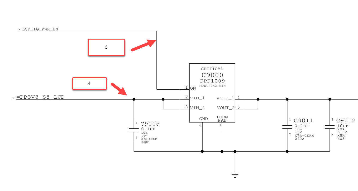

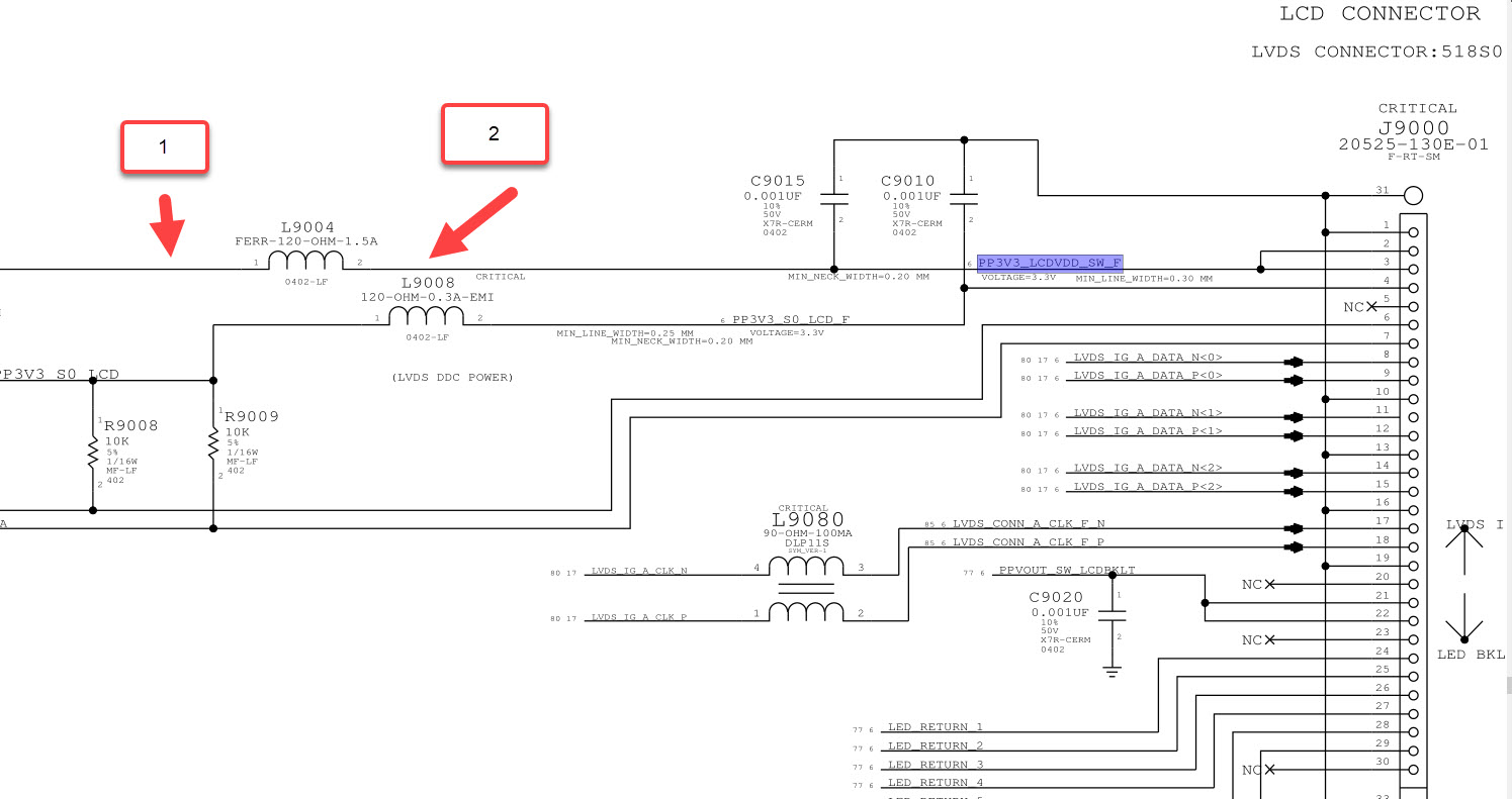

      1) Post the voltages @ 1 and @ 2 for the series ferrite bead (L9004) on the LVDS power rail. If the voltages are 0 volts -> power down and remove all power.
      Meter in resistance mode. Check and post the resistance to ground for the same @ 1 and @ 2 locations.
      2) Then repeat and post the voltages and resistance readings for @ 3 & @ 4 locations on the logic board.

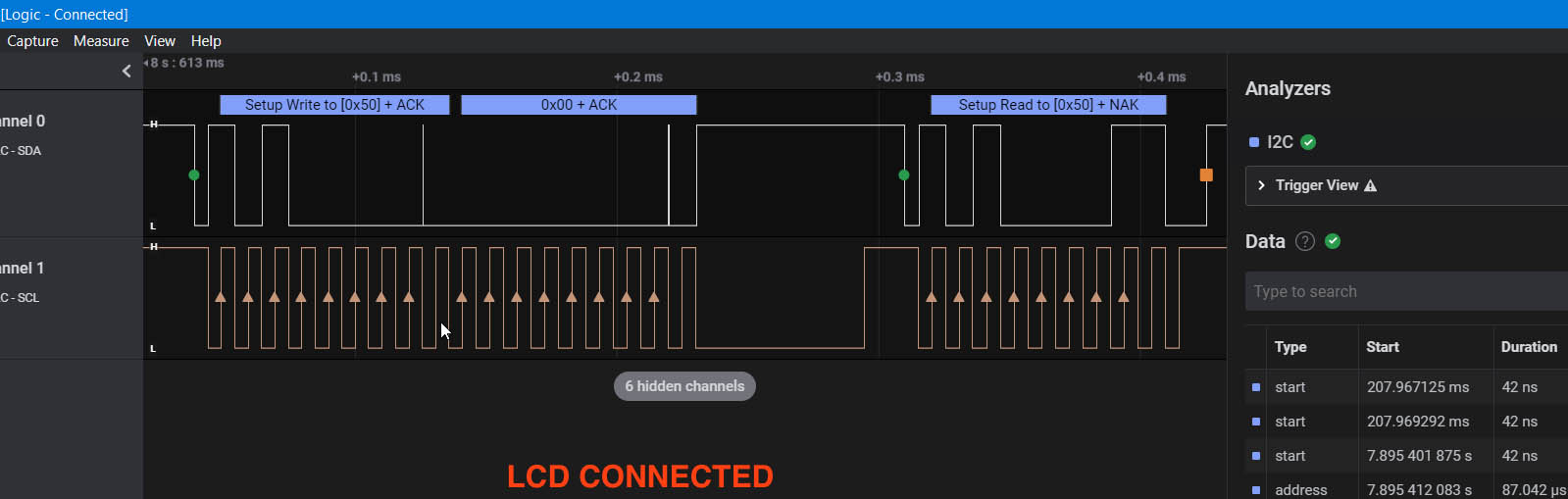

                  • piernov
                    • Jan 2016
                    • 4439
                    • France
                    Re: MacBook Pro 13.3 mid 2012 - a1278 - no internal display
                    Yes LCD must be recognized properly by the chipset by reading EDID through DDC I2C bus before LCD power rail is enabled.
                    Also LCD power rails will be disabled anyway if lid is closed. (SMC_LID low)
                    • EdwardGeo
                      • Mar 2020
                      • 109
                      • Ukraine
                      SMC_LID = 3.3V
                      LCD_IG_PWR_EN = 0v
                      LVDS_DDC_CLK and LVDS_DDC_DAT = 3.3v
                      PP3V3_S0_LCD_F = 3.3V
                      So possibly display died or chipset?
                        the board is 820-3115-B
                        PP3V3_S5_LCD = 3.3V
                        L9004 = 0 Ohm \ 0V
                        L9008 = 55 KOhm \ 0V
                        LCD_IG_PWR_EN = 0v

                            L9004 = 0 Ohm \ 0V
                            Ouch!!
                            Remove the LVDS screen and all power. Measure and post again the resistance to ground on L9004.

                              I disassemble lcd and trace the ddc I2C signal, this goes to rom ic, I think that this contain edid image. I think that need to measure the clock with frequency meter. If there is no data talking then possibly the chipset dead?

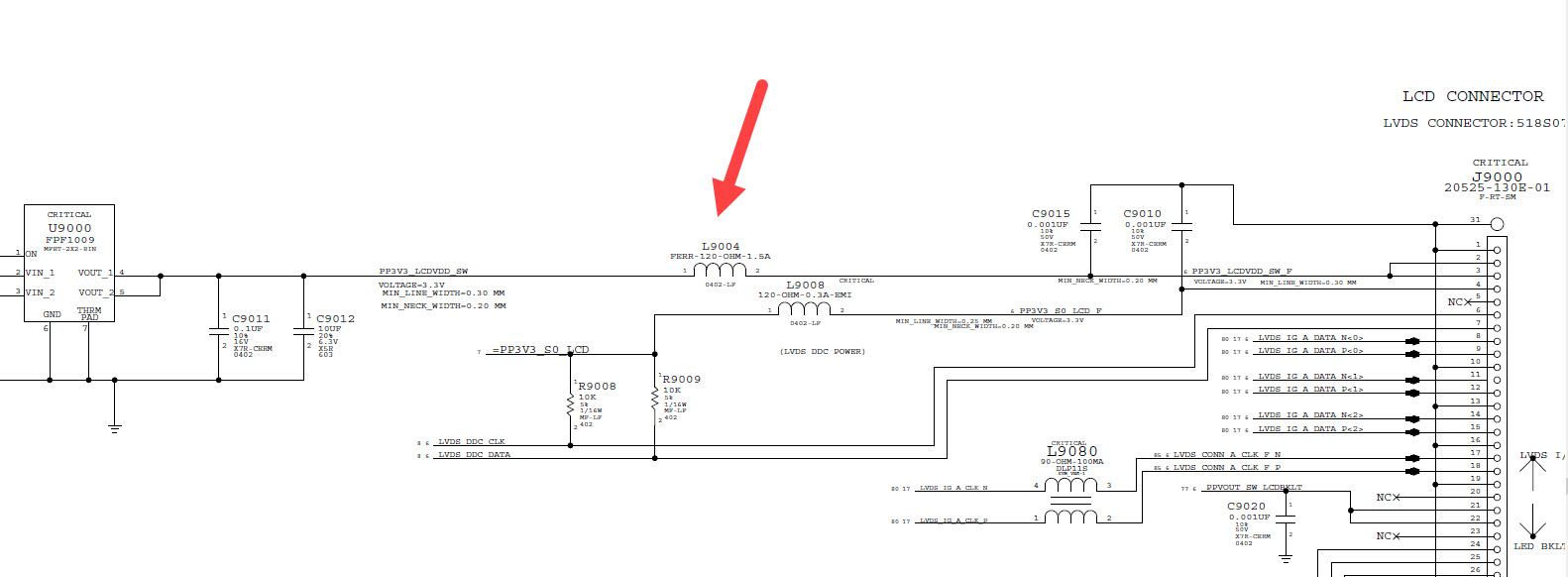

                                Hi. See attached. L9004 is the power to the LCD display via pins 2 & 3 on the LCD connector.
                                Is it this ferrite bead where the resistance to ground is 0 ohms & 0 volts (when powered) ?
                                If yes, remove the LCD and check the resistance again.
                                Do you see the same resistance @ C9011? C9012 ? If yes, remove each carefully and then measure the resistance again to ground.
                                Review the trace from U9000 to this FB for the resistance. There is a short somewhere on this line.

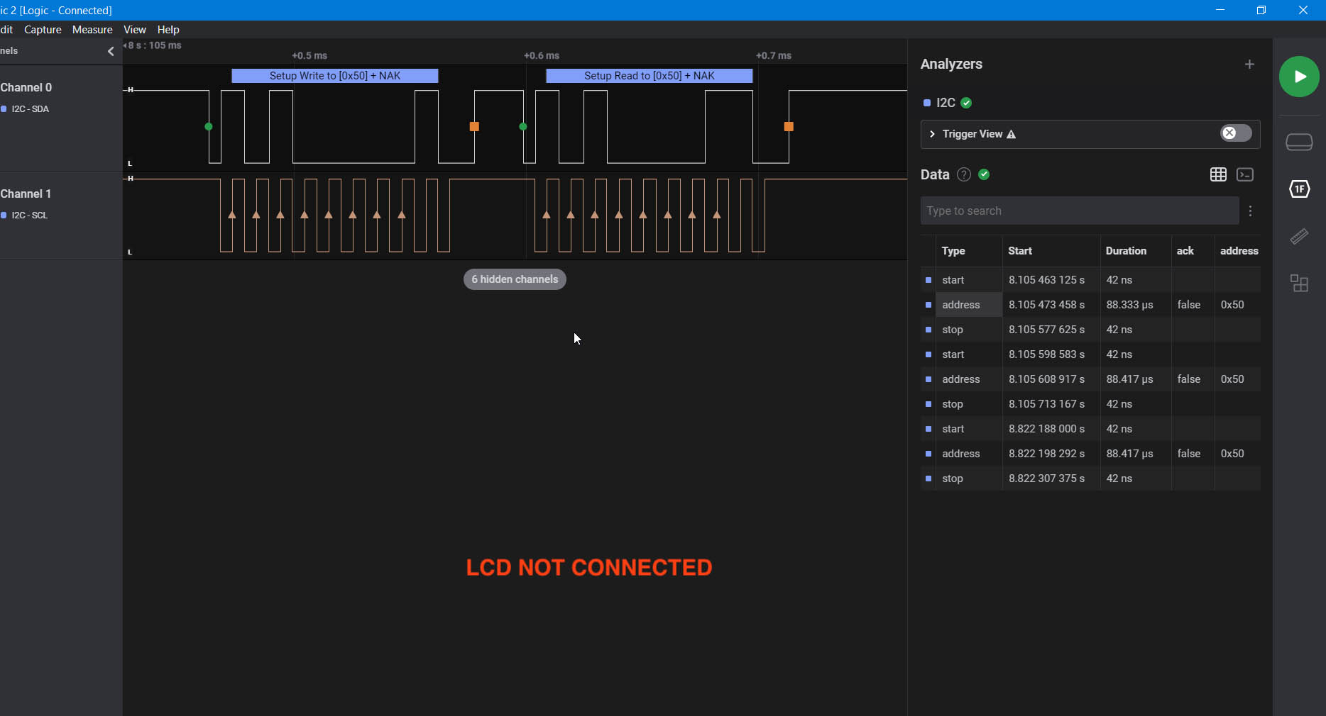

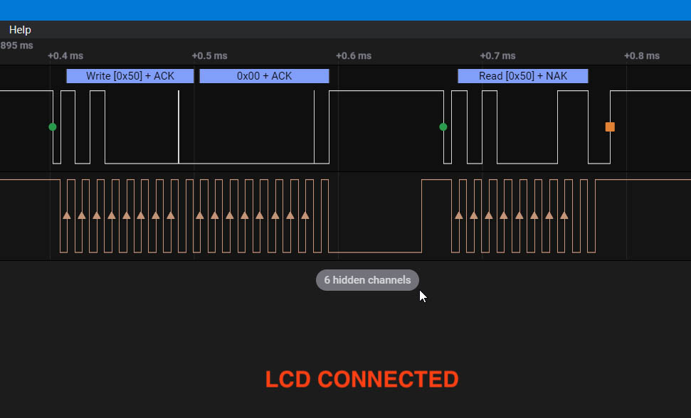

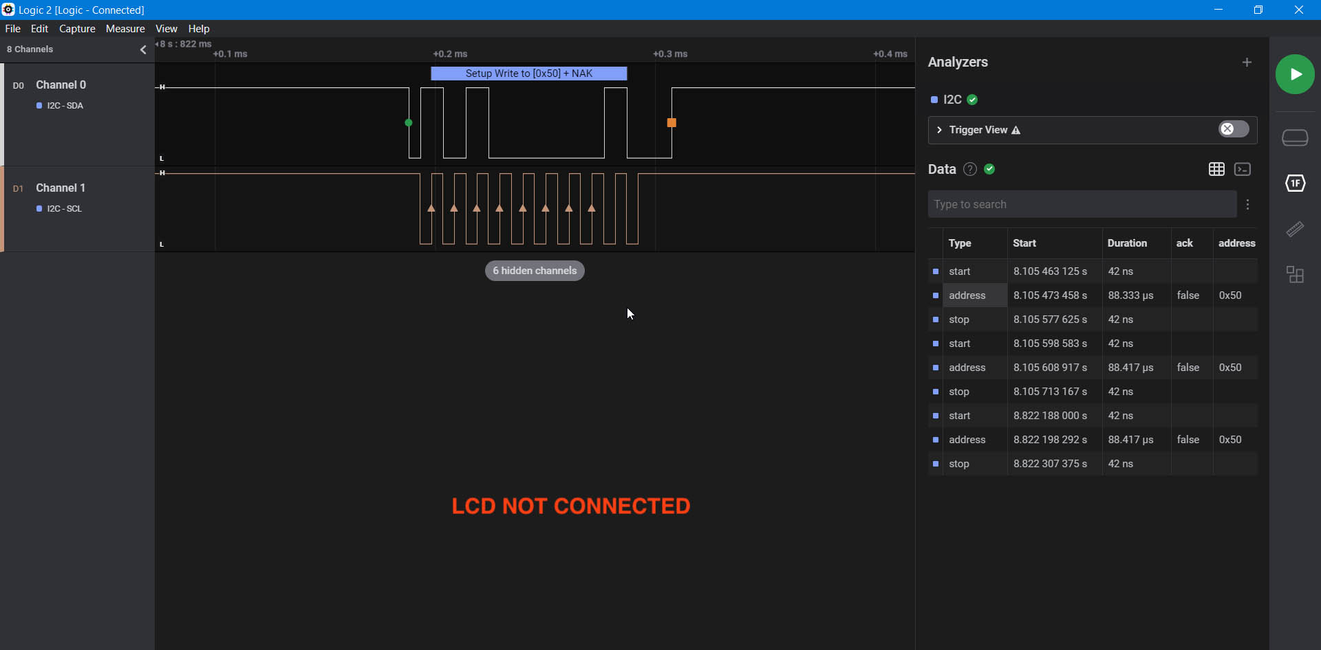

                                      I done I2C capture and seems the display is not sending data. But chipset is doing his job, not sure if that is correct (i do have only i2c sensors debugging experience) but add Sealogic projects. So DDC talk to lcd is present, but no answer. Tested all pin connections from Main board to LCD board, resistance are okay. Tested LCD board on short, heat - nothing...
                                        Can I force bypass edid read and power on 3.3 v to lcd vdd to check if lcd will power on?
                                        Or read eeprom with programmer to be sure that this one is working?
                                        Actually if any lvds display have same power on sequence, I can use any display to capture it and understand how that works. And replace display or if data exchange is incorrect, replace chipset
