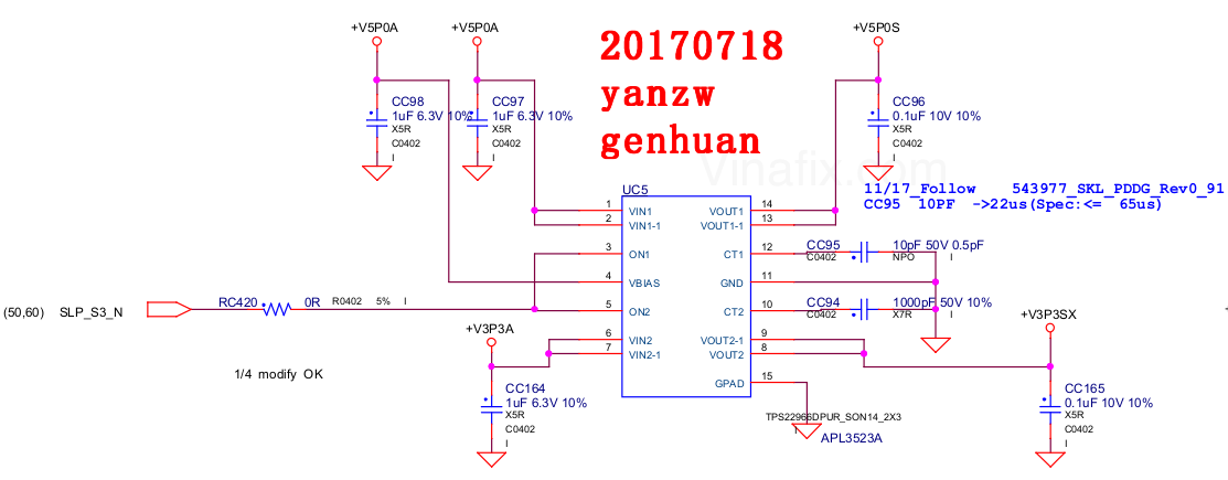

    Hello. I've a noob question.
    For same component model, are DFN (dual-flat no-leads) and TDFN (thin dual-flat no-leads) packages compatible? What are the differences, only the thickness/thinness? Is there a package format listing with such details (DFN and other types of component packages)?
    I found some list on Wikipedia and some drawings/photos on datasheetdir but without specifying the differences.
    Thanks in advance.

    Re: DFN and TDFN package differences and compatibility
    Hi. Yes.
    TDFN = will be the thinner version of the standard DFN so will be a lower height on the component.
    If possible, please share the part # and/or datasheet for more details. Often the datasheets will share a mechanical diagram for the proper pick & place placement equipment for the automated assembly. There it is critical that the parts have the proper height defined in the CAD tool. We have had this issue recently where our SMT head was turning on the vacuum to pick the part but we had the improper height definition so it was not creating the proper pressure to pick up the part. Kind of a gentle kiss to the top of the part and skipped to the next part on the tray feeling the part was not there. Chaos.
    Be sure to compare the pin to pin pitch dimension as well as the X & Y values. In general, only the height will be different.

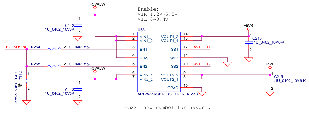

      The part is APL3523AQBI-TRG_TDFN14_2X3 (Datasheet).
      I transplanted one from 330S_KBL_MB_V09 board to NM-A381 (see attached pictures, AFAIK they are the same). Still waiting for another part before testing it.
      The questions comes from wanting to buy the part for later use on 330S_KBL.
        Yes, the 2 parts look to be drop-in equivalents. Personally would select the TI branded part for such repairs.
