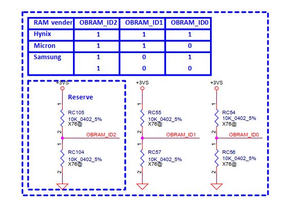

                try this

                    Re: Lenovo 110-15ISK onboard memory disable
                    Originally posted by onlinejaved
                    try this
                    This is not for disabling ram. These board_Id's are for different brands of onboard ram.
