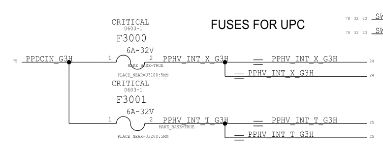

        4) Confirm that the 2 * fuses (one for each ACE CD3217 controller) are ok. See attached.
        We need 20V before U7000 can work but good to check the following.

          4) Both fuses have continuity
