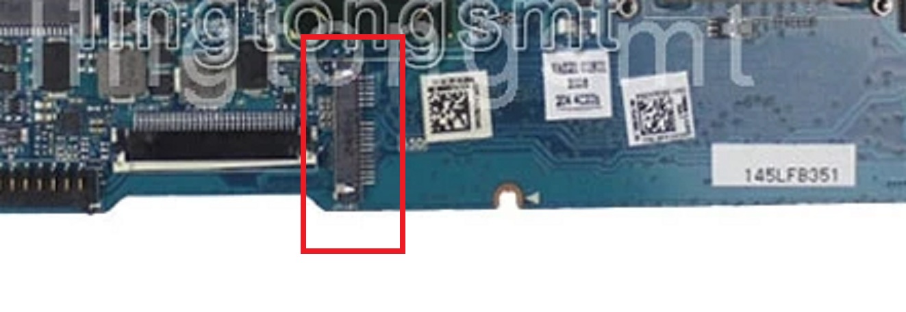

    Guys,
    I can't understand if the SSD in my Asus UX31A is upgradeable to higher capacity and if not what do I need,any special adapter?
    Thxxx...

    Re: UX31A upgradeable SSD??
    Post picture of mainboard.
        Originally posted by paparazzo79
        Guys,
        Thxxx...
        on board right near the keybord connector u have connector for ssd. if not, u cannot upgrade
          You just need the adapter.
          Search eBay for: M.2 NGFF SSD To 18 16+2 Pin Adapter Card SSD for Asus UX31 UX21 Zenbook Laptop
