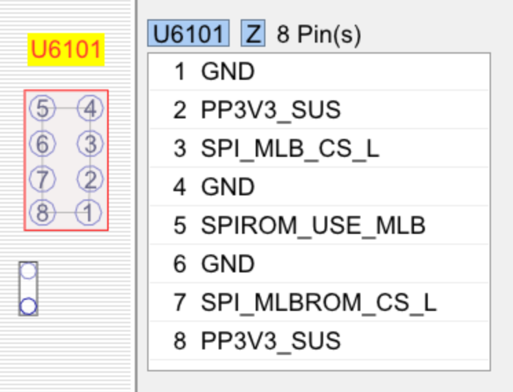

    Hey everyone, I'm here due to my screw up while re-soldering the BIOS chip after programming it to have the EFI lock removed.
    Background:
    While re-soldering the chip, some solder came out and bridged the U6101 chip. Without taking note of the orientation, I just took it off making note of the orientation that way. Well, my clumsy hands flipped the chip.
    I took a gamble and soldered it back on. Lo and behold, it booted up. No more EFI lock, rebooted just to be sure. So I took it out and doused it with some isopropyl alcohol to clean the flux off. Next thing I know after re-assembly, the laptop no longer powers on. While panicking, I removed the U6101 and flipped it around several times. After checking the board view, it appears that I have connected the supply to ground and vice versa, also grounded one of the SPI lines and connected one pair upside down.
    Question time:
    May I know if the issue could be correlated with U1601? Would installing it upside down screw other parts of the SPI circuit? I have removed the BIOS chip and read it successfully using a programmer. While scrubbing the board, the metal shaft of the brush I was using may have slightly contacted the area I was cleaning. At the moment, the MagSafe indicator turns green then orange immediately regardless whether a battery is connected. No fan spin.
    Thanks for going through this with me in advance. Thank you so much!

    Re: MacBook Air A1466 (820-00164) Problem with SPI?
    check all resistors and lines around EFI ic. especially on 2nd and 5th pins. i think that you burned one of 40ohm resistors.

      Got it, I do have some U6101 on the way however. Will check the resistance around the chips once I install em. This issue points to EFI issue right, hoping that I didn't fry any major voltage lines. Thanks for the reply!

        Hey, I have checked all the resistors on the EFI/ SPI Lines. They all seems to be up to spec. Checked the PP3V3_sus as well and its present. Still amber light and no POST? Any idea what's next? I have also installed the new u6101 and I have checked the points, doesnt seem to be shorted to one another. Thanks for your reply in advance!

          Upon further checking, PM_SLP_S4_L is only present momentarily after plugging the charger in. It seems like U7501 is trying to power on, resulting in PP5V_S4RS3 fluctuating in a loop. Where should I go from next or should I try resoldering the bios chip?
