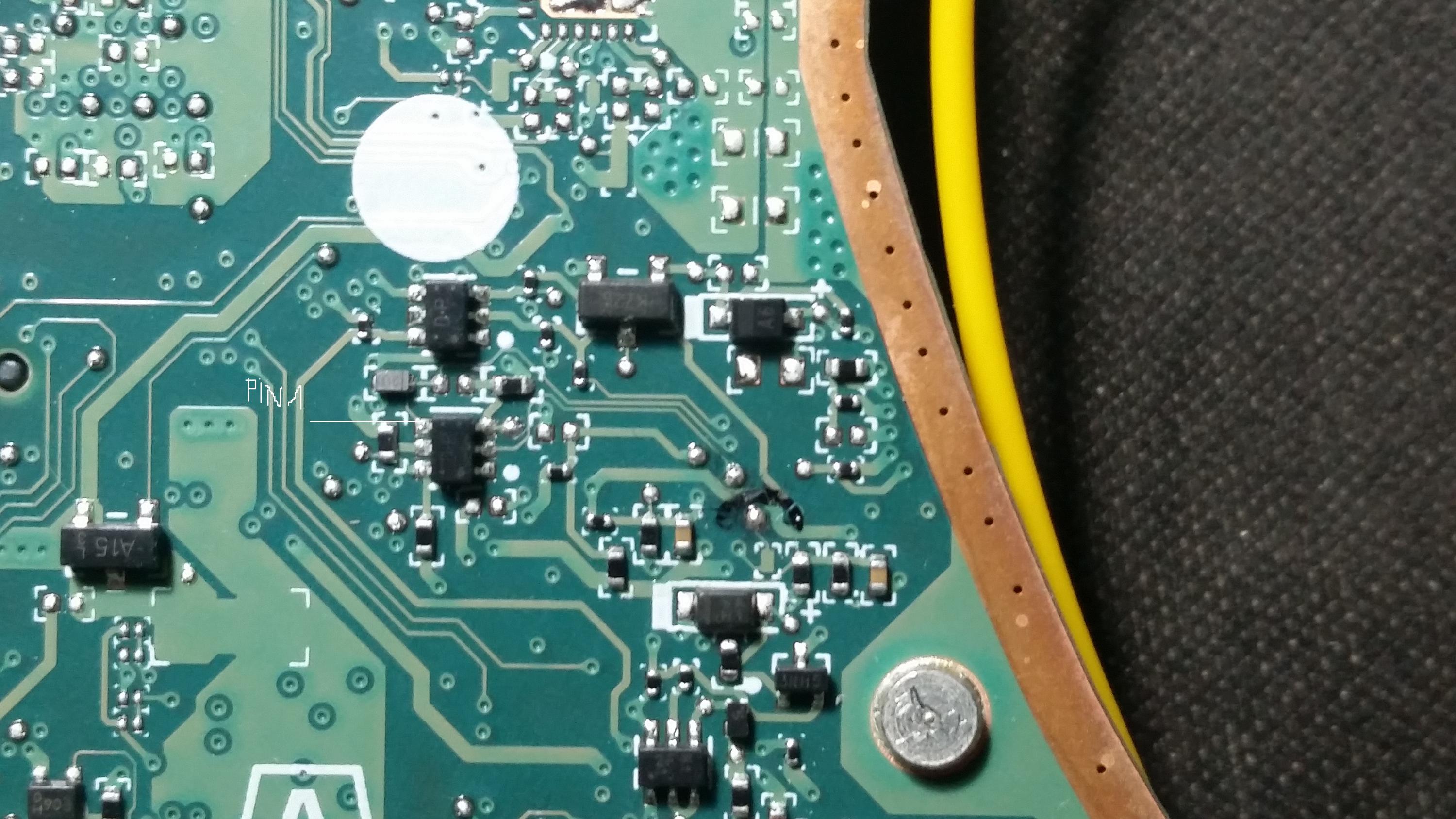

      Re: Lenovo Thinkbook 15-iil Problem - Need help
      It is usually closer to the dc jack than the kbc, you have to go from the jack, with no power applied to the board, tracing the circuit with the beeper function of your multimeter.
      Have tried to trace the circuit with beeper for several hours but i think it is pretty impossible without a circuit board since there are 6 or 7 layers with so many Vias. Have just found two solder points (test points i think..) that are connected to the middle pin that's all .
      May be you have a trick on how to do that ?
      Thanks anyway.
      PS : Is the IT5570VG-128 the KBC ?
        Yes you are corect in your identification of the kbc. As far as tracing goes, isn't there a boardview available? There is a helpful trick I've learned from someone which involves sticking one of your multimeter probes in steel wool and running that across the board. When it starts beeping you slowly reduce the size of the wool touching the board until you have narrowed it down to a few components that can be quickly checked one by one.
          Thanks for this.
          Meanwhile i've made some progress. I found that the middle pin of the AC adapter is connected to the pin1 of the NChannel Mosfet as shown in the attached picture and this corresponds to the schematic (also attached) related to a Lenovo different from the mine wich i used for guidance purpose since the schematic of the mine is not available.
          Is the resistor you are referring to, indicated in the schematic and or the picture? and how to know it is faulty?
            That's why you couldn't find it on the board.
            But at least now you know you are looking for a transistor first. Check PR419 and PR420.
              N Mosfet checked : No short
              PR419 checked : 720 ohms
              PR420 checked : 500K
              (checked on board ie without desoldering)
