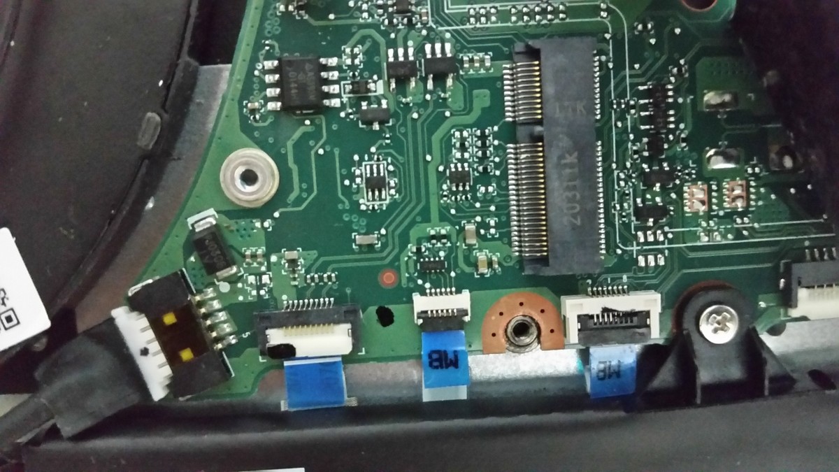

            Re: Lenovo Thinkbook 15-iil Problem - Need help
            Sorry for a wrong information i gave. The actual voltage of the AC charger is 20v measured with a professional multimeter loaned from a friend. (I was using a cheap faulty multimeter...). So now the problem seems to be the power supply circuit since the laptop have been running without problem with just the battery connected.
            Here is a picture of the area around the DC input to the motherboard.
            Have i to dismantle the motherboard and take pictures on the other side?

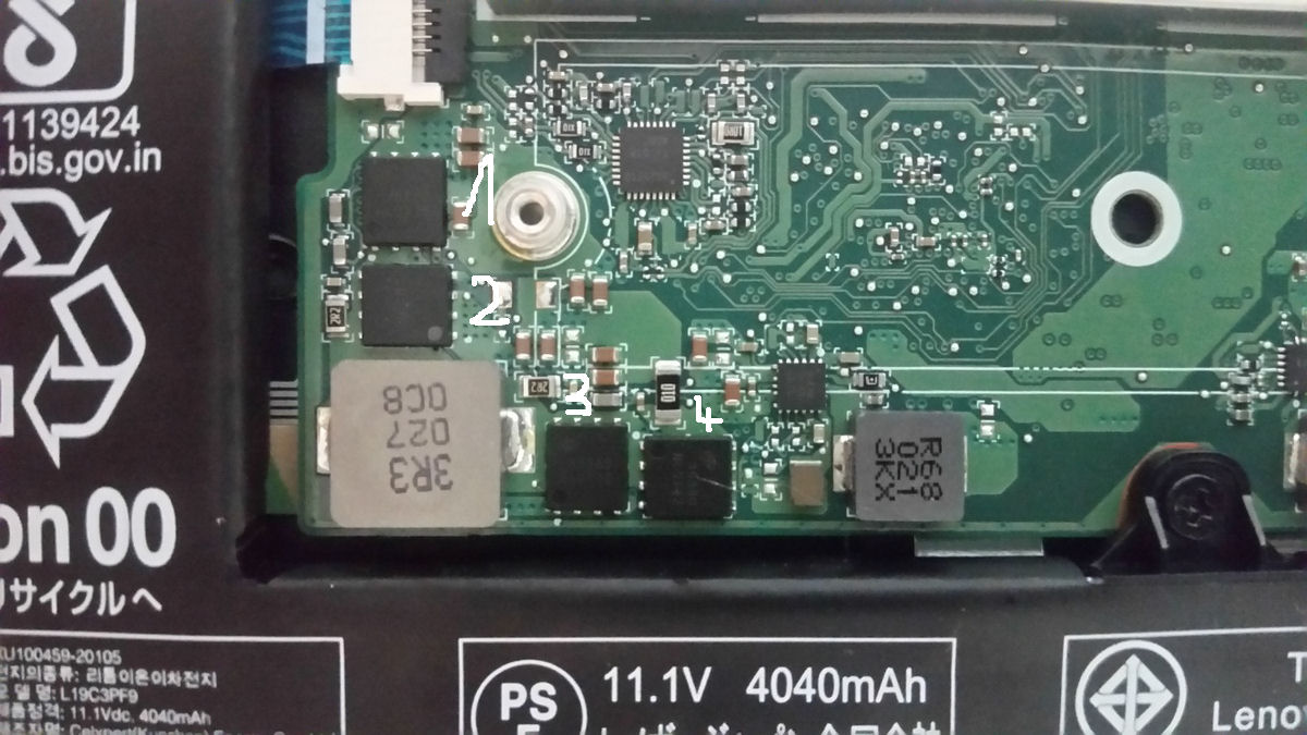

              Find out the DC-IN mosfets and check voltage on them for pin1/4/8 and post here.
              • Eddy25
                • Oct 2014
                • 17
                • France
                Since i don't know exactly where are the DC IN Mosfets, i have measured the voltage of the 4 mosfets situated near the sensing resistor and the battery connector. I have marked them as 1 , 2, 3 and 4 in the attached picture.
                Here are the results :
                Mosfet 1 :
                pin 1,2,3 : 2.5v
                pin 4 : 3.7v
                pin 5,6,7,8 : 9.1v
                Mosfet 2 :
                pin 1,2,3 : 0v
                pin 4 : 3.65v
                pin 5,6,7,8 : 2.5v
                Mosfet 3 :
                pin 1,2,3 : 0v
                pin 4 : 4.7v
                pin 5,6,7,8 : 1.65v
                Mosfet4 :
                pin 1,2,3 : 1.65v
                pin 4 : 2.3v
                pin 5,6,7,8 : 20v
                ps : The measurements are made with the battery disconnected.
                Thanks a lot for helping.

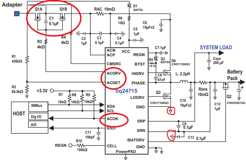

                      can you check the input MOSFETs and test points in the theoretical diagram? Without an ACOK signal, the system may not turn on.
                      I'm not happy to be so strong. because it's not humanly
                      • Eddy25
                        • Oct 2014
                        • 17
                        • France
                        Thanks for helping.
                        Have checked the 2 input mosfets (Pchannel mosfets) and there are no shorts. Their voltages are as follows :
                        Source : 20v for both
                        Drain : 20v for both
                        Gate : 10v for the first and 9.6v for the second.
                        As for the test points my ic charger is BQ25710 and not 24715 like in your schematic. So I have made the following measurements :
                        pin1 (Vbus) : 20v
                        pin4 (CHRG_OK) : 2.9v
                        pin12 (SDA) : 3.2v
                        pin13 (SCL) : 3.2v
                        pin31 (HIDRV1) : 8.2v

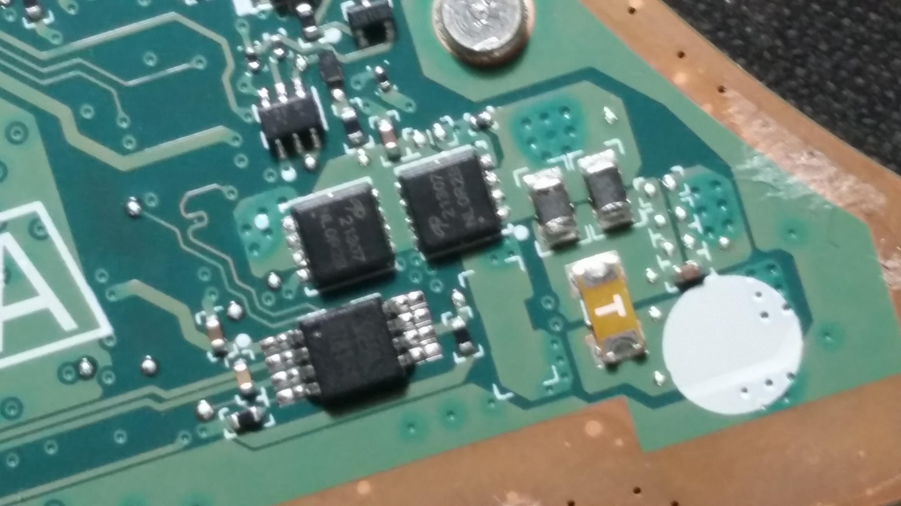

                          Here is a picture of the dc input zone.
                          What is the yellow device marked as T ? because i have noticed that it's shorted (unless it is a very low resistor or a fuse)
                          The 2 grey capacitors connected to the source of the first dc in mosfet are also shorted! Could this be the problem ?
                          • mcplslg123
                            • Jun 2015
                            • 7262
                            • india
                            The yellow thing is a fuse. Those grey capacitors are NOT CAPACITORS-They are coil.
