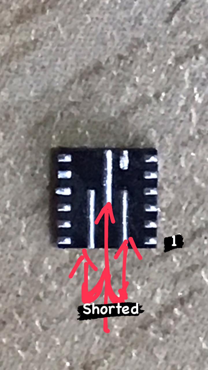

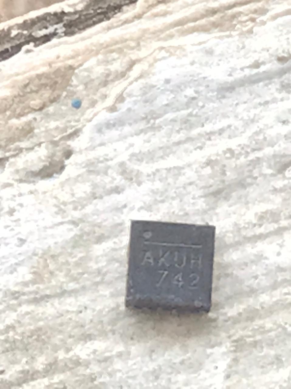

    Hi there, i've ideapad, get shorted in IC AKUF742 (NB685GQ-Z_QFN16_3X3). after pull out this IC the shorted is gone but the laptop cant on, so i want to ask can it power on without replace the ic? need trick

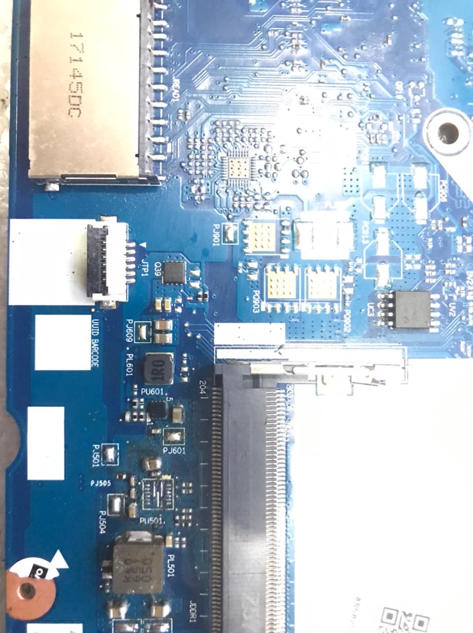

    Go to the logic board, pu501.
    Use your meter on each of these same middle 3 tracks.
    Are they shorted to each other?
    If the part is confirmed to be shorted then it must be replaced.

      Re: Lenovo ideapad 110-15ACL No Power.
      Attaching the datasheet for this part. Available from MPS. It should be replaced.
        in MB no shorted, VIN to PGND.
          https://www.aliexpress.com/item/3279...26063282%22%7D
          ok, thank you sir, i will try to replace it.
