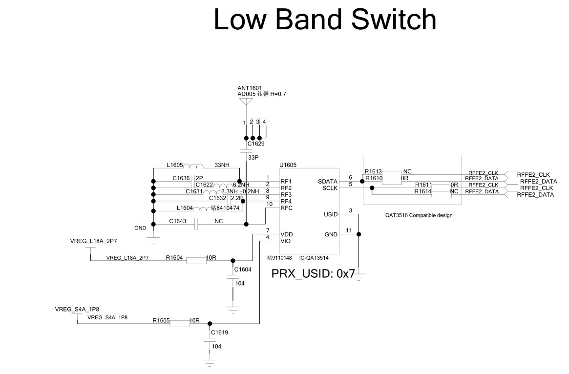

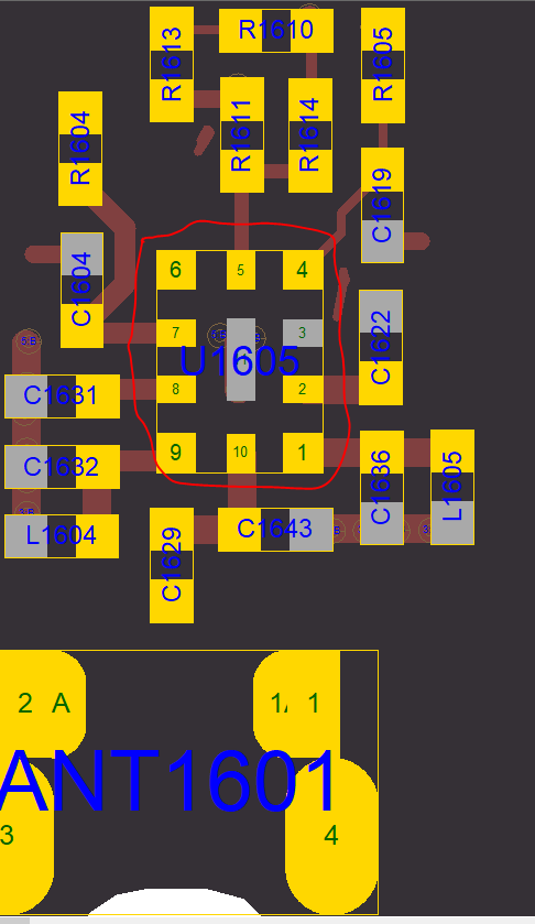

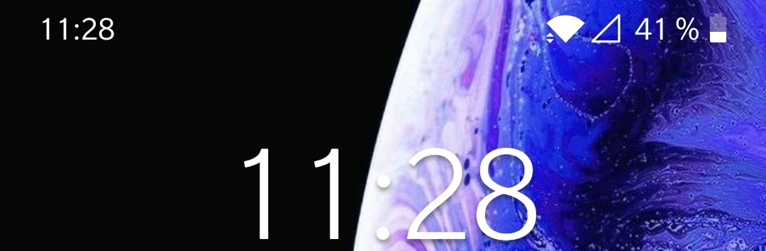

    Hi everyone, I'll start saying that I am a beginner in microsoldering, I am still learning. Recently I am trying to repair my OnePlus A6003 with a problem of having no service. The phone dropped very hard while riding my bycicle. The screen on the area of the sim card is broken and after that the phone started to have problems with Internet data, very bad reception. So i checked for shorts and it seems there were none. I opened the phone and checked the area of antennas helping me with ZXW. Unfortunately I couldn't find any schematic for my model. Then I saw the area in the picture: the red square chip seemed a bit lifted so i tried to remove it in order to place it better but I ended up just breaking it, now I have no signl at all, but I can still connect to wlan without problem.
    The phone is fine what is missing I believe is only that chip but I have no idea what kind of chip and were to find it. It is really not convenient to buy a broken oneplus only for a chip.
    If anyone can help me at least to identify the chip would be great.

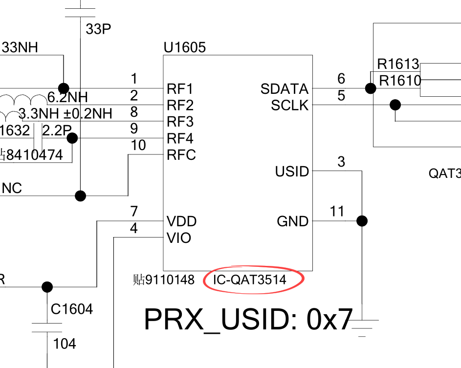

    Re: OnePlus 6 A6003 No Service
    See attached.
    Believe this is Qualcom p/n QAT3514 and is a RF switch / multiplexer.

      Thank you very much for your help. I will defenetely try it, hopfully will work fine. Do you maybe have the schematics for Oneplus 6?
