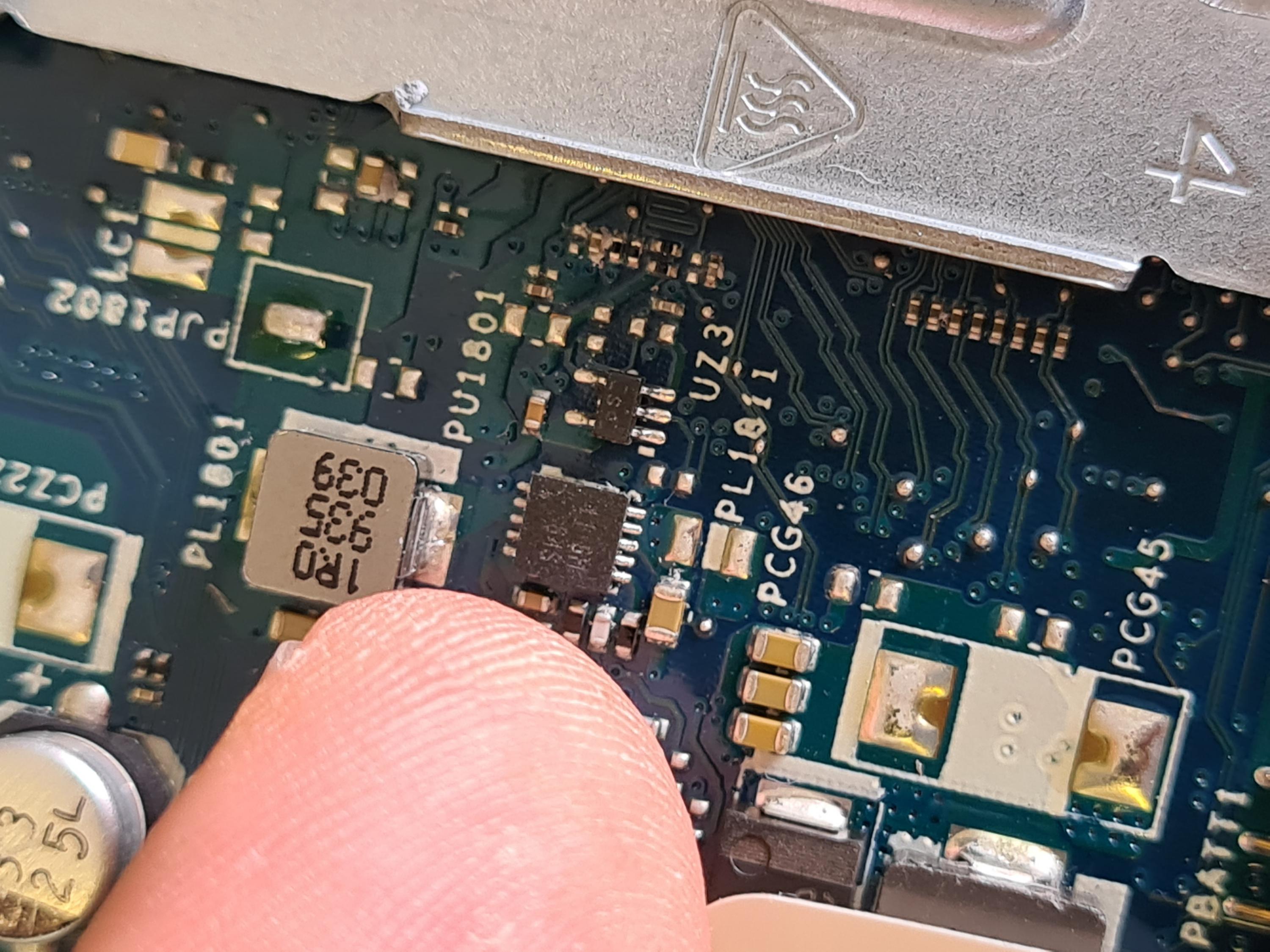

LA-J091P Chip Identification Please
  • Ado02
    • Jul 2021
    • 100
    • United Kingdom
    Getting very hot: 11 6H 64S
    Motherboard: FDI45 / LA-J091P

    Re: LA-J091P Chip Identification Please
    Richtek RT8061A
      Originally posted by piernov
      Richtek RT8061A
      Thank you for your quick reply.
      Do you mind me asking how did you manage to find this?
      Also, do you happen to know if this chip will fit even though the original chip has pins on the outside?
      I am new to this game. So sorry if the question sounds silly to you.

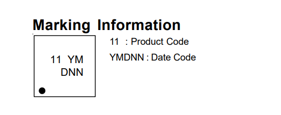

        hi.

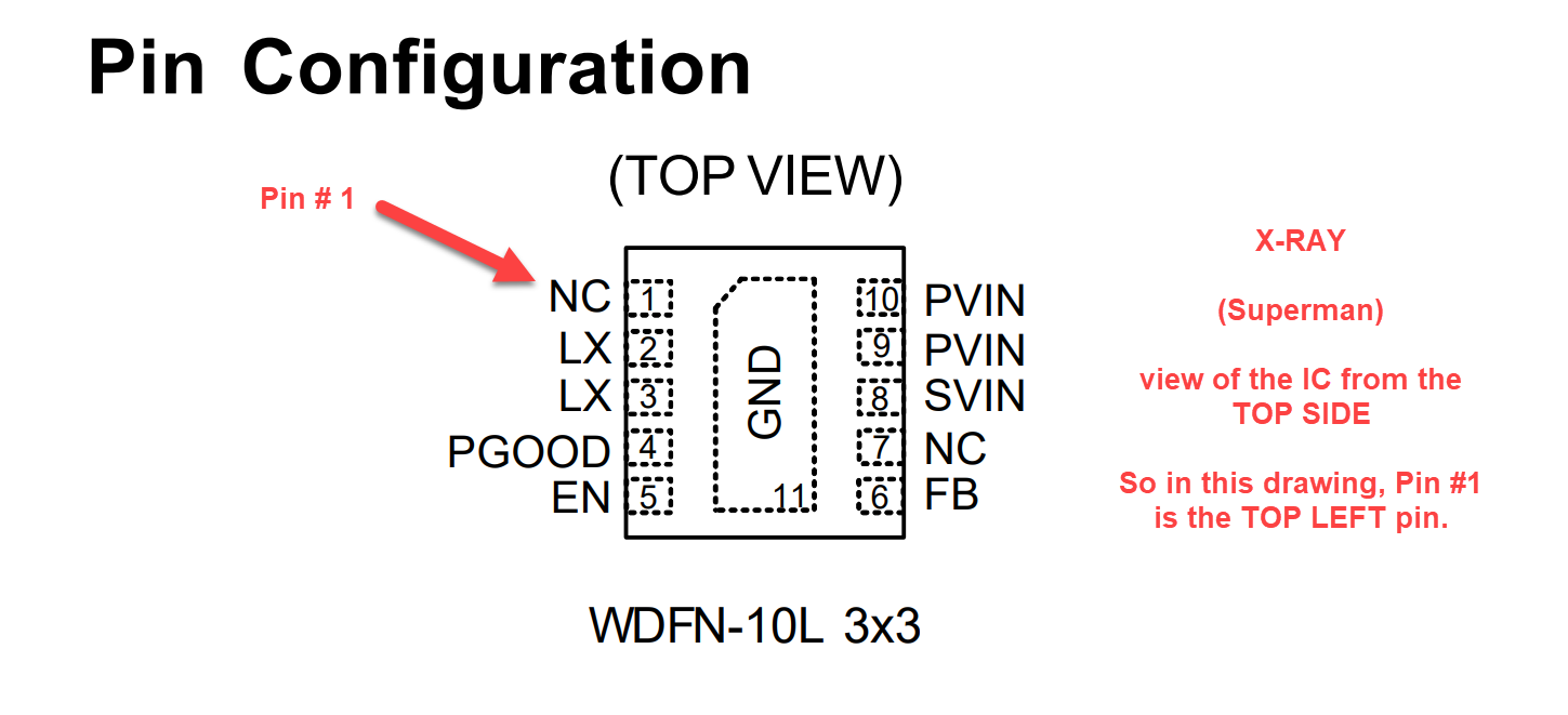

        1) Experience. He and others have built up a database of IC markings from Richtek and other semiconductor suppliers. You can search for it on this user forum. You can also check his logiwiki website for other tidbits of knowledge.
        2) it is the same part and you can review the full details from the datasheet that can be downloaded here:
        https://cdn.badcaps-static.com/pdfs/...ebcab0fa8d.pdf
        Source and replace your defective part. Just be sure to locate the pin # 1 of the original and match it with the replacement.
        3) See attached for the laser markings on this component.
