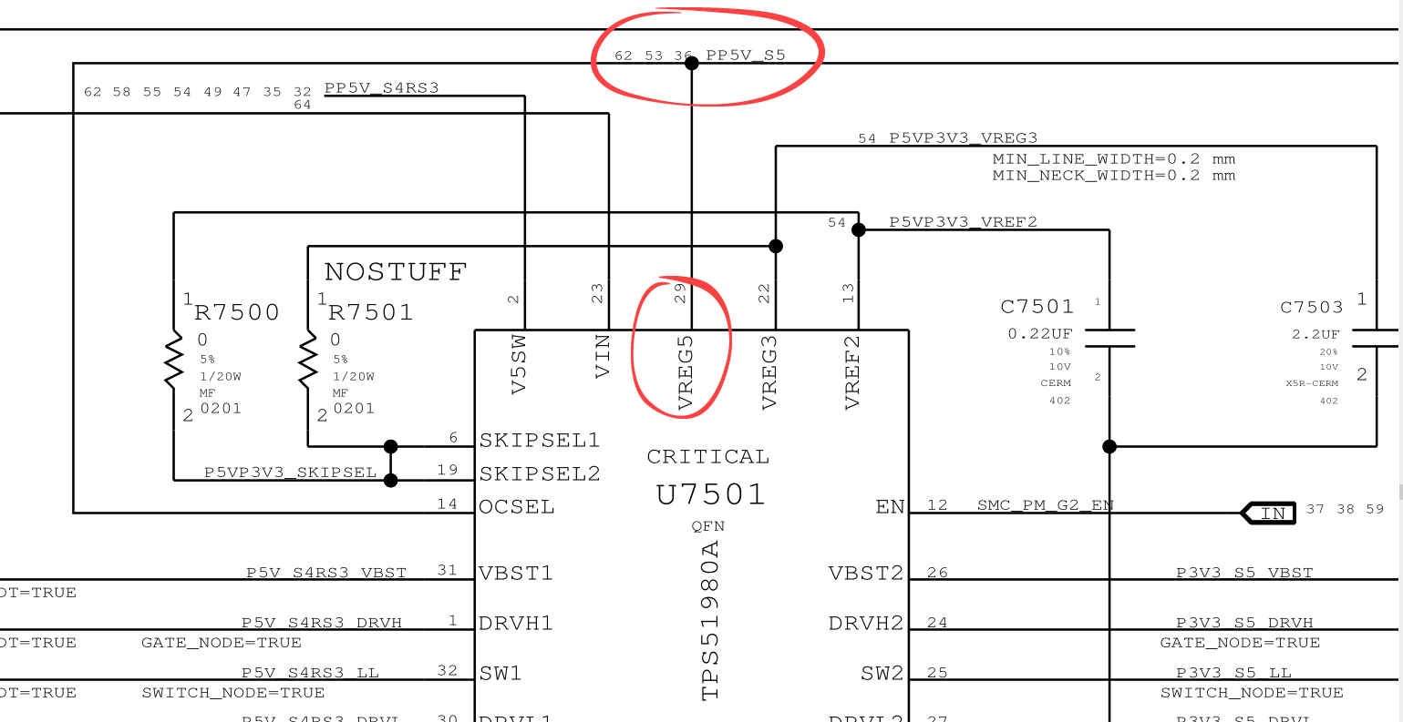

    Hi at all,
    I got an Macbook Air (820-3437-B) with liquid damage which wont turn on.
    "G3Hot" Rails
    PPBUS_G3H = 8,19V
    PPBUS_S5_HS_COMPUTING_ISNS = 8,19V
    PPBUS_S5_HS_OTHER_ISNS = 8,19V
    PPDCIN_G3H = 16,69V
    PP3V42_G3H = 3.44V
    PPVRTC_G3H = 3.44V
    "5V" Rails
    PP5V_S5 = 0V
    U7701 is in that area where the liquid was and looks some kind of black/burned.
    My Questioin is where PP5V_S5 is generated and if U7701 could be the problem which I guess so.
    Thanks in advance.

    Re: 820-3437-B No PP5V_S5
    My Question is where PP5V_S5 is generated
    U7501 creates the PP5V_S5 rail.
    https://store.rossmanngroup.com/d1-tps51980.html
        PPBUS_G3H = 8,19V
        PP5V_S5 = 0V
        SMC not running.
            Have you replaced U7501 yet? Do you have the PP5V_S5 rail ?
            Once you have U7501 replaced / operational - then consider to do a SMC reset:
            https://logi.wiki/index.php/Startup_Keys#SMC_Reset:
            So 8.19V should be ok, should'nt it?
            Yes, till SMC enables as per:
            PPBus_G3H is the main power rail of the Mac. It is powered from either the battery or DC in. Its voltage will be based off how many battery cells are in series. The MacBook Pro series uses a 3S2P battery so on the charger it has a PPBus of 12.6V (12.2V before SMC boosts). The Air has a 2S3P battery so on the charger it has a PPBus of 8.6V (8.2 before boosting). This is to charge the battery, which will have a lower voltage than PPBus
              PPBUS_G3H should be 8.56V on MacBook Air starting from 2013 models.
              8.2V on PPBUS_G3H and SMC_PM_G2_EN missing mean that SMC is not running.
              https://logi.wiki/index.php/SMC_Circuits
              You should watch some Louis Rossmann videos.
                There is no point in replacing chips randomly without proper troubleshooting procedure — except create more problems.
                SMC reset is effectively performed when disconnecting all source of power (Magsafe and battery).
                      Hi guys
                      Sry I forgot to post about the results.
                      Device is working again like a charme. I did like Piernov told and watched some videos from Louis Rossmann and in one he mentioned that the problem also could occur if the connector for programming the board(I think it was J1800) is corroded and it was. After removing it an cleaning the pads the machine started. THe only problem was that after running it for some hours the backlight would went of but there it was just some dirt under the diode arround teh LCD connector.
                      Again, thank you very much you and this forum are awesome
