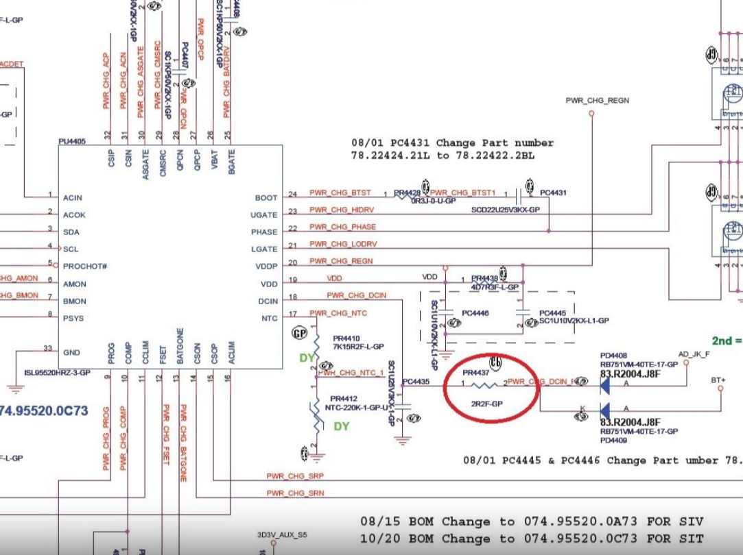

    Hello. I have a asus rz09-0329 here that has problems charging. Here are the symptoms:
    -Will not charge while off, nor while in bios/bootup.
    -Will not power on if the battery is disconnected.
    -Powers on with the battery connected, with and without charger.
    -Only charges while in Windows 10, but only if I disable the "Microsoft AC Adapter" device. If it is enabled, it says it is running on battery power only.
    Funny thing: I can boot windows with the power supply and battery connected, turn off the laptop, disconect the battery (without unplugging the power supply), and boot up with the battery disconnected. But if I unplug the power supply, I can not get it to turn on without the battery connected.
    I was thinking it might be the charge controller, it has an ISL95520HRZ, but I am not sure, and would have to order one from aliexpress just to test this theory. Any ideas?
    I cant seem to find any schematics, which would help, nor the datasheet for the controller, only a 1 page document on how it works, with no pinout. But being that it does charge while in windows, I am thinking it might not be the controller, but whatever communicates with it.

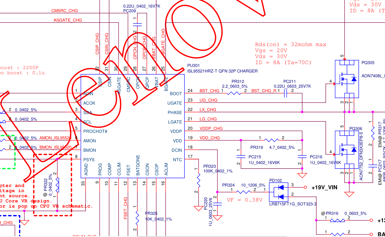

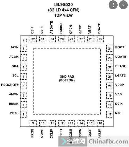

    Re: Charges only in windows and disabling controller
    1) See attached.
    2) This part appears to be available from Mouser and Digikey as well.
    3) ISL95521HRZ seems to have the same pinout.
    4) YOGA 500 uses the same ISL95520HRZ part - attached is a partial schematic from the YOGA
          1) voltage @ ACIN (pin 1 of ISL95520) ?
          2) voltage @ CCLIM (pin 11 of ISL95520) ?
          3) voltage @ ACLIM (pin 16 of ISL95520) ?

                  The CSIP and CSIN pins (32 and 31) seem to be shorted together 0ohm. They come out to a capacitor, one on each side or the capacitor, I don't know if they should be shorted or not.
                  • Sephir0th
                    • Oct 2020
                    • 1262
                    Ignore CSIP and CSIN. The Only component between this Rails is the Current Resistor, If i'm right.
                    I'm more interested in your ACIN Voltage. Check which Voltage do you get there with battery only too. I believe It's supposed to be 19V, i mean the equivalent charger Voltage, there.
