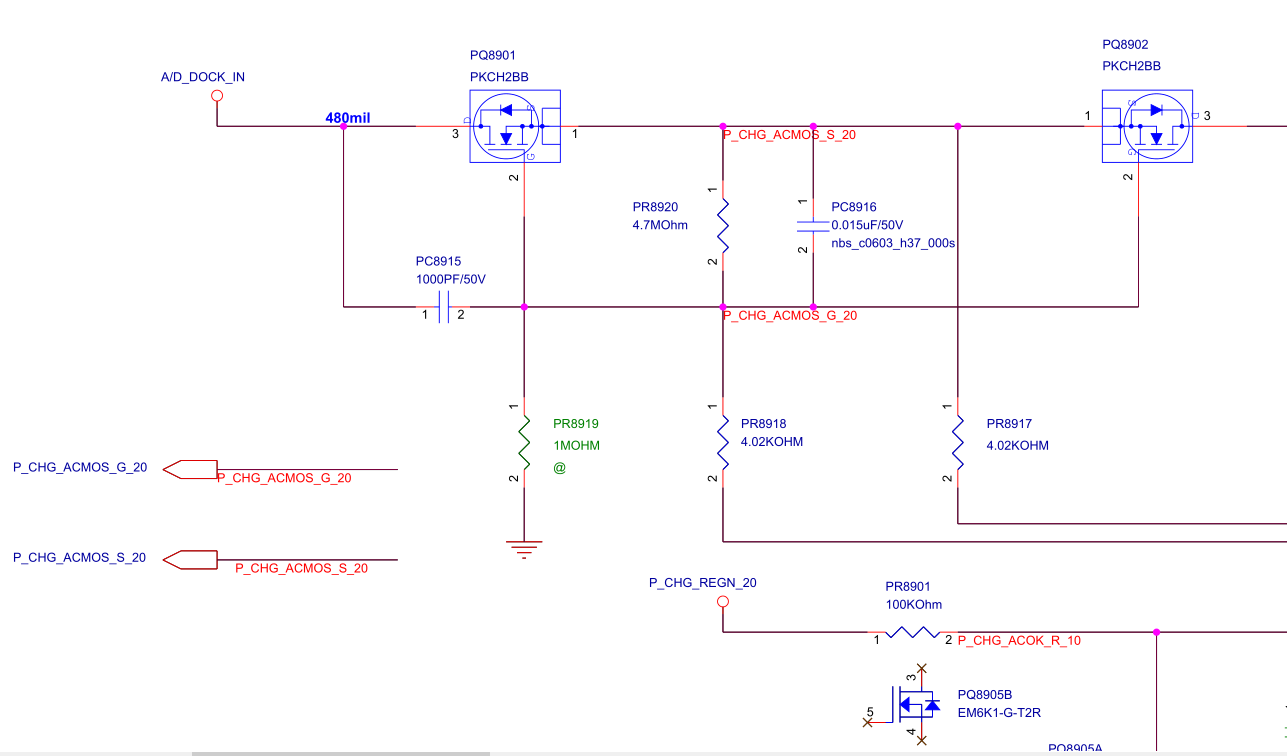

    I have this motherboard from the title, there is no schematic or boardview.
    When i apply the adapter nothing happens, no lights, only little buzzing noise but adapter is not going to protection mode. Later i check and on first power mosfet there is 19,3 v but later nothing (it is not opening)....Then i check again and every time i apply the adapter it will open the second power mosfet but voltage is just droping...9v...6v...3v...0v
    So, i believe the power main controller is closing power mosfets and going to protection mode because ther is a short somewhere in lower power lines?
    I checked i believe every coil and most of the current sense resistors and joints but i couldnt find anywhere short to ground.
    I have lab power supply and i was thinking to inject voltage/amper but i am not sure how and what? so can anyone help me because i am new in repairs.
    So what is obvious is that i will not inject 19volt on second power mosfet because the "protection mode" is activated for a reason and i will probably burn something.
    Can someone help me what voltage and amper should i inject and where to to find a short?
    Thank you!

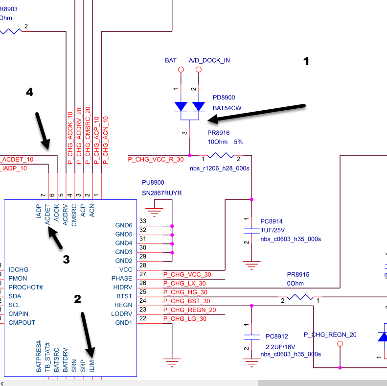

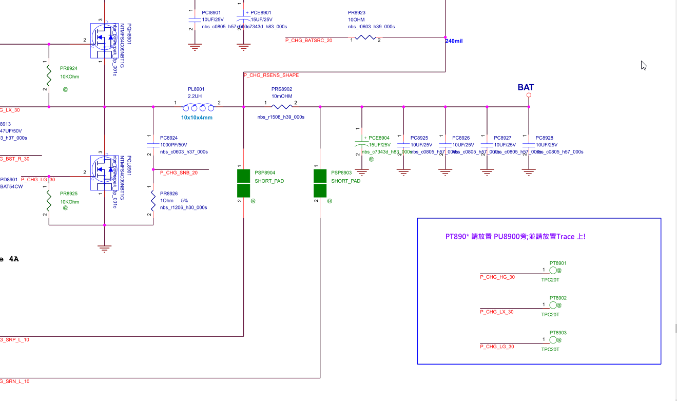

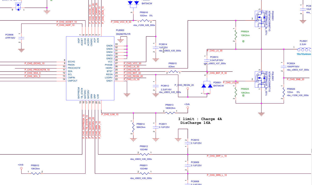

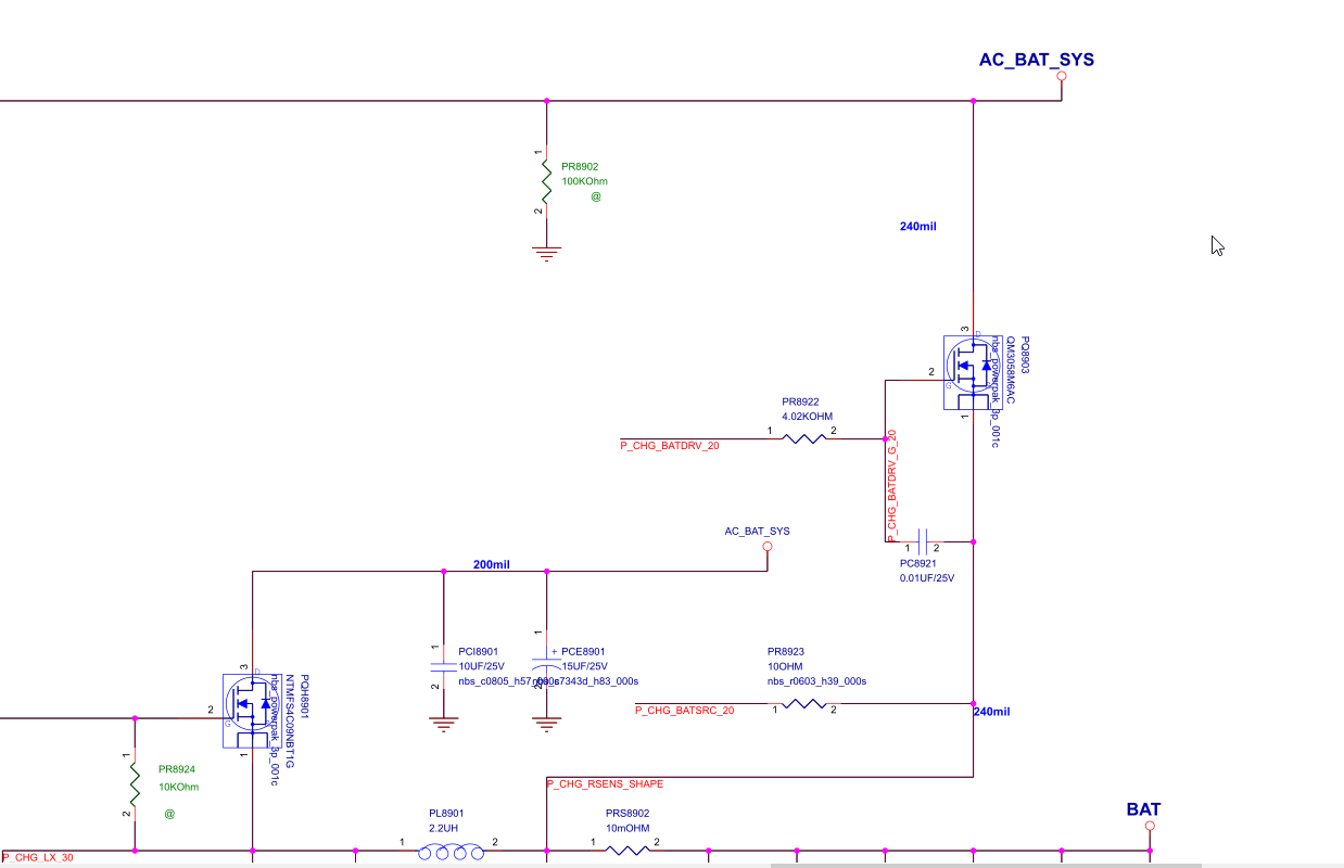

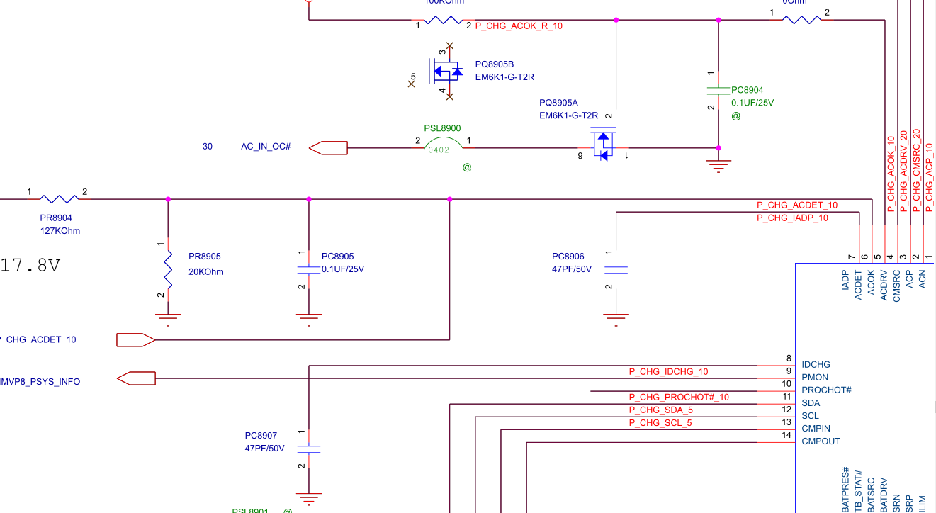

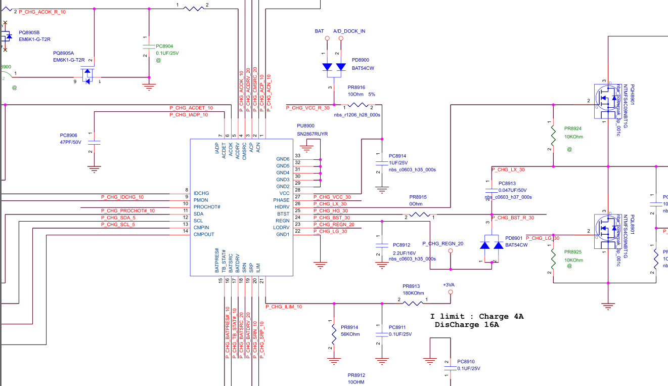

        Post the details (pics) of the IC linked to the DCIN mosfets. Then we can perhaps study a reference schematic from datasheets (if public) or another laptop example circuit.
        Never mind - found some details. Will post them in a few minutes...
        • mon2
          • Dec 2019
          • 14415
          Re: asus gl703gs detecting short
          more.
          Start with:
          1) voltage @ attached locations.

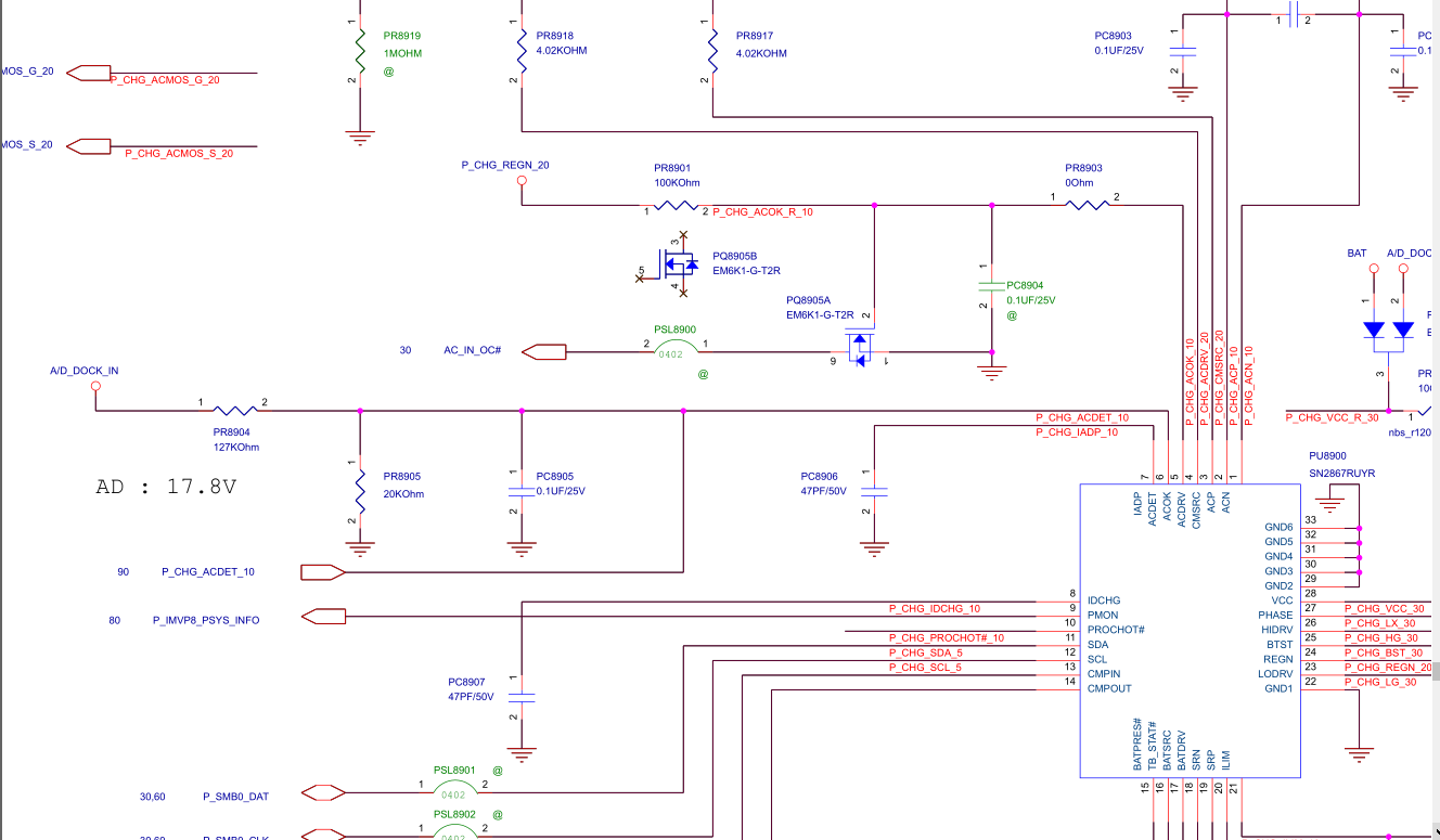

            1. a/c dock in 19,6 v
            2. Ilim 0,1 v. sometimes 0,3v dropping to 0,2v
            3. acdet 2,68 v
            4. acok 5,92 v

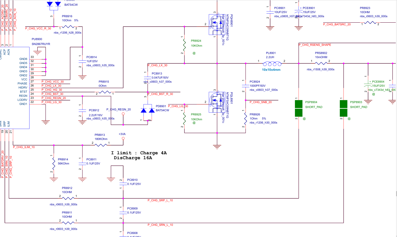

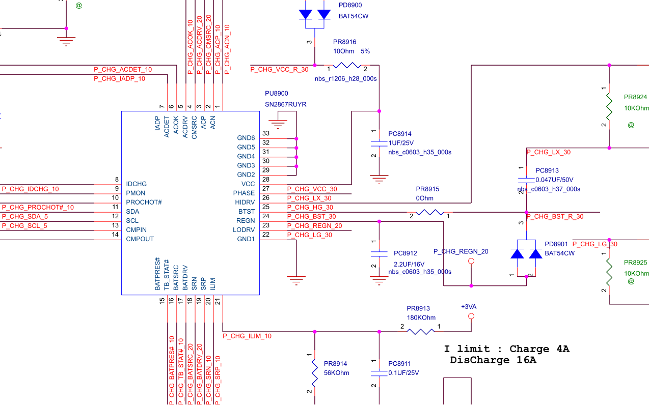

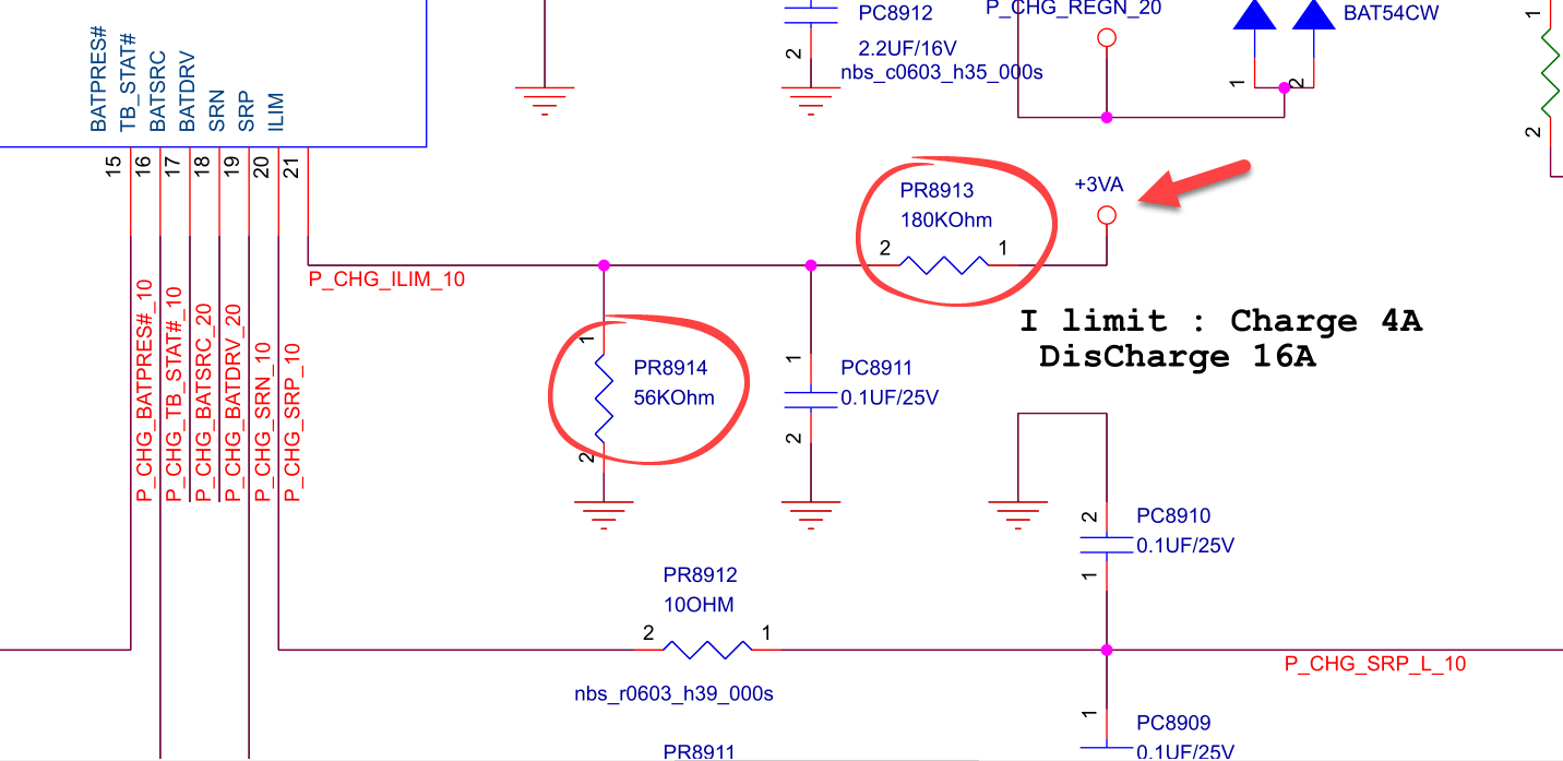

              The current limit value is not correct. Pin # 21 must be a higher voltage value as it sets the max current that will be allowed to be supported by this regulator. You presently have close to 0 volts so this IC will be in shutdown mode.
              Review the attached and power down:
              1) meter in resistance mode, check the resistance for the 2 resistors that create this resistor based voltage divider.
              Resistance of PR8913 ?
              Resistance of PR8914 ?
              2) meter in volts mode, check the voltage on PR8913, pin # 1.
              This must go to +3VA.
              Post the values.
              • prow
                • Jul 2020
                • 14
                • croatia
                Resistance of PR8913 ? 62 kohm
                Resistance of PR8914 ? 44 kohm
                PR8913, pin # 1. - 0 vol
                • mon2
                  • Dec 2019
                  • 14415

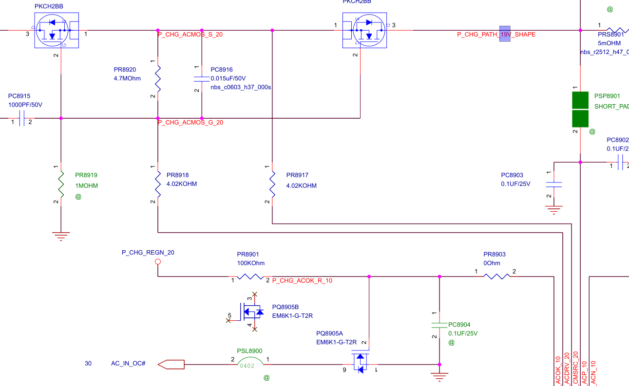

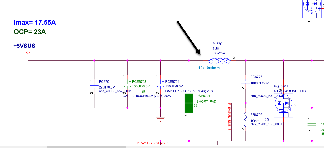

                  Ok.

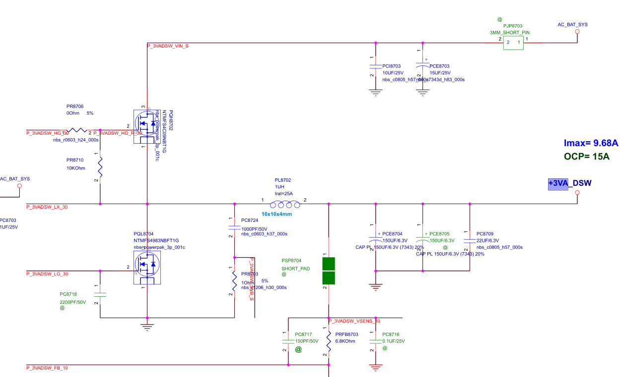

                  1) Both resistors are of the wrong value. They should be replaced. It is possible that the resistance values are incorrect as they are in circuit vs. being removed and then measured. You can consider to carefully remove onto one pad and take their measurements again but the parts are very low cost and should be replaced.
                  Arrow has them and they ship worldwide.
                  2) The +3VA rail is not working.

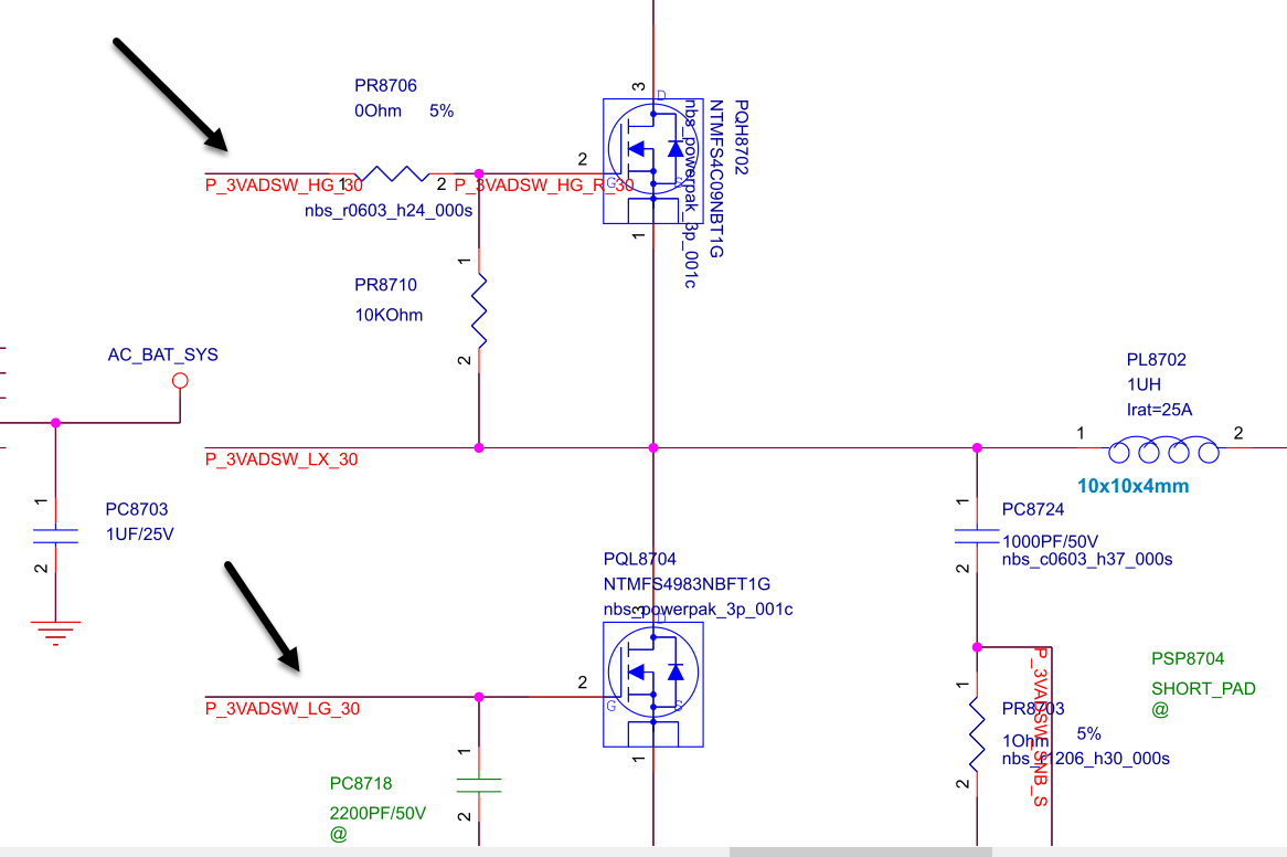

                  3) Voltage on PL8702, pin # 2 ?
                  4) mosfet gate voltages for the attached test points ?
                  P_3VADSW_HG_30
                  P_3VADSW_LG_30
                  5) Voltage on PL8701, pin # 1 ?
