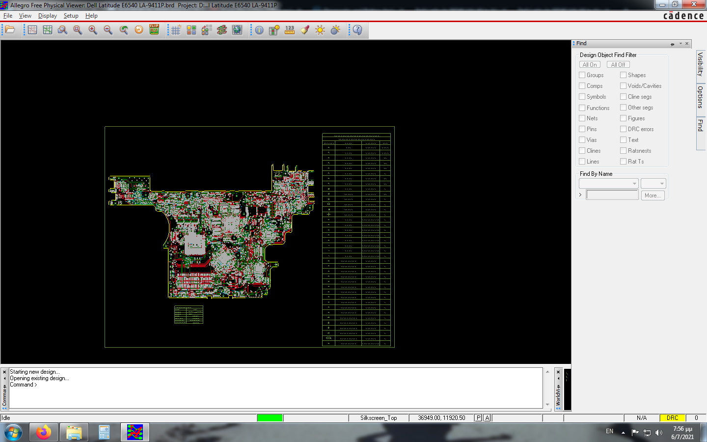

    Re: Dell E6540 No RAM detected.

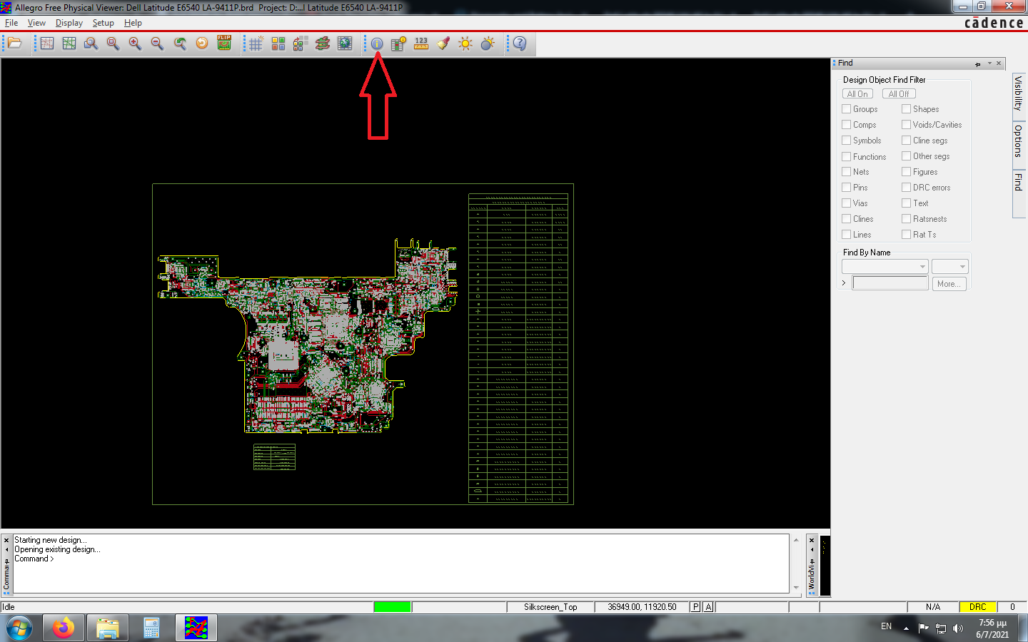

    It is greyed out when i open it, can't type of tick anything.
    In your computer is working?
    • Spider1211
      • Oct 2019
      • 532
      • Mauritius
      #62
      Yes, working fine on mine. You seem to have other layers turned on as well. Maybe try disabling a few?
      • Andreasbest
        • Aug 2014
        • 1196
        • Hellas ( Greece )
        #63

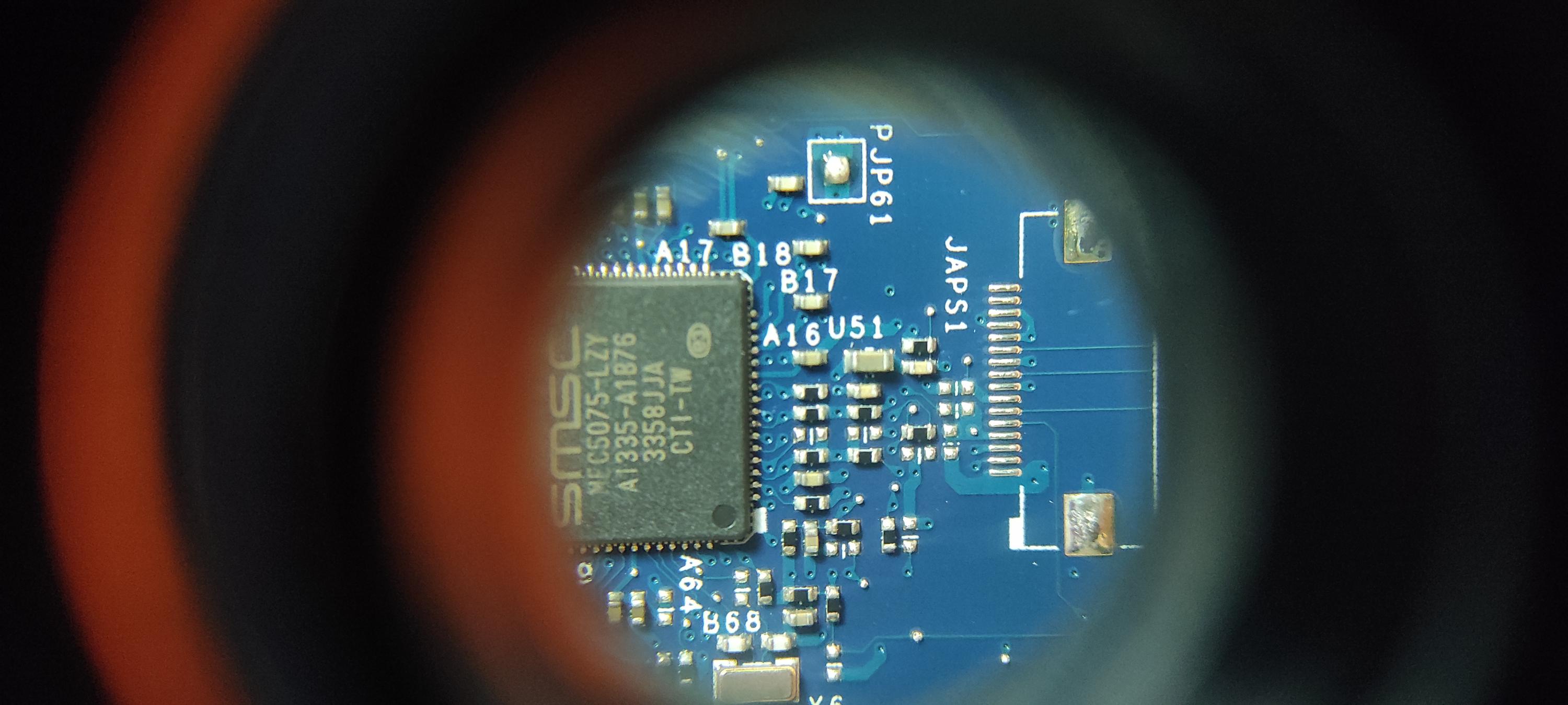

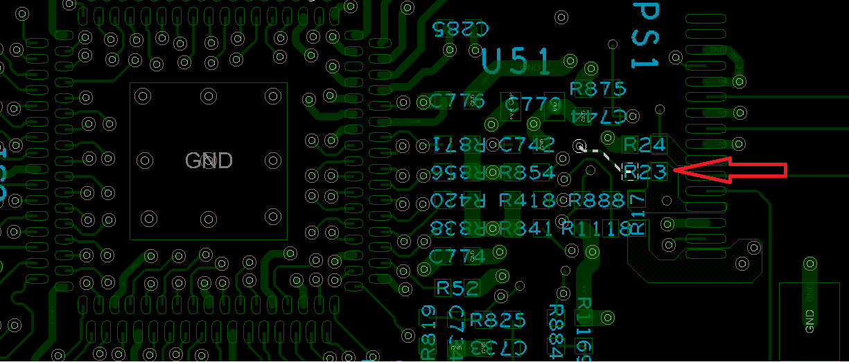

        In Visibility i enabled only what you told me now, still the same. Can you please check where R23 is and upload it? it will be easier than fixing the program.
        • Spider1211
          • Oct 2019
          • 532
          • Mauritius
          #64
          There you go.
            Unfortunately is missing and trace is solid, no cut.
            • Spider1211
              • Oct 2019
              • 532
              • Mauritius
              #66
              That's fine, R23 is supposed to be a short anyway. In this case a trace is used instead of a jumper resistor. Check the schematic, its an underline resistor.

                                Can you please show me PR206 location?
                                Also please tell me which version of Allegro Free Viewer you work?
                                • Spider1211
                                  • Oct 2019
                                  • 532
                                  • Mauritius
                                  #76
                                  Am using version 16.6
                                  https://www.alisaler.com/category-laptop-boardview/
                                  Try this: after setting your layers, click on "Show Element" in the upper taskbar, that should enable the "find" menu. (see attached edit from your previous post).
                                  • Andreasbest
                                    • Aug 2014
                                    • 1196
                                    • Hellas ( Greece )
                                    #77
                                    Ok got it enabled now
