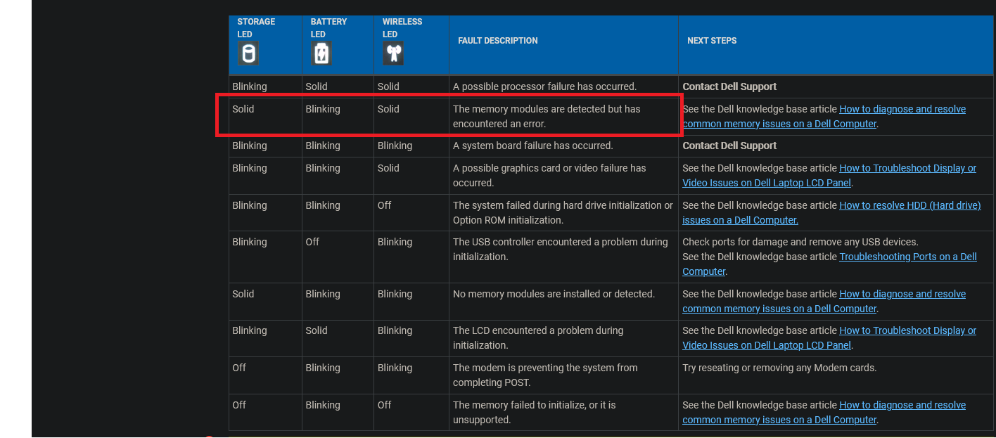

    Hello.
    I bought a faulty E6540 recently that is in great cosmetic condition so i decided to give it a try.
    For some reason the MB doesn't detect RAM properly, the Battery led blinks while the wifi and hdd activity are solid, according to Dell page *1 that means RAM detected but there was a "error".
    What have i done so far:
    1) I tried multiple RAM modules that work fine on other E6540 that i have here.
    2) I flashed two bios. One from SMDFlea in this thread *2 and one from a E6540 that have here and work great, bios version A27.
    3) I flushed CMOS (removed all batteries and charger, pressed power button for 20 secs)
    No luck at all, the same behavior continues so any help is appreciated
    Thank you in advance!
    *1 https://www.dell.com/support/kbdoc/e...ps-and-tablets
    *2 https://www.badcaps.net/forum/showpo...49&postcount=6
    Schematics attached.

      Hello.
      The blink sequence is Solid Blink Solid, check the attachment.
      Without memory i get the usual sequence of "memory not detected" so it's reacting to memory installation.
