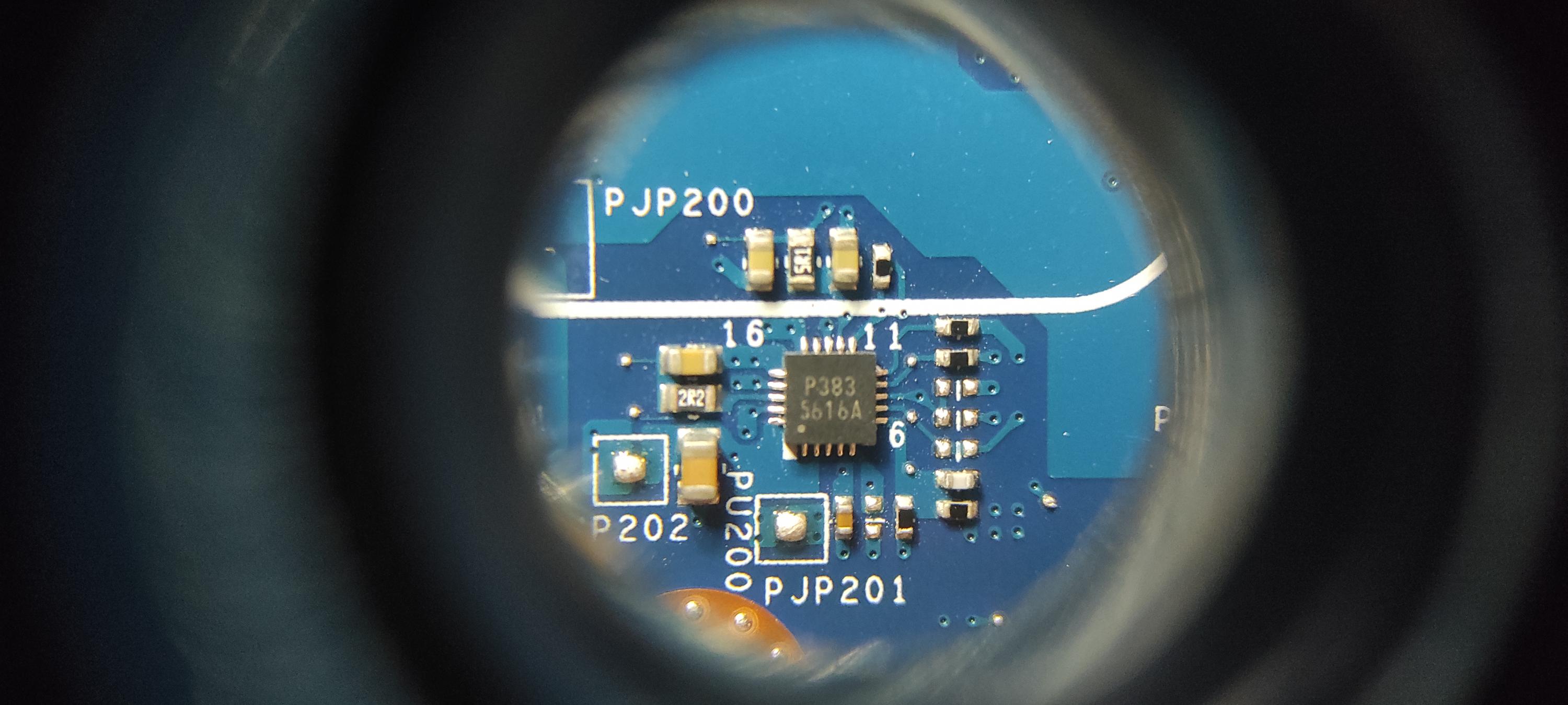

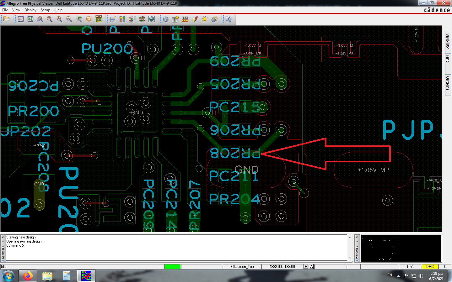

    Yes that's what i'm telling.
    The boardview shows the PR208 is in the 3rd SMD position from the bottom but as you can see is the actual photo of the MB it isn't.
    Never soldered, same on donor board.

      Re: Dell E6540 No RAM detected.
      It shouldn`t be populated. The resistor icon is underlined,that means its a solid pcb track ,you can see it on your picture,theres no break in the trace
        Yes indeed, 3rd SMD position from bottom has no break in trace. just noticed.
        Good eye mate
          Yes correct, I didnt pay attention to schematic until I saw the picture.
