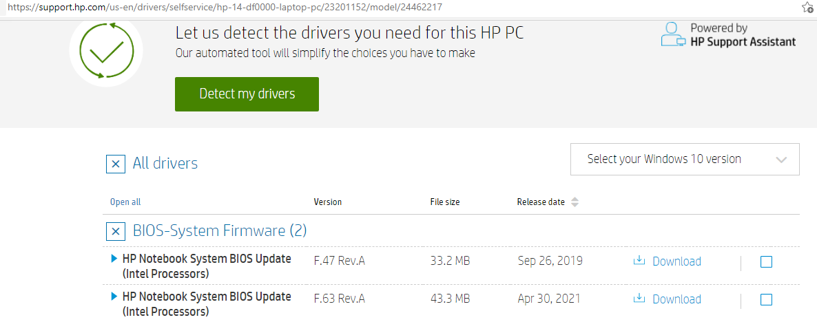

    Hello, everyone! I have come to ask you to enlighten me about a problem with my HP 14-df0016ds notebook ... In an update of windows 10 in 2020 (June) the notebook was left with a black screen ... (the charging led turns on and power button but it does not start absolutely windows, nor does it let me enter the BIOS) ... I downloaded from the hp page, an update that they just did in April of this year ... so I proceeded to make a usb with the flash of the new update of the bios, to see if I could revive it ... (it gets more interesting) I press the combination of keys (windows + B) and the screen works with the image of "downloading new bios" (they appear loading files with a blue bar) ... once it is finished, a countdown appears warning that the notebook is going to restart in 10 seconds to continue the process ... and when it restarts ... the screen returns to black and nothing happens ... THE BIG QUESTION IS ... WHAT DO YOU RECOMMEND ME TO DO? I AM A LITTLE DESPERATE WITH THIS QUESTION .... I thank you very much for the space ... and if you notice that my English is horrible, it is because I am using the google translator XD

            Sounds like you just need to apply the proper BIOS for your unit.
            Can you confirm that you have downloaded the proper BIOS firmware for this computer ?
            Download a fresh copy and attempt to reflash it again. I think you are in a stuck mode where the logic board is unable to boot till the BIOS is corrected.
            If you feel you have the proper BIOS - contact HP to ask about this issue. A suggestion is to consider an older version of the firmware but best to ask HP if this is recommended. I believe that most BIOS firmware is bullet-proof to apply but best to be safe to ask for their advice.
            In attempting to download the BIOS tool from the following HP website - it is an executable that has to run on Windows. This is a catch-22 if you are unable to boot from Windows.
            Is this understanding correct ?
            Share a pic of what you can see upon boot for a review. Is it a USB BIOS update tool of some sort ?

              Re: Problems with my HP 14-df0016ds Notebook (black screen)

                Please confirm:
                1) You are stuck with the screen that only allows you to update your bios ?
                2) Post the full details of which download you used for this BIOS update. Which version? Filename ?
                3) Noting some issues in the posted log.
                2018-01-01 16:44:50 Failed Reading BIOS Signature File HP\BIOS\Current\0849E.sig
                2018-01-01 16:44:50 Failed Reading .sig file. (Not Found)
                4) I think you are not alone with this issue - or is this your post ?
                https://h30434.www3.hp.com/t5/Notebo...S/td-p/8044203
                  Please confirm:
                  no, that's not me ... but from what I see the same thing happens to me, but with another model of hp notebook ... now as soon as I get off work I send photos of what my notebook does ... and then about the hp bios that I download ... do you think so?
