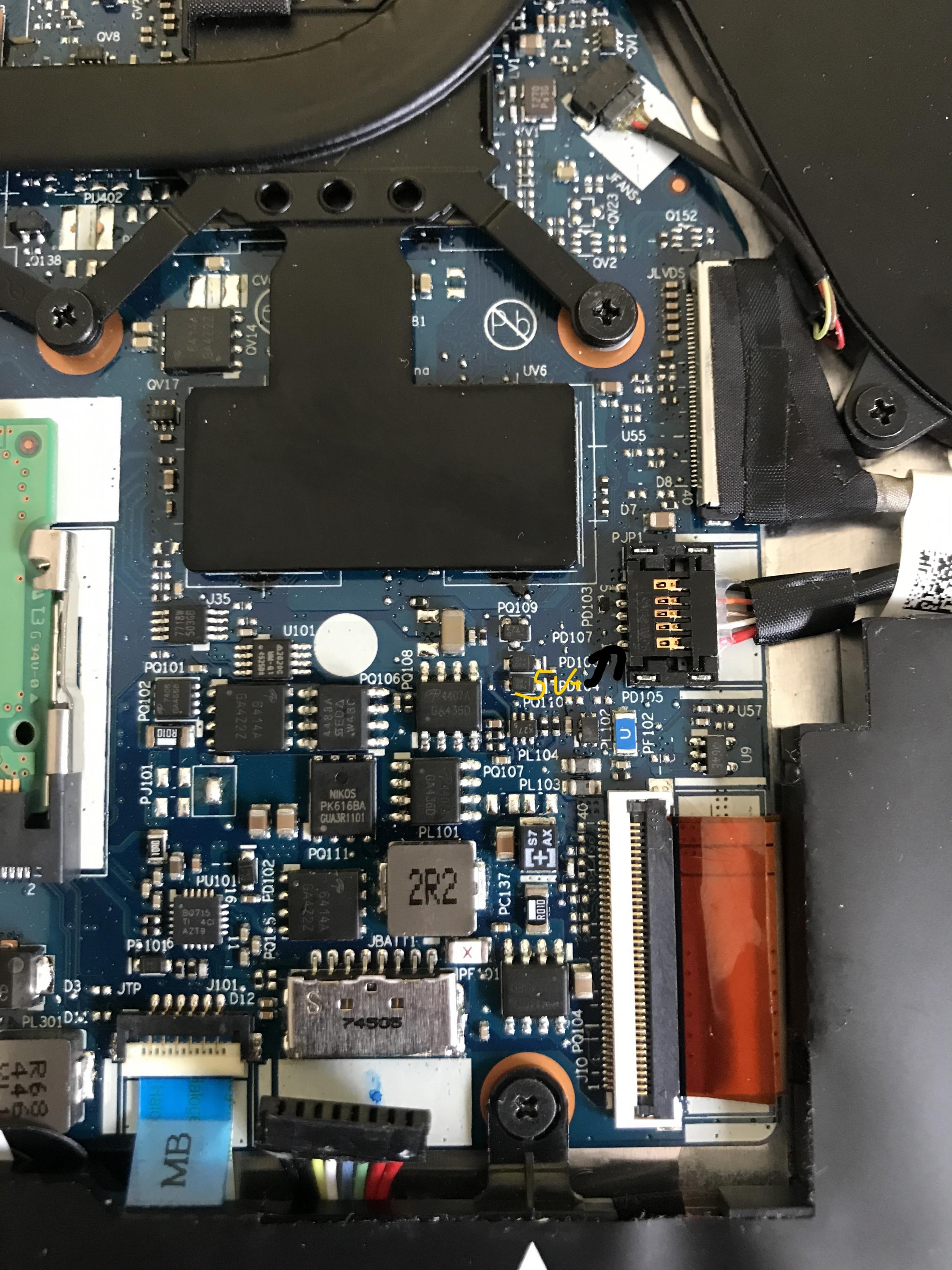

    Hi All,
    Looking for advice on where to start and diagnose the problem to resurrect my laptop.
    I am only getting 5V on Pin 1 (PJP1) when the power is plugged in. It should be 20V.
    Laptop uses funny USB charging port. When plugged in to laptop should recognise and then USB supply 20V, otherwise default is 5V.
    I can order a new power socket or could, but how can I rule out other issues on the motherboard first?
    I have read other forums on here that is similar issue but they are a bit ahead of me in diagnosis.
    Any advice or assistance would be appreciated.
    Attached schematic and board view.

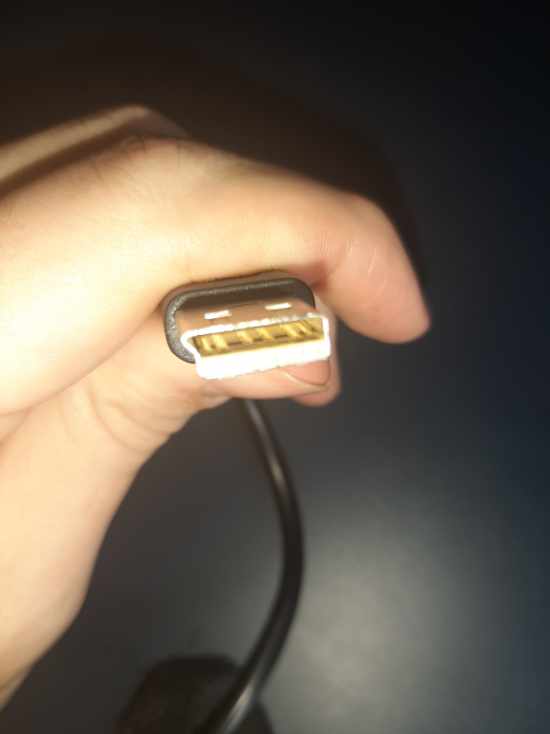

  • Sephir0th
    • Oct 2020
    • 1289
    Re: Lenovo Yoga NM-A381 Motherboard no power, wont turn

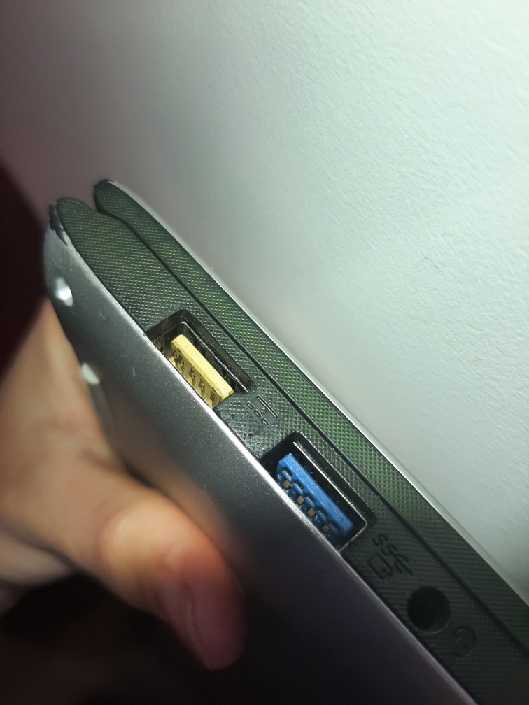

    Check your Charging Port visually and also the Port of the Adapter. I have in Mind it is a square one, yellow colour with a small Triangle (for Not accidentally Plug in another USB-Port).
    Share Pic how it Looks inside
    They're Well known for being physically damaged.
      Probably +3VL are missing due to the kbc (IT8386E-192) being in shot-circuit.
      As Sephir0th mention, the usb port from charger is probably damaged, and trough USB_ID injects 20v. to the IT8386E.
      It is a common issue in NM-A381 motherboard.
      • BumThief
        • Jun 2021
        • 6

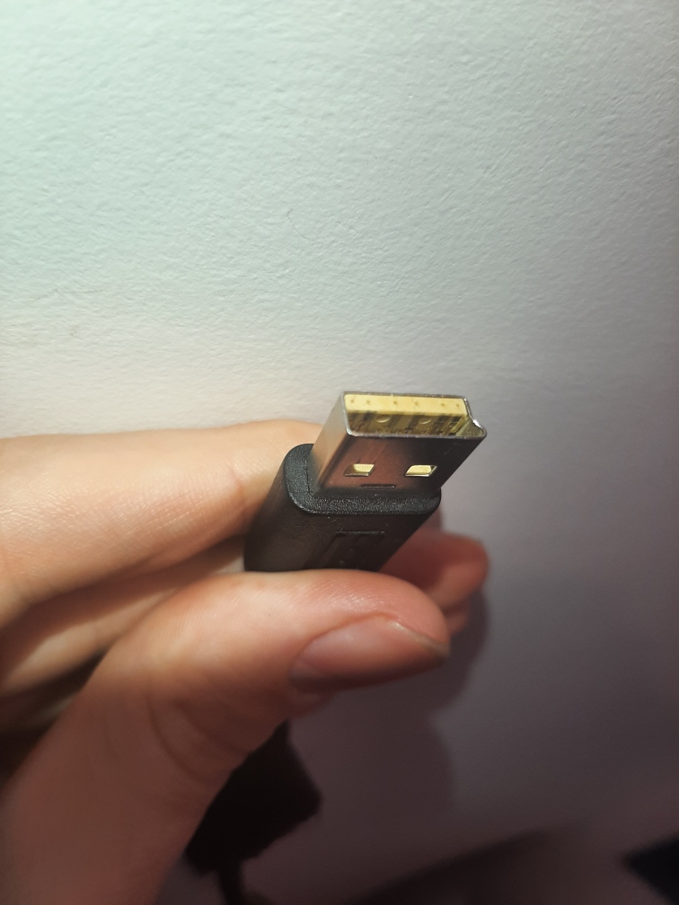

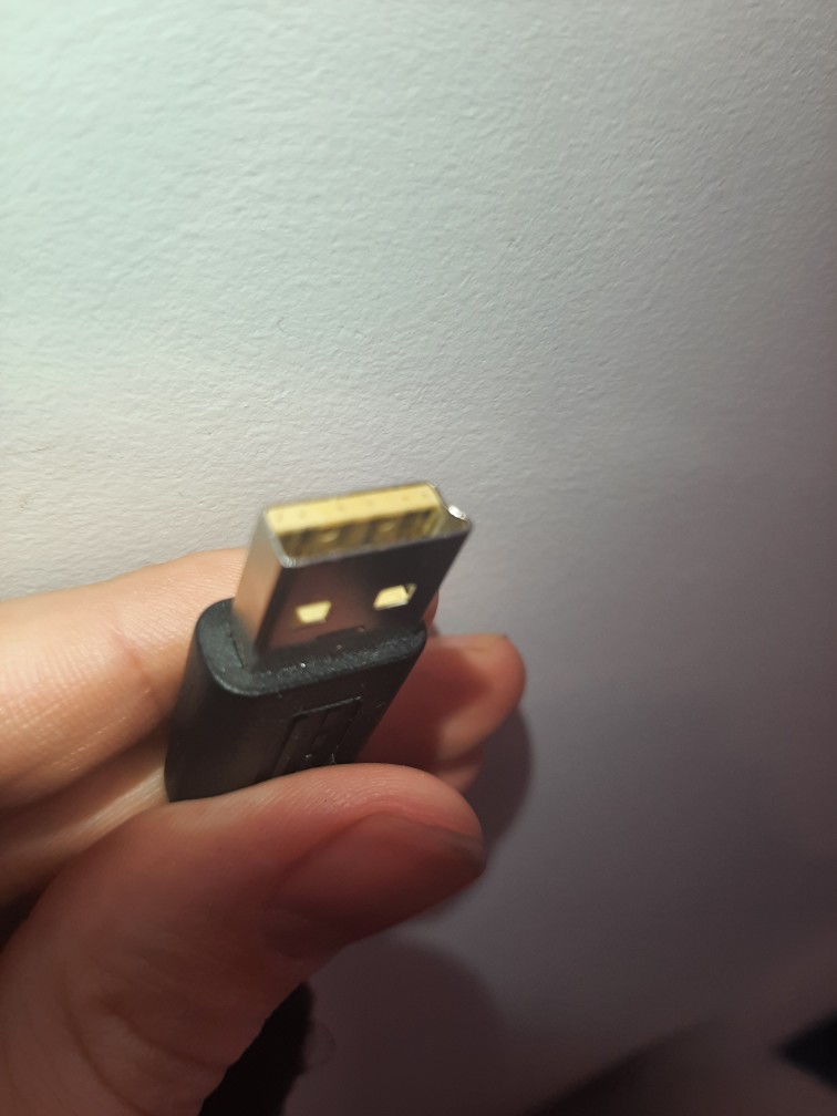

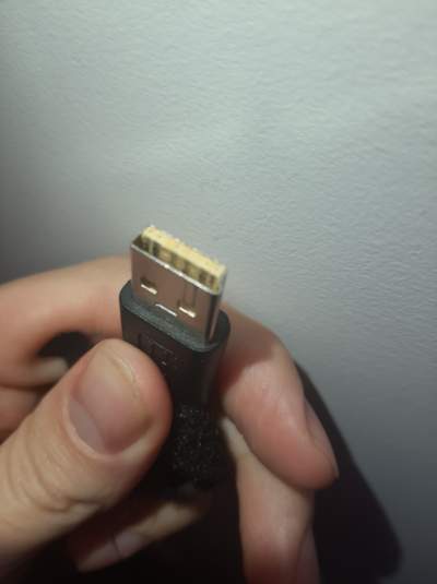

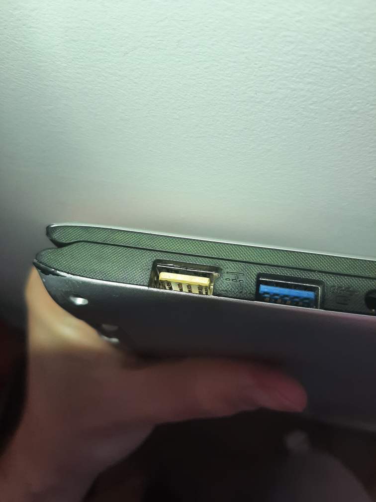

        Hi All,
        Thank you for getting back to me, sorry for delayed reply, tried to get a better camera to take photos but they still look bad.
        Attached photos of cable and socket. I can try get better quality if need be.
        The sockets don't look too bad, there are marks from general use it seems. Nothing out of place and pins don't look damaged.
        If IT8386E-192 is short circuited, would I have to install identical one (IT8386E-1502-192)?
        Or can I use any IT8386E-XXXX-192?
        Kind regards
