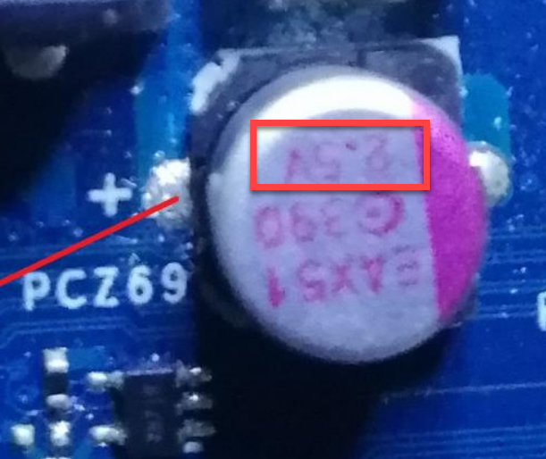

    This Laptop came in no power condition.
    When I checked 3v & 5v only come after press power key.
    But after few seconds it is going to zero. Then I checked voltages of 3v/5v driver IC. Problem is ENABLE signal is going to after few seconds.

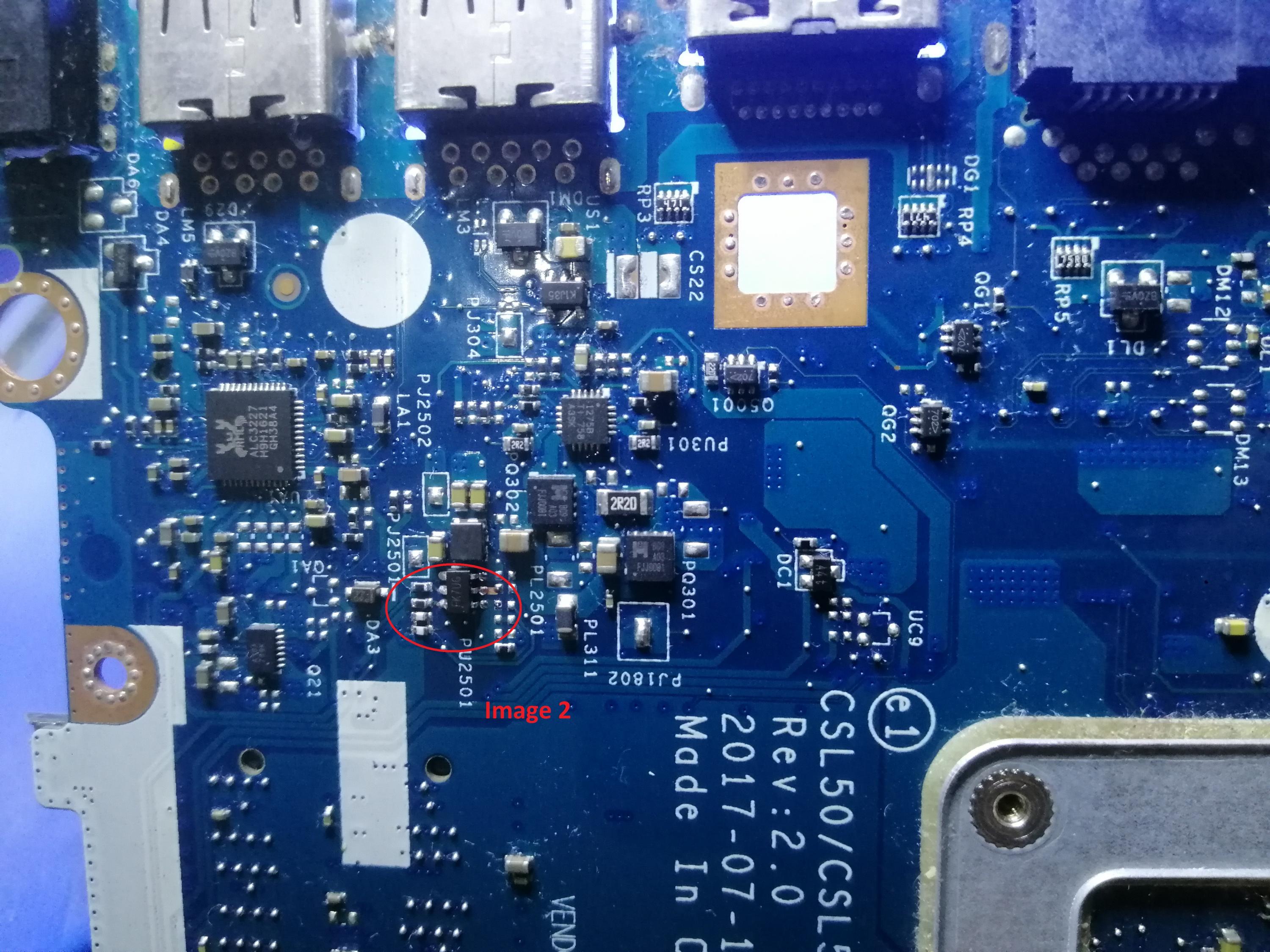

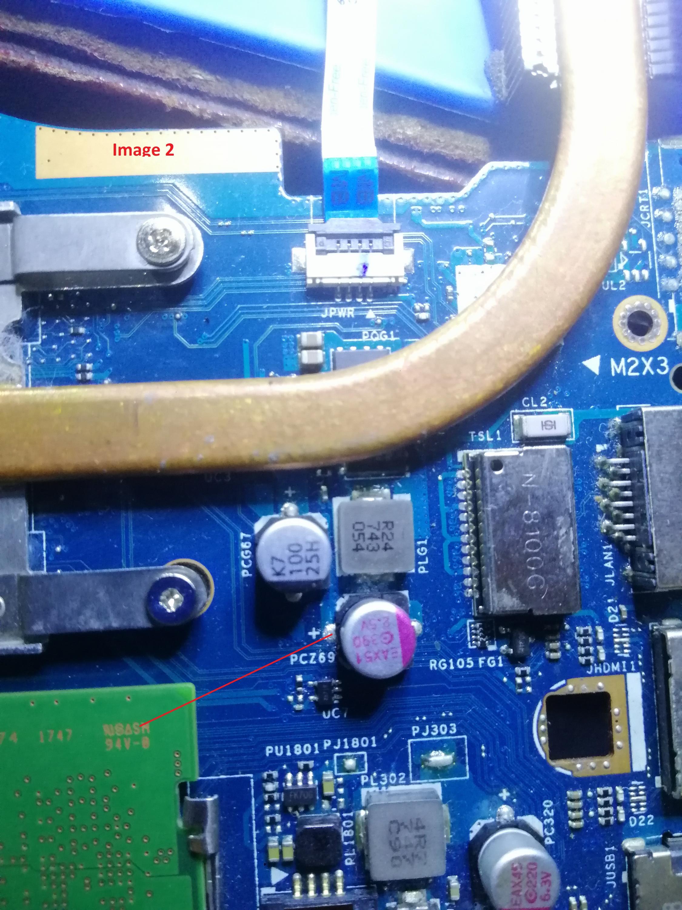

    One place of PCB have a Corrosion & I cleaned that place & re-soldered that components. (Image 1)
    After it after it all voltages are present without one place.
    I don't know that place have voltage or it's value(PCZ 69).(Image 2)
    Now board problem is no display.
    Anyone can tell what is the voalyage of that place or what I need to check?

    Re: HP 15-BS588TU No Power ON
    hi. see attached.
    voltage = 2v5 = 2.5 volts.
    capacitance appears to be 390 uF.
    The color of the cap denotes this is not a standard cap but one with higher current rating. Difficult to say what is the exact current rating but source one that will fit this SMD pad location and one that is the highest current rating you can buy.
    Perhaps others can share their advice.
      Originally posted by mon2
      hi. see attached.
      I asked about actual voltage of this point. I mean out put voltage of this buck converter. Not about capacitor.
        Trace the cap and local coil to the mated regulator ic.
        Remove this regulator ic. Post the markings on this regulator.
        After the removal, post the voltage on each regulator pin.
        With the voltage input and feedback resistor voltage divider, it should be possible to calculate the Vout.
        Will help if the voltage feedback resistor values are posted.
