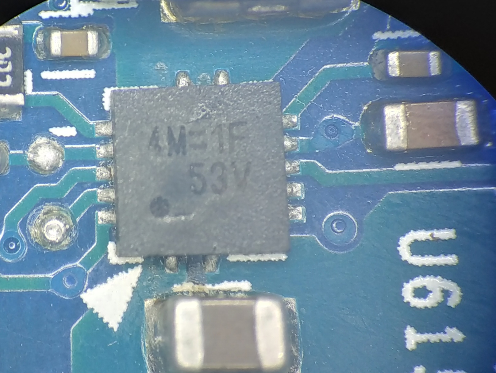

    I am fixing an hp elitebook g2
    And a chip is burned.
    The code is 4m=1f
    Dose anyone know what kind of ic is this?
    I attached an image
    Thanks for your help

    RT7291BGQUF
    https://cdn.badcaps-static.com/pdfs/...b4c05f1a43.pdf
