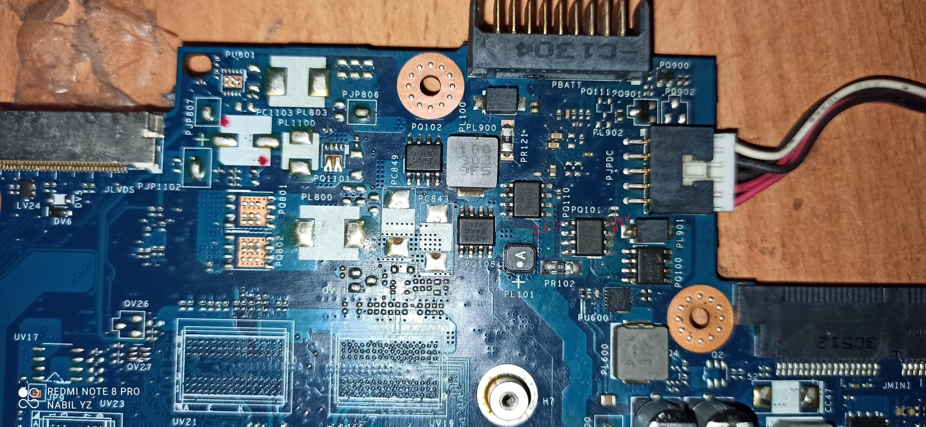

    hey all
    i have dell 3521 la9104p he work only on battery and when i remove the battery and try o turn it on with charger he work for 2 seconde

    Voltage on pin 4 of PQ100 ?
    Voltage on pin 4 of PQ101 ?

      pq100 pin 4 0v and i all ready change it and when i nject 19v to pq101 he dosent turn on at all

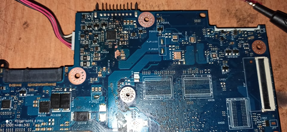

        check the pic

          probe ISL88731 pins

            solve by changing some resistance close to ic isl
