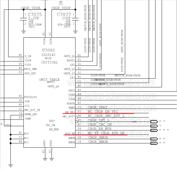

    Have a macbook A2159 - board number 820-01598 that needed to have U7000 replaced. When I lifted the old chip, I lost two pads. I think I may have been lucky with which pads I lost, but wanted to make sure before soldering on the new ISL. Pads lost were 27 and 28 (on boardview) / F2 and F3 on schematic and are listed as:
    - F2: NC_CHGR_EN_VR1
    - F3: NC_TP_CHGR_AUX_OK
    Because these are noted as "No Connect", is there any point in me trying to salvage the pads or can I leave them alone and attach the new ISL as is?
    Any suggestions or guidance is appreciated.

    Re: Macbook A2159 820-01598 ISL Pads
    Searching for the missing pad net names came up empty. They are indeed no connects (NC). You should be ok to leave them floating.
    The part is a tiny bugger (WLCSP package) so approach with patience.
      Awesome - thanks for the reply. Would there be any harm / benefit to grounding them? That way I wouldn't have to worry about the solder balls running away or potentially bridging with nearby balls when flowing the new ISL?
        Never mind about connecting them to ground. Some basic research resulted in a resounding no. Will go ahead and float them. Thanks again!
          Just leave them as no connects. I think the balls will melt and become like a soft pillow with no mating pad but then should solidify when cool. Don't think they will float around due to the isl9240 having a pad for each on its belly. Do not short to other logic or ground as we do not know how these pins will react.
