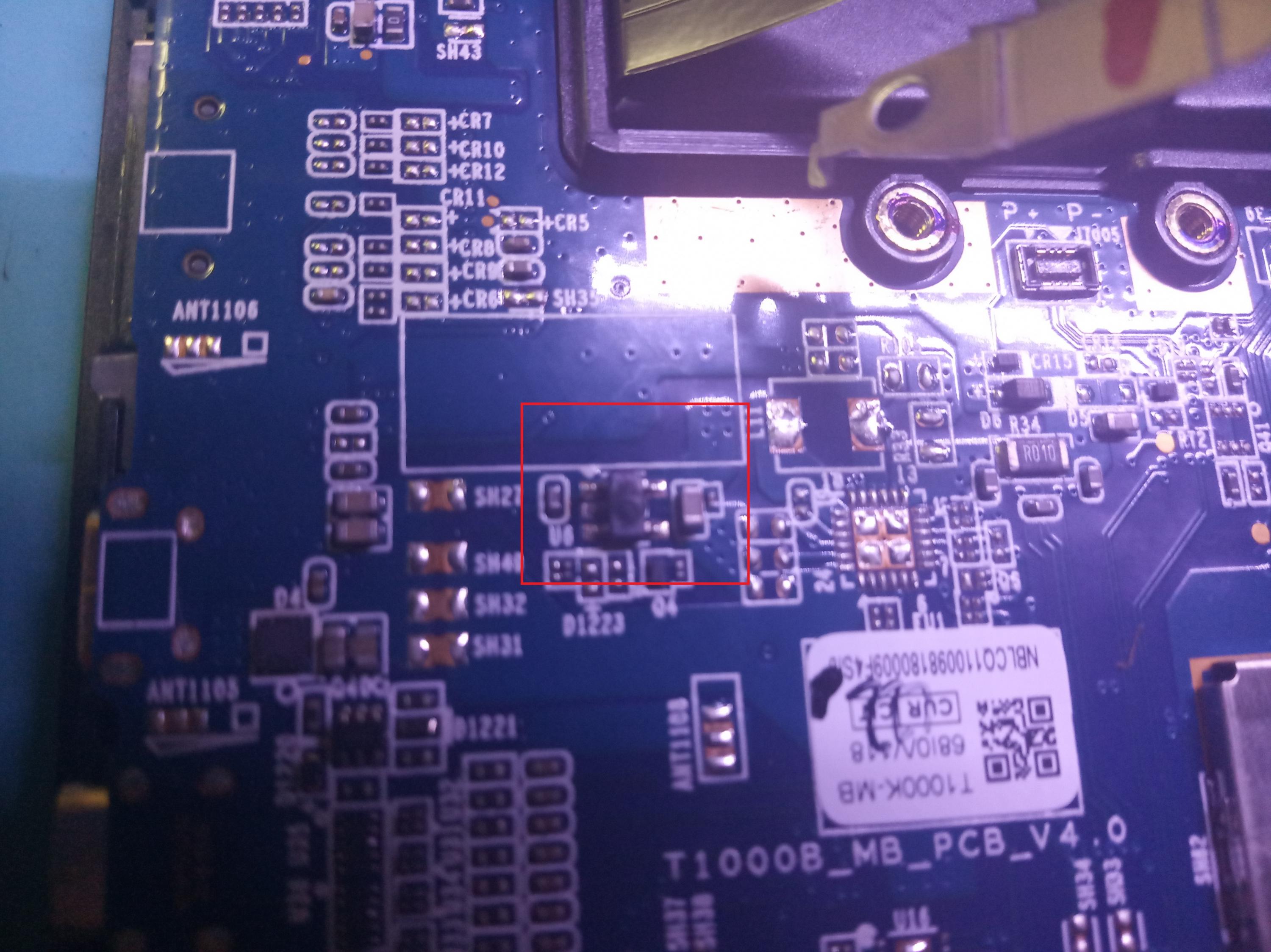

    T1000B_MB_PCB_V4.0 Help dentify IC
    Hello, It's me again need help to identifi burn iC
    This IC is burn, and i didn't find the datasheet on google.
    Marking Code : 51CA

    Re: Help dentify IC
    Hi. From which brand / logic board ?
      • 21914
      Re: Help dentify IC
      From the picture the mobo part number is T1000B_MB_PCB_V4.0 ,its used in the ACER ONE 10 N16H1 and Acer S1003. There`s no schematic available
        • 21914
        Re: Help dentify IC
        It might be a GMT G5111 T11 https://cdn.badcaps-static.com/pdfs/...6417180460.pdf

          Re: Help dentify IC
          Sorry late to response, that IC from acer one S1003 board T10003 like SMDFlea said.
          @SMDFlea Thanks for the datasheet. I'll try replace with the IC
