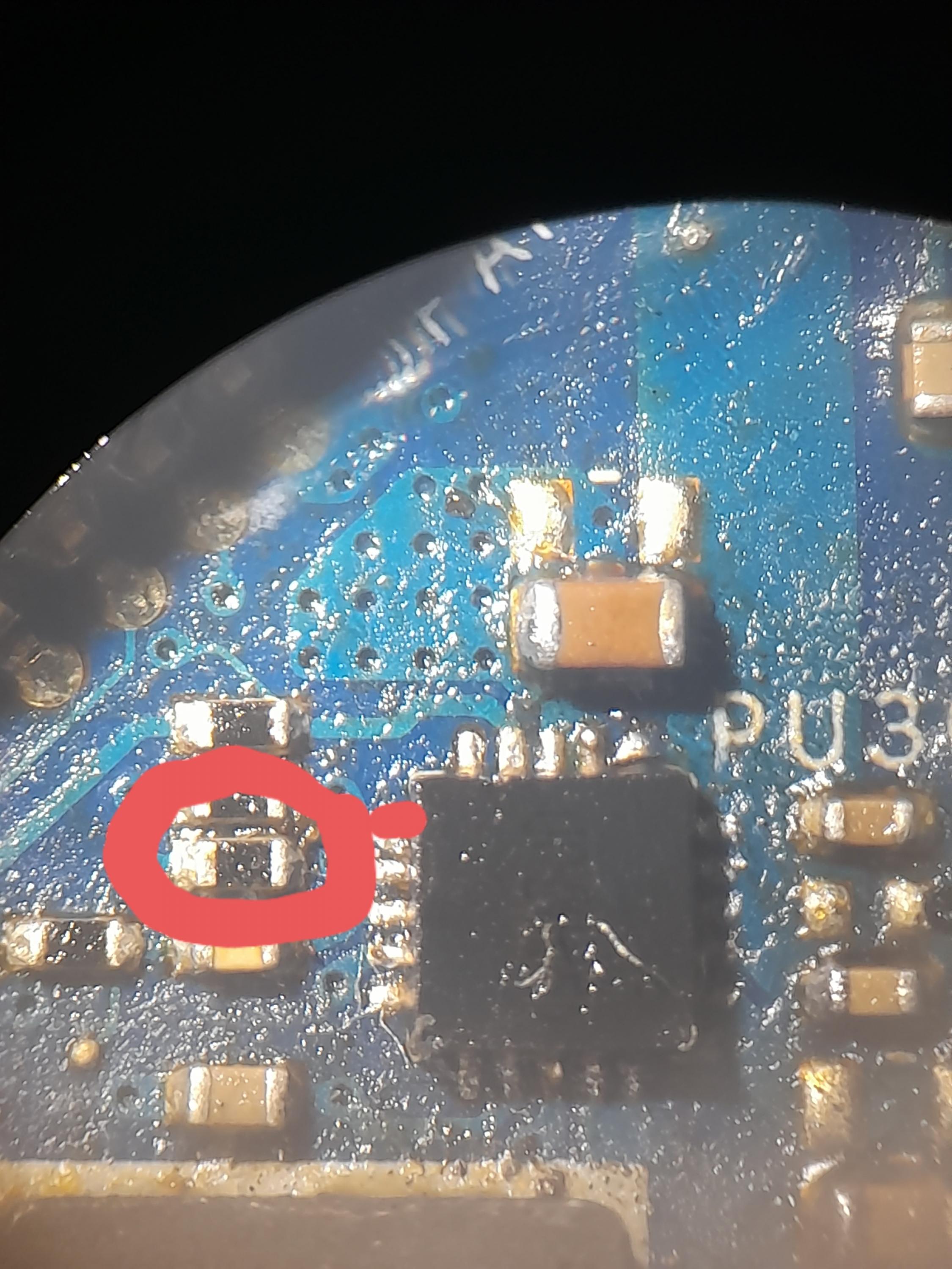

                    • String2016
                      • Nov 2015
                      • 2238
                      • philippines
                      Re: Acer nitro a515 dead
                      does this two resistors connected to pin 11 of pu301?
                      • Sephir0th
                        • Oct 2020
                        • 1283
                        Yes they do with one Side. You could try "beep mode" of Multimeter. And regarding your PN. atm i have No Access to the bureau, so i can't Check for you until this evening.
                        FairRepair on YouTube
                        • String2016
                          • Nov 2015
                          • 2238
                          • philippines
                          i found it beeping on pin 11 of pu301 here is the image and it measures only 120komhs
                          • Sephir0th
                            • Oct 2020
                            • 1283
                            Other Side of this Resistor is connected to GND? Should be PR302 then and also fine. If you want an exact measurement, you have to lift the Resistor from one Pad.
                            Tbh i'm actually more interested in PR301 which is connected to 19V-Rail
                            • String2016
                              • Nov 2015
                              • 2238
                              • philippines
                              the second resistor on the pic which one side is connected to ground
                              • String2016
                                • Nov 2015
                                • 2238
                                • philippines
                                does this first one resisitor on the pic is the pr301?does this bad?
                                • String2016
                                  • Nov 2015
                                  • 2238
                                  • philippines
                                  the second resistor also the other side is connected to vin of the ic pin2-5
                                  • Sephir0th
                                    • Oct 2020
                                    • 1283
                                    I'm Not convinced you found the right Resistors. Share clear Pic of this area without your markings and where i can clearly See the rails.
