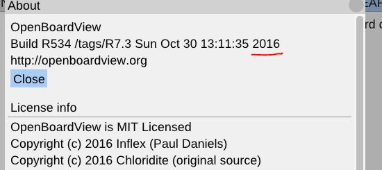

    Looks to be the same format as Landrex TestLink (used by Apple) and opens fine with OBV and FlexBV here.
    I thought the crappy software looked somewhat familiar, its a long time since i used landrex.Don`t know why it wouldn`t open with OBV.
    Edit: Just updated to openboardview 8 and it opens ok,my AV software has been deleting newer OBV versions,never noticed.The old version was from 2016

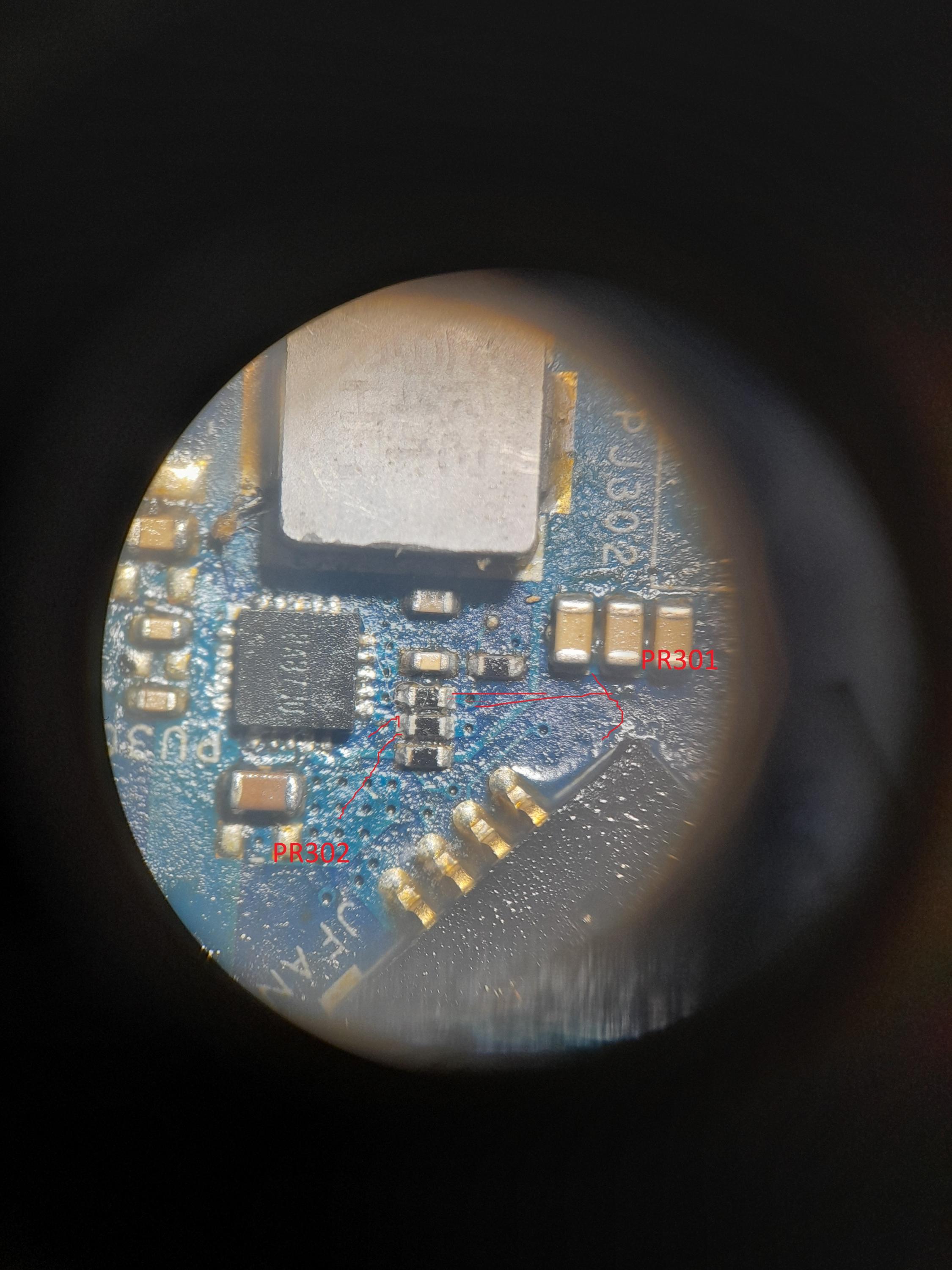

      I found the pr301 and pr302 PR301=151K supposed to be 499k based on schematics on PR302=114K supposed to have 150k
      • Sephir0th
        • Oct 2020
        • 1262
        Re: Acer nitro a515 dead
        First Check Voltage both Sides of PR302. Did you Lifted the Resistor from at least one Pad before Measuring Résistance?
        Your PR301 Resistor is connected to Pin12? Then it isn't PR301...
        Come on, do the Job and find the Resistors.

          The pr 301 is not coinnected to pin12 and connected to pin11 i measure both without lifting the resistor one side. the voltage of pr 301 one side 19v other side 4.45v the pr302 one side no voltage one side 4.45v, base on the boardview that is the resistor

            Then we succesfully double-checked, you get the ENABLE Signal. You shared you have No Voltage there before.
            Now Remove Power and Check Inputs and Outputs of the Controller for Short to ground. Also Check voltages again. When LDO still isn't present but No short anywhere, the Controller should be dead.
