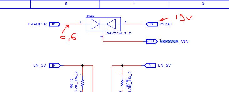

    BAV70W dios replacement
    HP 250 g1
    the laptop dead has many shorted components
    i solve the short
    but i have burned diod BAV70W fast switch diod
    now the laptop not turning on without this dios because this diod generates VRP5V0A_VIN
    in this case what can i do any idea .
  • kiwin
    • May 2021
    • 11
    • Russia
    Re: BAV70W dios replacement
    For further repairs, you can temporarily put a diode with VBAT on VRP5V0A_VIN to supply power to the PWM of the standby power supply.
