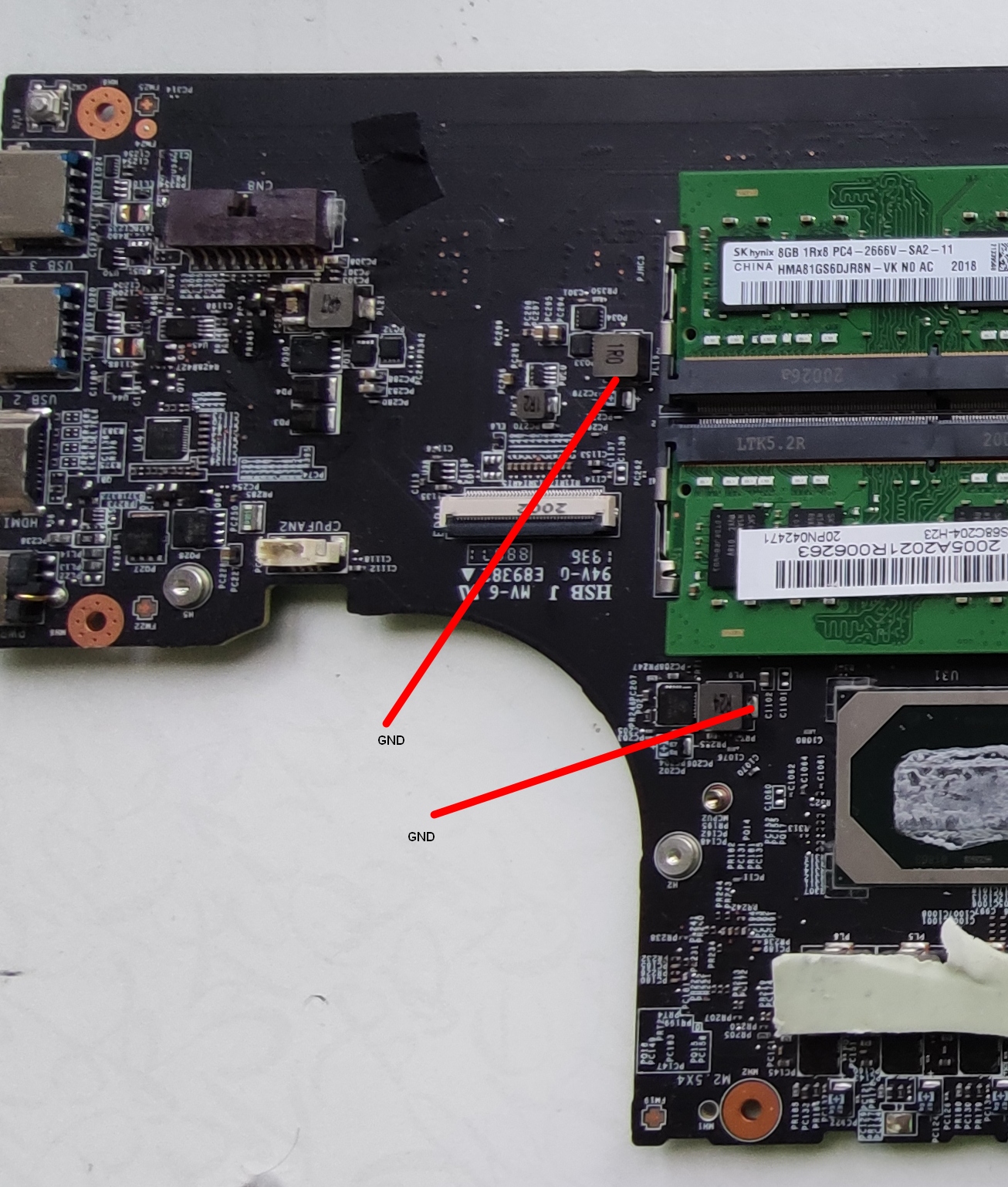

    You may be asked to measure the resistance of these chokes to ground.
    Otherwise, it is very low on my board. PL19 = 1.5 Ohm, PL 9 = 3.4 Ohm.

      You dont still have this board by chance do you ? I had PC227 pop off (Yea,I screwed up, she went flying)
      Any chance I can get a spec on that?
      • mon2
        • Dec 2019
        • 14677
        Re: Msi creator m17 no power (MS-17F31 )
        PC227 is camped onto the main power rail (SDC_IN) - according to the boardview file.
        The value will not be critical but voltage must be equal or higher (recommended) than the max voltage for this rail.
        Measure the pad to pad distance of the PCB pads. From a quick review, appears to be 1206 in size for the SMD component size.
        So 22uf / 47uf 25V or higher cap should be fine here. It is a bulk capacitor to filter the ripple on this power rail.
        If possible, measure with a micrometer so we can be sure of the body size. Digikey / Mouser / Arrow will have these parts.
