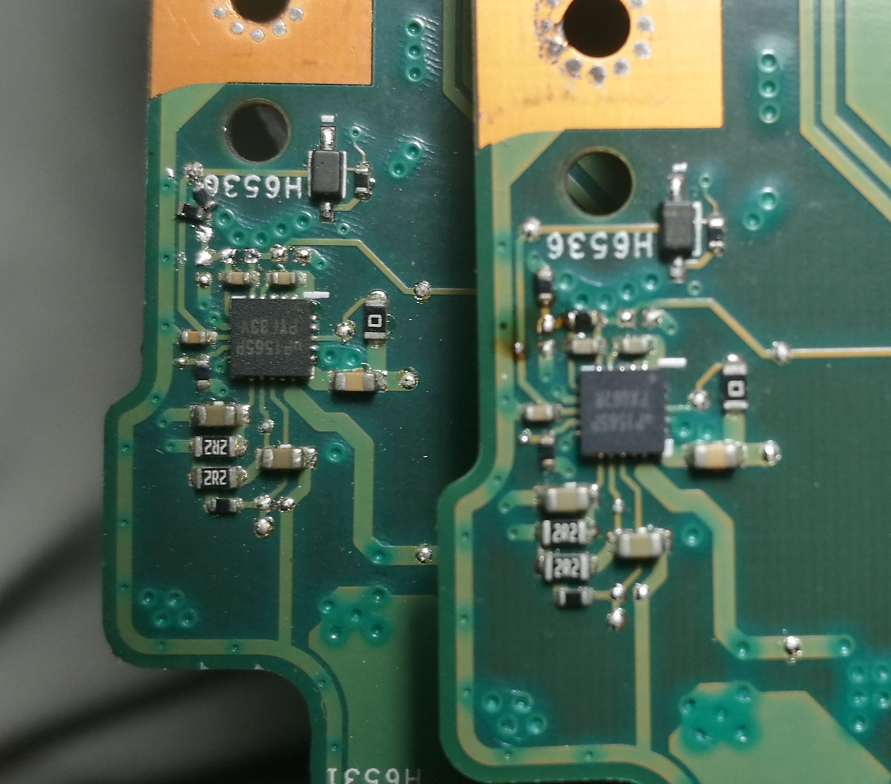

    Asus X550VX nvidia error 43, before replacing the graphics chip, having an identical card, I try to replace the vram. The voltage of the vram on the card is 1.35V but while this card uses Elpida W4032BABG VDD = VDDQ = 1.6V / 1.55V / 1.5V ± 3% and 1.35V ± 3% the donor card uses samsung 4KG41325FC-HC03 K memories : POD_18 (1.8V, 1.8V)
    How is it possible

    The ninth character is an F so its F:POD_15 (1.5V,1.5V)

      thanks but not 1.35 (dual voltage as elpida) ?
      The dc/dc is a up1565p , which provides two (fixed ?) voltages, 1.5v and 1.8 so what I didn't understand about 1.35v ?

        Is the donor board the same revision,what part numbers on both are at PU9301

          It's very strange, both use up1565p not in fixed mode (pin 6 is not to GND) , resistor divider is 10k (pr9312) and 11.8 k (pr9313)

            The The up1565p is adjustable as well. In the X550VX boardview pin 6 is connected to a resistor divider
            https://pdf1.alldatasheet.com/datash...P1565PQKF.html

              vram voltage = 0.75(1+(11.8/10)) = 0.75(2.18) = 1.635 v
              With these resistors value, the output should be around 1.5V
              but the boardview (version ?) and my reading is 1.35 v , on the asus site I see a model upgrade (x550vxk).
              probably there is something that I do not understand but since the cards are identical also for revision I change the vram elpida with the samsung

                what are the resistor values on the donor board

                  it's the same 10k and 12k with these values and using the formula on datasheet the result should be around 1.5v and not 1.35
