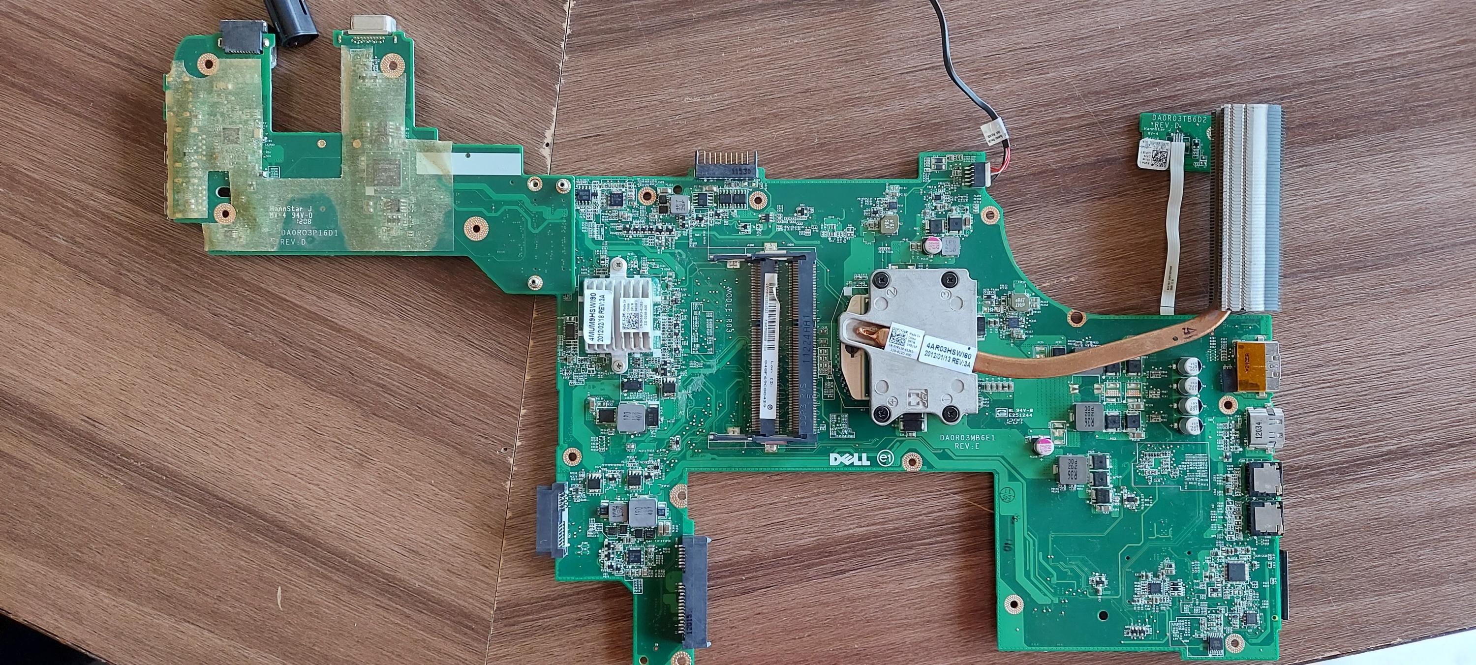

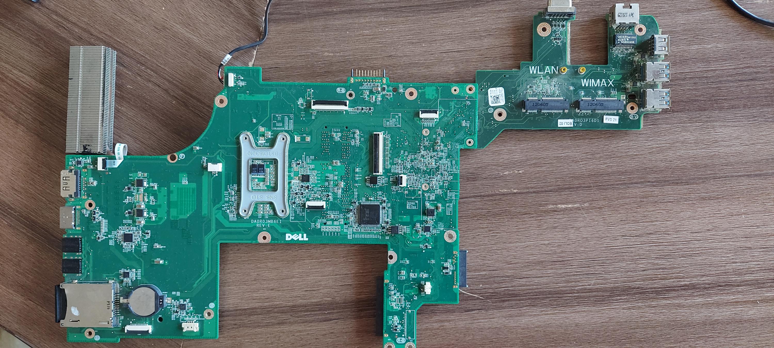

        Re: Dell 7110 No display
        this is the board pics

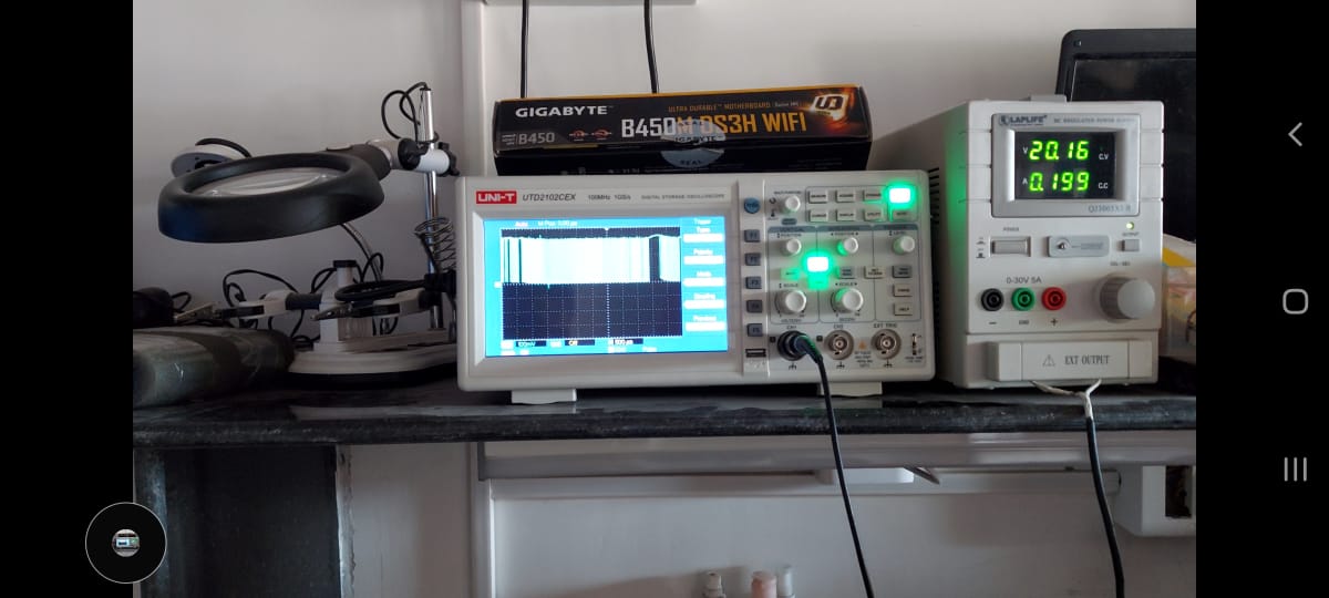

                No External Output , 2 beep at start up( may be indicating RAM) , Checked with different ram, same result , On Ram slot pin no 199 - 3.3V Run Ok, pin 30- DRMRST -1.64V, Pin 203,204DDR VTT -.76V ok, Pin 1 VREF -.88V ok, but i notice that at the powering on the bios data is appear only for less than a second which is abnormal
