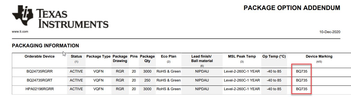

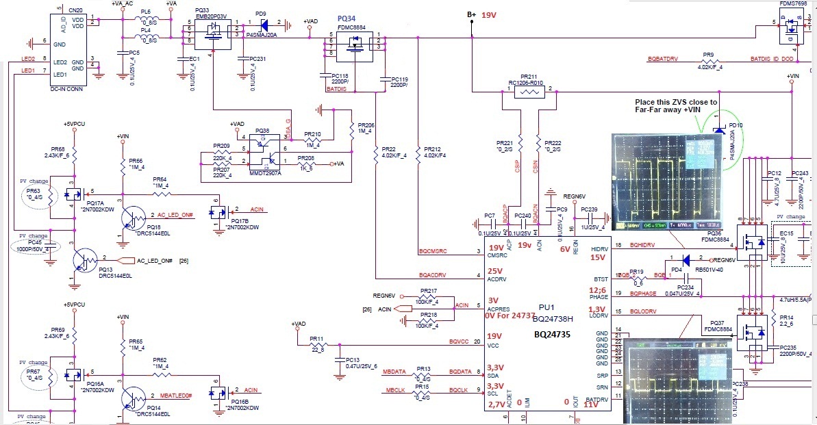

                    https://www.elvikom.pl/lenovo-yoga-1...ad-t53251.html
                    Monitor my post from a few minutes ago:
                    https://e2e.ti.com/support/power-man...is-the-bq24735
                    So this is interesting:
                    (from)
                    https://e2e.ti.com/support/power-man.../956290/bq735f
                    see markings information - attached.
                    Respectively, full datasheets for the BQ24735 are posted on the TI website.

                          • mon2
                            • Dec 2019
                            • 14663
                            Re: lenovo yoga 13 2191 no turning on
                            BQ735 are the markings of the BQ24735 charger IC.
                            Please see attached.
