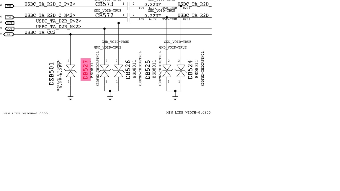

                            1) the datasheets for the ESD diodes for the USB protection used on this logic board is attached. Wonder why Apple made these parts so large ?
                            If you are comfortable to do this, you could temporarily remove the 2-4 diodes on this USB interconnect and see if the readings improve. If they do not, then the diodes are not the issue. Keep in mind, 2 diodes for each D+/D- pair. Then another 2 diodes for the opposite side of the C connector blade. Then zeners for the CCx line protection (top and then again bottom of the blade).
                            You should be able to pickup the ONSEMI ESD parts from main stream distributors like Arrow or similar.
                            https://www.arrow.com/en/products/es...-semiconductor
                            Do review the full ESD diode network for the TOP side of the USB C connector and also the BOTTOM side of the USB C connector blade. That is, if you see any discoloration or suspect these parts as an issue, they should be replaced. The ESD components are sacrificial and they 'took one for the team' and are no longer good to use if they have been hit with a hard transient. Perhaps you can inspect each with your microscope.
                            Apple is using some zeners to protect the CCx lines but are 0201 parts - more joy !!!
                            I would buy 100 or more as they are so tiny and easy to lose.
                            2) technically, these ESD diodes are not required for immediate testing. there is a small possibility that the ESD diode is damaged and causing the readings you are observing. However, many internet articles and posts (including this forum) report that the actual CD3215 is the component that needs to be replaced. These controllers are common to Asia and any shop with macbook repair parts. The guy with the ponytail in Germany should have them but perhaps you can just order from Aliexpress as well.
                            You may be able to get lucky to buy a donor logic board off Ebay but the pricing will vary. Then you will have to remove and reball the pulled part before it can be applied here. Personally found the stencils to be not fun to use and only recently purchase a DIRECT heat stencil. Not tested yet. Our fully automatic BGA rework station should arrive by the end of this week. Has vision, etc. which will help our fading eyesight.
                            So your grocery list now includes:
                            a) ONSEMI ESD8011 (as per attached datasheet) - 100+
                            b) the zeners used by Apple on the same connector (0201 footprint) - 50+
                            c) CD3215 ACE Controller - be sure to buy the same one that is on your logic board - best if 100% new so the balls are fresh.

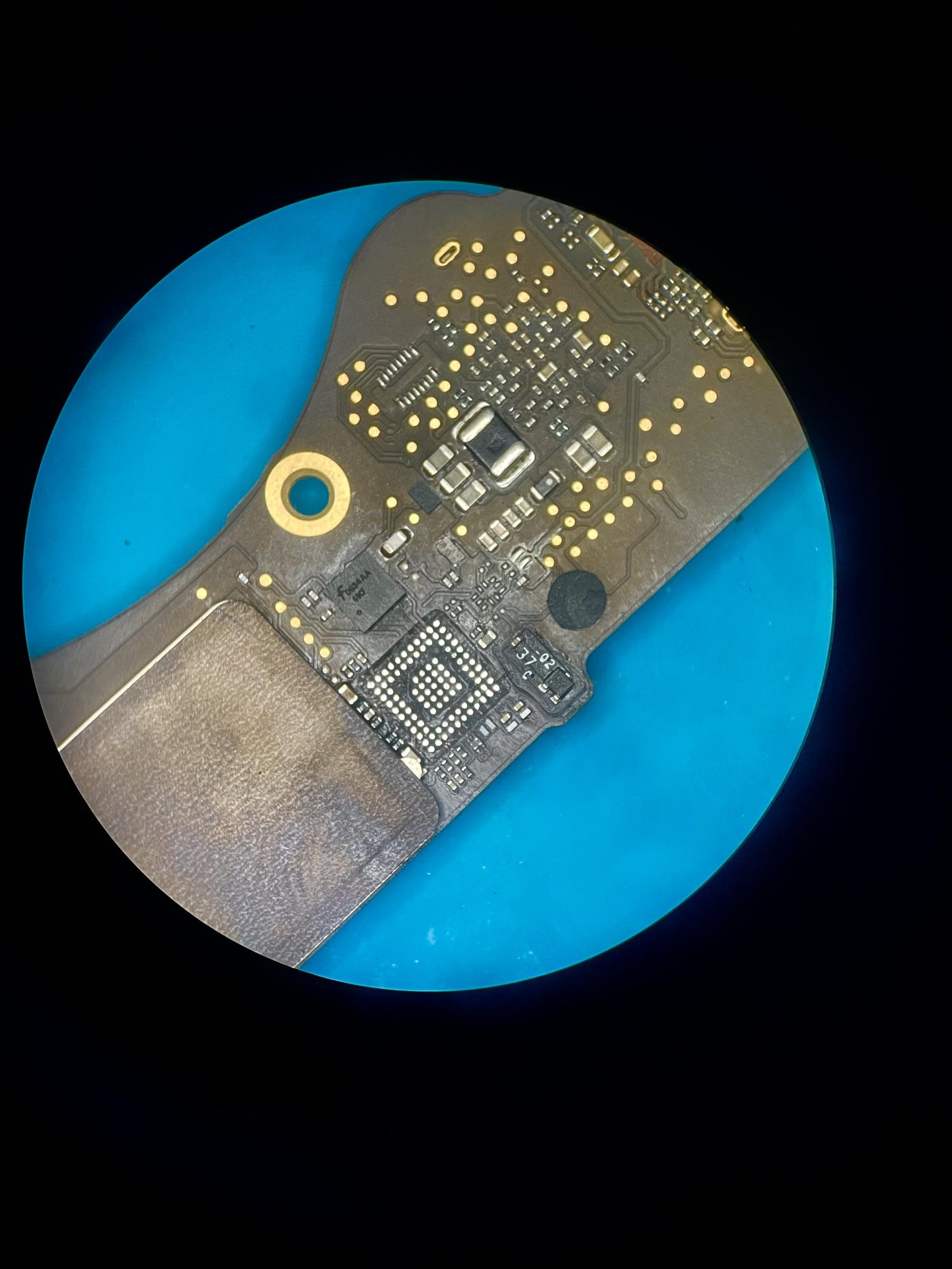

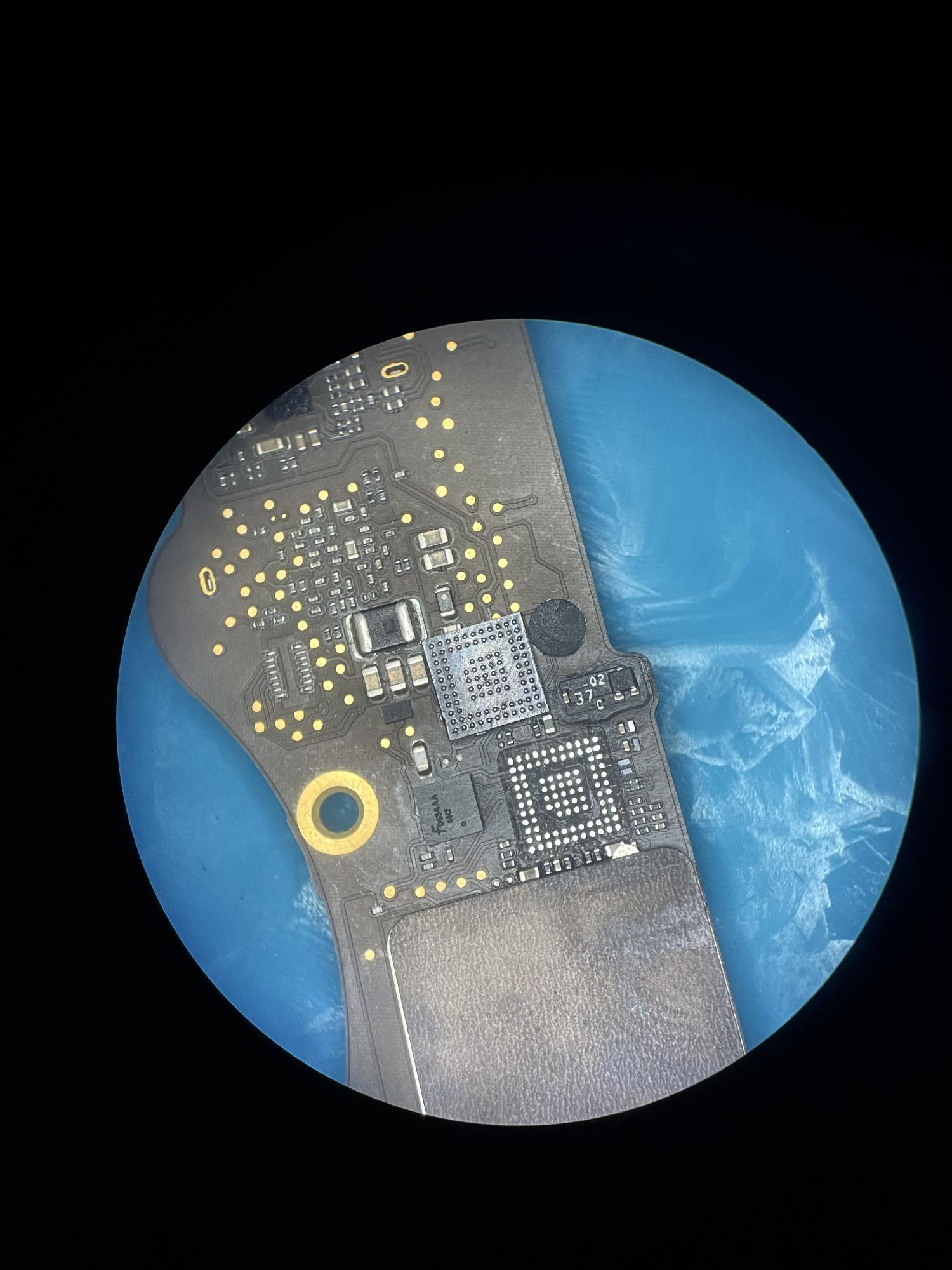

                              Thanks for the complete info. I will check under my microscope tomorrow all those diodes to see if I see anything bad. I would prefer to order a donor board and reball the cds, I'm familiar with this, I just reballed an iPhone 7 Intel baseband today which I guess would be almoust same difficult as cd. I read many saying that asian sourced chip might be fake and I don't want to lose so much time waiting for something which will not work. I will need a stencil for those though. I will then order those diodes (both zeners and esd), they might be always usefull with those boards. I will hit you back tomorrow with some news and probably a question about what to remove to understand which pair are on the opposite side of the blade.
                              I just had a look at this CD stencil and it looks way easier than an iPhone 7 baseband
                              • fozzo
                                • Jul 2020
                                • 49
                                • Italy
                                Re: Macbook pro touchbar 820-00239
                                Hello again. I checked diodes and I don't see anything strange here then i checked zener diode and it looked ugly, kinda broken. By luck iphone 7 plus has the same diode so i changed it but it made no difference. I'd like to give a shot without either diodes and zener diodes which you told me yesterday just to see if it makes any difference. You told me to remove 4 diodes and its zener protector, i think you meant the four in the picture. Am I wrong? The highlighed one is the one with low measurement.

                                    Hello again, finally I received parts. I changed all in one the two zener diodes., two Onsemi ESD8011 diodes and two relative cap, as well as CD3215 ACE Controller but after changing all of the USBC_TA_D2R_N<2> was still at .113. I pluged charger and ampmeter and it went straight to 20v, reassembled the machine and I got a nice red battery and after a while a nice chime and apple logo and home screen. I don’t know what was actually the culprit, I preferred to do all in one to save lot of heat to the motherboard. Still need to test all but it seems the major problem have been solved. By the way CD3215 i Used is a reballed one taken from original motherboard, here are pictures

                                        Actually I changed
                                        DZB501, CB314, UB300 and DB527
