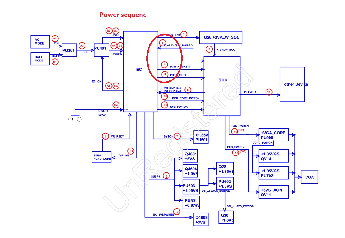

    Q4601 = 5Vs present
    Q4602 = 3Vs present
    Q 26 =+3Valw soc present
    Q 28 = 1.35vs present
    Q 30 = 1.8vs present
    Bios pin 8 = 1.8v
    PLTRST= 3v
    Sys on/ SUSP / VRON / SYSPWOL = 3v

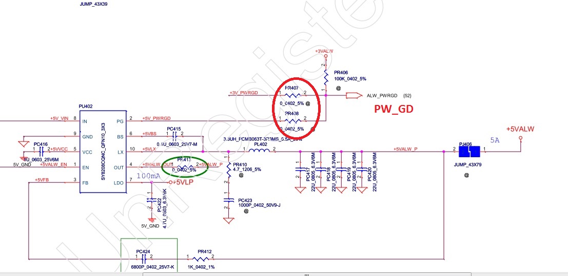

    Try another bios still the same ,so i try to measure powergood signal of each and every pwm as suggested here :
    https://www.badcaps.net/forum/showthread.php?t=88408
    Pu 501 = pin 20 = 3.35v
    Pu 602 = pin 7 = 3.36v
    Pu 701 = pin 7 = 3.36v
    and i find my pb here :

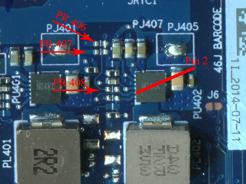

    Pu 401 = pin 2 = not stable
    Pu 402 = pin 2 = not stable (7v ....10v.. 1.2v..0.300v..0.500v..)
    As mcplslg say = PIN2 POWERGOOD should be 3V ...but i didn't find this voltage .
    Pr 406/407/408 are not populated
    What shoul i measure /change !!

    PU402 PG signal is drawn from +3V PG, so problem is likely in PU401. Unless PU401 pin2 PG is stable you wont get proper voltage at PU402 PG pin. Now you can try replacing PU401 first or cut the pu402 pin2 track to isolate pin2 of PU401 and see if you get PG signal on PU401 IC.Dramrst# is generated directly by SOC and no other component is involved. So could be SOC Fault as well.

          Thank you sametbey for your help , the issue is already fixed with changing Pu402...
          As i mention before , the 5valw is present ,i didn't measure 5VL since i find my 5Valw , so for me this circuit is OK...
          the only thisg i measure is PG ( not stable ) and must find 3v ..but even when i change PU402 still not find 3v at pin 2 !!..but the lap work !..that's my confudion!

              PU401 pg = 0.542v..just takeoff the prob and try again = 0.620v

                If there is 3.3VALW and 5VALW and the problem is the PW_GD signal, you can check it by canceling the PR407 and PR408 resistors to try. maybe IO can be problematic.

                  PR 406/407/408 doesn't exist at the motherboard

                    Are you stuck in step 3? You should now check the 87 pin of the IO ITE8586 chip. need 3v. if not, you can proceed with the other steps.

                      There is no problem with the PU402. If there is 3V at ITE8586 87 pin, PW_GD is OK. you have to look at the other steps. Like Q26, + 3VALW_SOC. It may be a bios and IO problem.

                          @lapfix, Sorry for misleading you on PG output voltage level on PU401/402. I beleived it should be stable 3V but that doesnt seems to be the case here. So confusing it can be..PG pull up is +3VALW and still 0.5-0.6 is the output on PG. I didnt expected that and hence the error in guidance. My sincere apologies.
