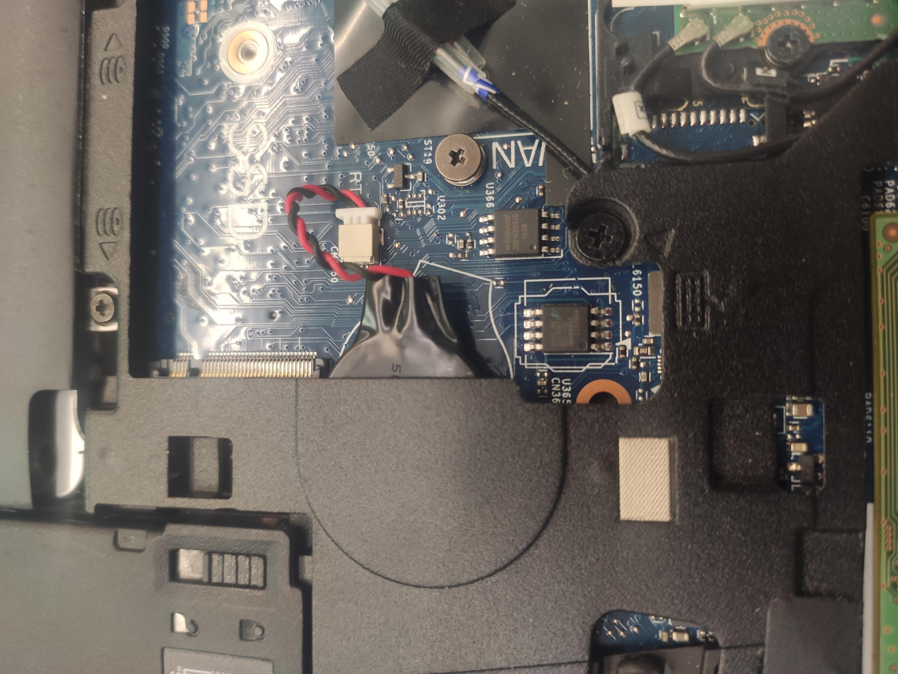

    EliteBook 840 NO POWER ON
    with non original charger i get blinking led continuous
    with hp genuine i get on and instantly off , you can see on this video :
    https://www.youtube.com/watch?v=wEs4sAukKZ4
    also there are 2 flash on the board , wich one are the bios ic ?

    Re: EliteBook 840 NO POWER ON
    The windbond is usually a bios IC, can't make out the second one.

      Re: EliteBook 840 g2 NO POWER ON bios req
      u365 is mx25l12873
      u366 is 26q16dvsig
      from schematics i see u365 is bios and u366 EC
      Uploaded my original dump
