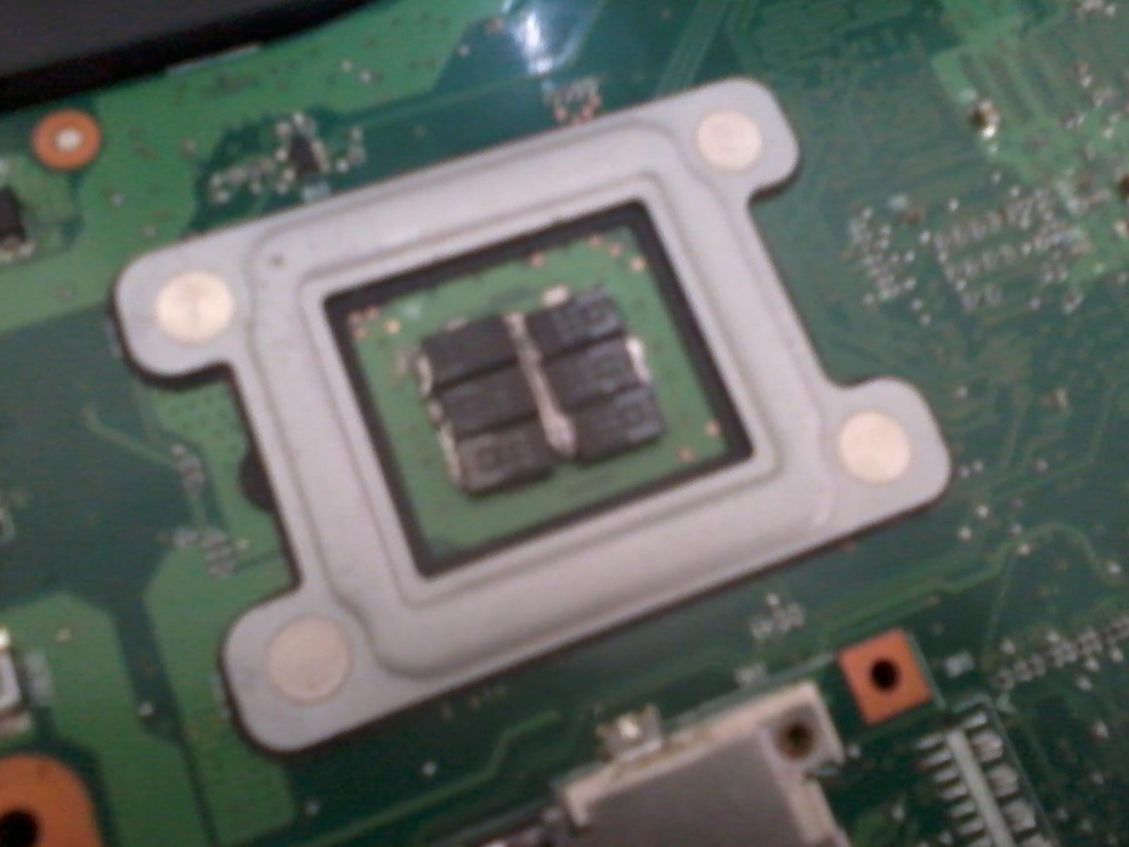

          #444
          Re: Toshiba Satellite - Locks up when plugged in
          Originally posted by ryogadan
          Hello to all.
          I followed the instructions of the post with excellent results (no more artefacts), but the notebook still shut down occasionally.
          Best regard,
          Daniele
          I had same issue as yours, after replacing with 6 cap of 330 value. So I added 2 more cap of 330 and problem disappear so had total of 8 cap. Good luck !

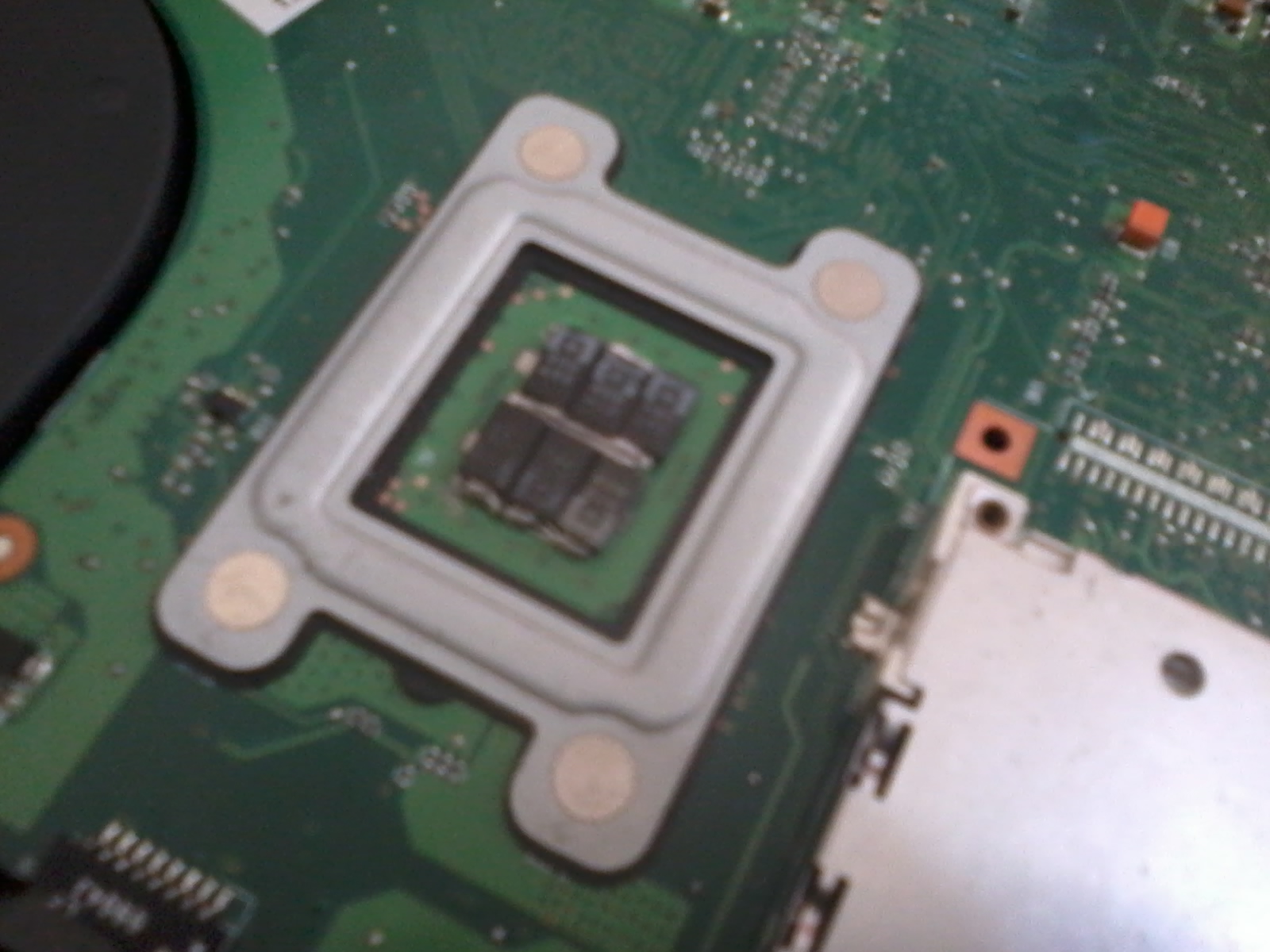

              gud day to all! Just found this site looking for some answers regarding my laptop its a toshiba satellite L355-s7900. It powers on then off, keeps on going like that. I took it apart and found that there's also a nec tokin 0E907 under the cpu socket.
              I did try to follow some guides here to see if its going to work. I measured the cpu voltage and found out that its fluctuating from zero to .9 voltz and it doesn't stay on that. It gives random voltage reading.
              I removed the tokin successfully and replace them with a different capacitor but it still won't give any display but the good thing is that its not turning off anymore, it stays on and the voltage stays on .9 voltz. I may have missed some steps here coz I've read that my processor needs to be on 1.070 to 1.175 voltz. .9 is low i think. Maybe I used the wrong capacitor. It says 330 e53 I don't know if its the right one, any advice will do thanks a lot!

                #447
                Did you use just one capacitor? As others stated in the thread, you should use at least 3x 330uF capacitors! 0.9v does seem low.

                  #448
                  yes I used 4 caps same as the images shown. by the way I forgot to mention that one of the capacitor I placed is labeled 330 e58 instead of e53, does it have any effect on that? if the laptop stays ON using adapter does that mean I' m on the right track? tnx again for the help!

                    #449
                    read Post #444 of this thread
                    a few members added more than 4caps to make it work

                      #450
                      ok ill try this later and keep you guys posted. tnx again

                        #451
                        i did one of these a while back and used 6 470@2.5v sm polys.
                        it worked with 4 but ripple was high.adding 2 more did the trick.
                        like desktop boards esr is most important.esp with the limited space.

                            #453
                            You know what guys.... You're all AWESOMELY GRATE!!! I fixed my laptop with no display just now using 6x 330uf e53 2.5v capacitor. It really did a great job after replacing that tokin.
                            To everyone...Thank you very much!
                            And also a big thanks to badcaps.net! cheers!
                            Sorry its a bit blurry, just used my old cellphone for this
