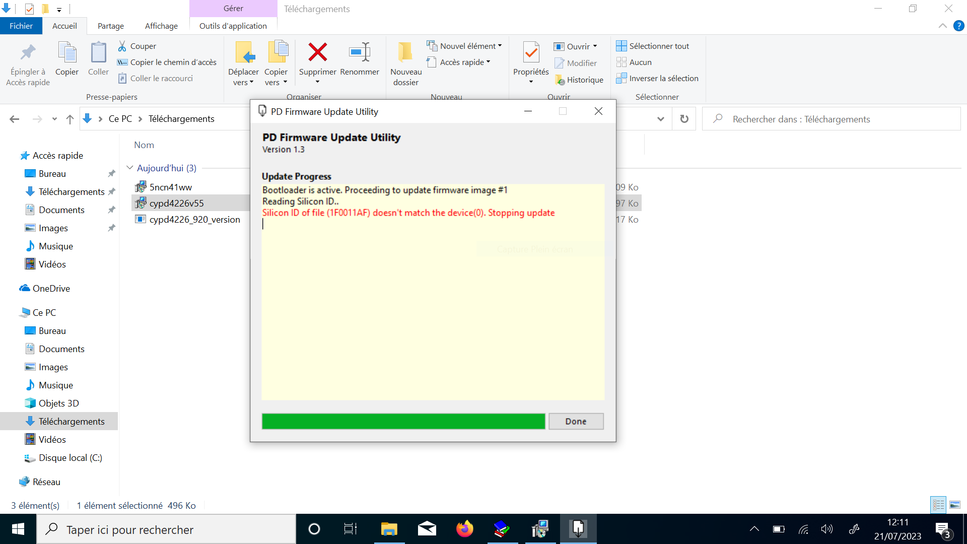

      Hi everyone!
      I have a lenovo yoga 930 that the cypd4226 usb type C controller was i short circuit . So i order a new one and replace and a try the method explain in this post but have an error . So someone with any guide to solve the problem?
      Below I attach an image for the error .
      Thanks!

        #43
        Re: Lenovo yoga c930 NM-B741 Doesn't boot or charge USB type-C controller issue.
        See if this old thread helps where I posted a similar question.
        https://community.infineon.com/t5/US...30/td-p/272947

          #44
          Hi !
          The post on this link don't help

            #45
            Same thing here. Replaced cypd4226. Original USB-PD charger does not detects, used regular 5v 3a NON USB-PD charger. Succesflully charged it above 60% and flashed CYPD4226 firmware.

              #46
              Thanks @Udavf. Was the flashing process in-circuit using the bios tools from Lenovo?

                #47
                yes

                              Hi everyone!
                              Thanks!
                              Hello, were you able to solve the problem, I have a Lenovo C930 laptop with the same problem, I replaced the cypd4226 chip because it was also short circuited, I tried to install firmware like you did, but it gives me the same error, my question is, did you manage to repair that computer, And if so, could you tell me how to repair it, thank you.
                              Greetings.

                                  Hi guys! I have a C930 with the same problem.. How do you flash the CYPD4226? With new battery i can run into Windows... But im affraid to put the 920 firmware. Exe.. I read confused things about it. I flash the firmware of 920 and make the jumper? I read also that we need the 19V for make the bios update the firmware of the Cypd4226...
                                    Hi everyone!
                                    Thanks!
                                    I have the same problem.... Any idea?? Thanks!!
                                        Yes i solved the problem
                                        order new ic and replace
                                        download the pd controler program from lenovo website
                                        Make sure that your battery is charge
                                        connect a 5V 3A usb -C chargeur and run the program
                                        • tesnic
                                          Thanks for you comment. But i try with two different new ICs and when i run the controller program, always have the same error: "Sillicon ID (1F0011AF) of file doen''t match the device"... Y try it with 100% of battery and 5V 3A connected with the 3v wire into pin 9 of u38/u227 to detect charger..... Any idea??? thanks!
