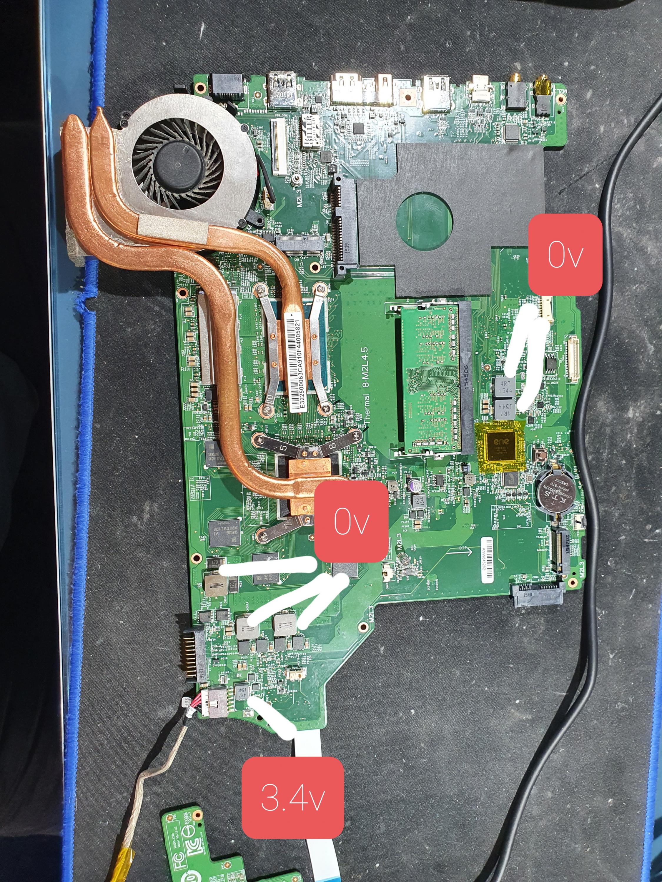

    Hello Everyone,
    Here I am again with another request of help form more skilled people.
    Have this MSI GP72 6QE Leopard Pro.
    Motherboard: MS-16J51 ver 1.0
    Power button flashes when pressed for a fraction of a second and nothing happens.
    Measured voltages and all look to be fine. It just wont start.
    Would someone be able to help me with it?
    PS: it does charge the battery
    Already did a BIOS reprogram with one found on the internet (only one that was for free) and still nothing.
    Your help would be highly appreciated.

      Post voltage measurements on all large grey coils and post a link to the schematic or post it here if you have it.

            Here are some voltages....
            • Rhadu23
              • Mar 2021
              • 74
              • United Kingdom
              Re: MSI GP72 6QE Leopard Pro
              does the picture helps in any way?

                    need more information. what i know is, that the kbc-chip is going bad frequently on these machines...

                        its the 128-pin qfn chip from ene . the big multicontroller with kapton tape on top (yellow tape)

                              Page 1 of the schematic lists all the major IC`s. KBC KB9028C (page 28).
                              Yes it does need programming.You might be able to buy a pre programmed chip on ebay.If you are going to keep working on laptop repairs then a KBC/IO programmer is a must have tool so that you can program them yourself.
                              I recommend the vertyanov jig, other programmers are SVOD 3 (also programs SPI) ,SAS ioprogrammer (vertyanov clone).

                                KB9028Q C
                                NF511864
                                GCA150908
                                them 3 lines are written on the chip

                                  Don`t assume its the EC thats dead unless youve checked the working voltages. Have you checked PQ4 ,PQ5 mosfets ?

                                      PQ4 has 19.5v on all pins but pin4. On pin 4 has 8.2v
                                      PQ5 has 19.5v on all pins but pin4. On pin 4 has 9.6v

                                        check the voltage on +3VALW,+5VALW,SRTCRST# ,RTCRST# .Does the power button go 3.3V - 0V - 3.3V when you press it
