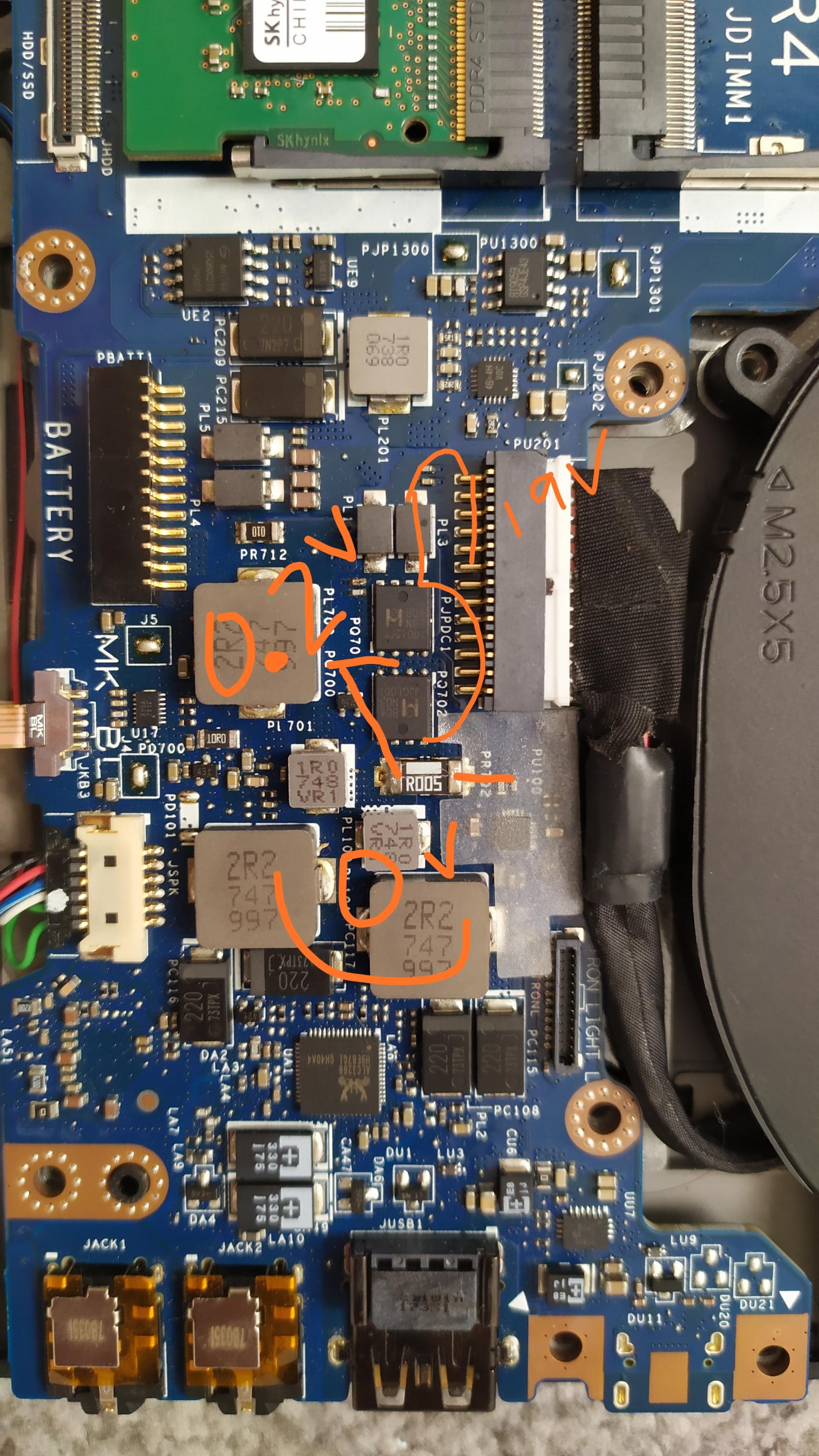

                              I have probed all inductors on both the good and bad motherboard without battery installed and all voltages are similar.
                              Installed battery and pl700 is getting 19v one side and 6v on the other on the bad board. On the good board 15.6v both sides.
                              Probed around BQ24780 and found pin 4 had 24v and should be 19v
                              Checked the resistor pr708 and is ok at 4.12k
                              Checked mosfet pq701, pq702, pq707 and pq708 all have 19.6v d, 19.6v s and 24v g.
                              Hope this makes some sense, I am new to all this.
                              Thanks for all the help so far

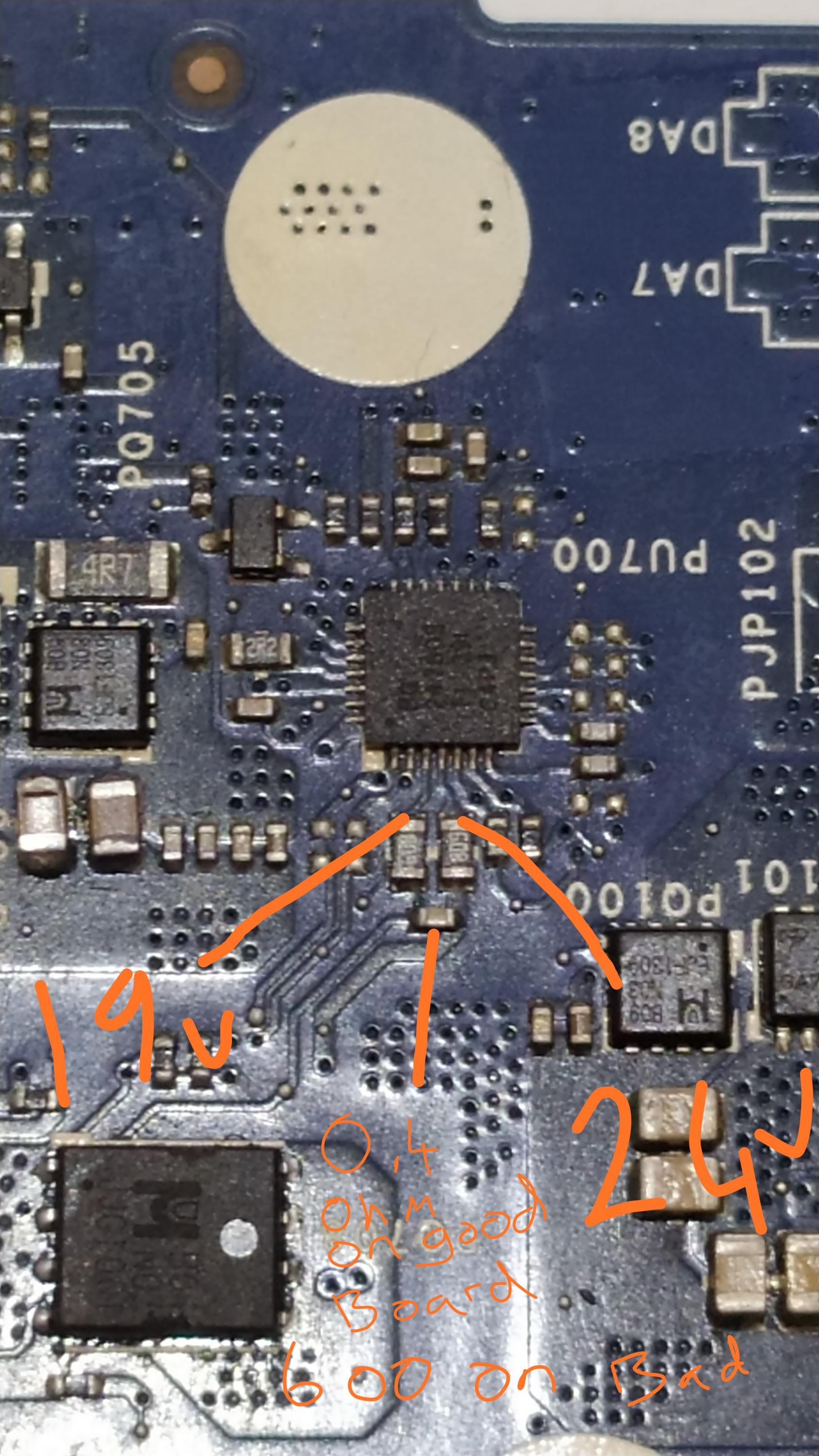

                                Attached is a photo of the area with BQ24780
                                The two resistors should have 19v going to the capacitor above that has 0.4 ohms across, they then go onto the MOSFETs supplying 19v to the gate (I am guessing this is how it works - this is the voltage on the good motherboard)
                                On the bad motherboard one of the resistors has 24v going to the capacitor and it has 600 ohms across - one side has 19v the other 24v. 24v is then going to the gate on the mosfet
