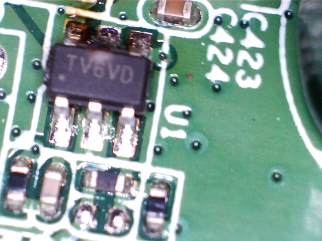

            Re: Unknown Component
            Hi.
            Could somebody help me to identify component with marking code TV6VD?
            I am pretty sure that this is step down converter and has 6 pin SOT23 package.
            Input voltage is 19V.
            Thanks.
              • 21853
              Originally posted by Bobo1634
              Hi.
              Thanks.
              Post some good clear pictures .
              • Bobo1634
                • May 2017
                • 4
                • Croatia
                It's here.
